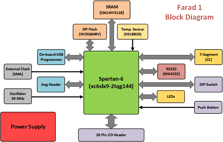

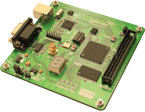

hello dear friends
i want to build a mesa card with my custom spartan board i have rpi4 with latest linuxcnc image unfortunatly i can not afford the official mesa board
my custom board does not have any ADC and anything just Sram and spi flash and a programmer
i just want to have a 3 axis with spindle and 10 io . trying to build a closed loop system.
i have 7c81 hostmot firmware i know vhdl but source is too complicated
please help me to compile firmware and connect my custom board to rpi
and tailor other section of source that i did not need those module
3 axis + spindle closeloop with stepgen or pwm and 10 IO just these options .
i am trying to set UCF file
in forum PCW said that you need configure PINxx file but i can not understand the instruction
please help me
my best regards

Yes, you would need to make a UCF file, card file and pinout file for that hardware
Does it really only have 20 I/O pins? That's would be a bit tight for 3 axis:
3 Axis step/dir = 6
SPI interface =4
PWM = 1 to 3 (2,3 if you have enable or direction)
Spindle encoder = 3 (if needed)
3 Axis step/dir = 6
SPI interface =4

You really only need to worry about getting the 3 files to match your hardware.
You normally don't deal with anything at the module level unless you need to change a module.
Note that the SPI interface requires using a GCLK pin for the SPI clock
so make sure you chose a GCLK capable pin for the SPI clock in the UCF file.
The 3 files are created by starting with existing ones and modifying them
to suit your hardware. The card files all end with "card.vhd".
For example the 7C81 card file is c81x9card.vhd.
The pin files all start with "PIN"
