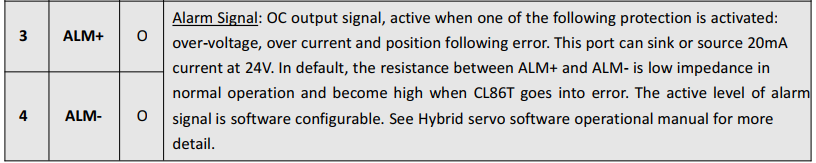

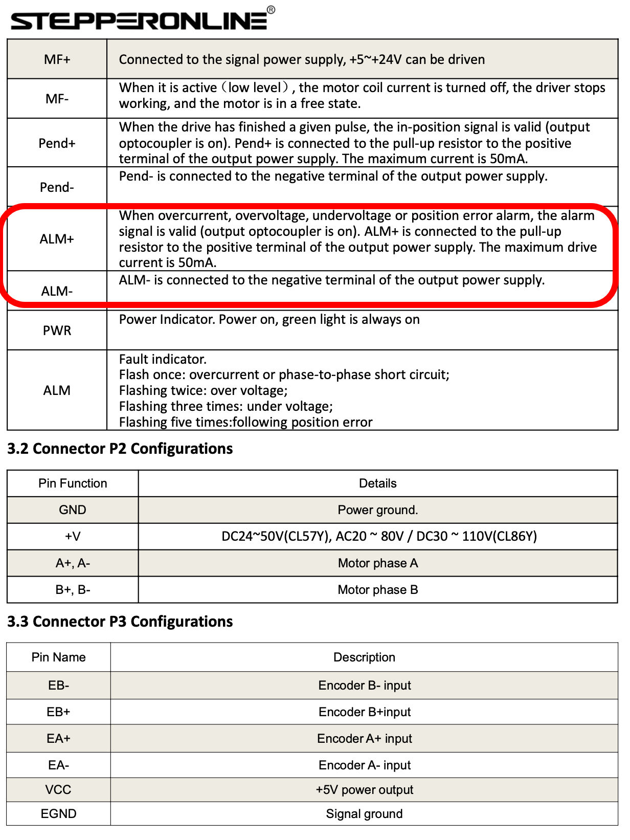

I'm connecting a Stepper Online CL86Y Closed loop stepper driver that has both alarm (as expected) and a weird terminal called "Pending". As well as another terminal for Motor Free (I guess that's another term for "Disable"?). I have attached screen shots of the relevant pages of my driver manual for reference.
So I have a few questions:
Re: Pending terminal

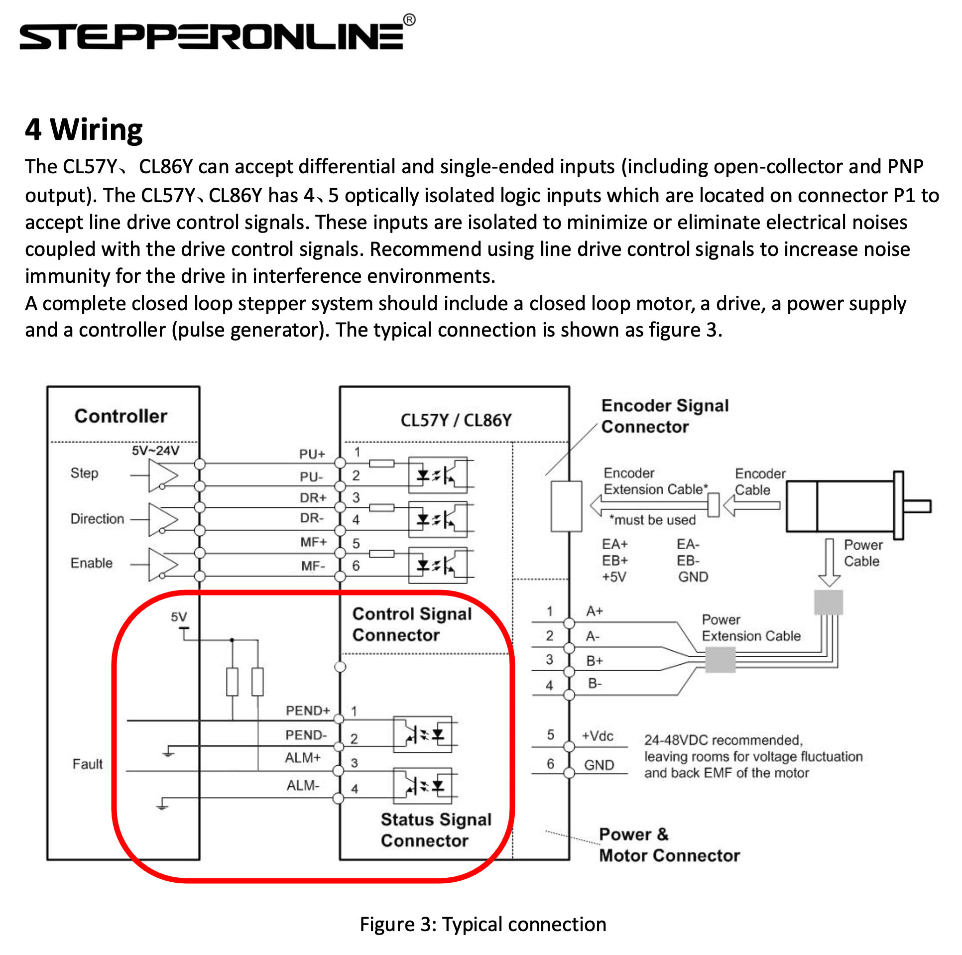

Has anyone used this? Is this some secondary (inversed) confirmation of the Alarm? I'm not planning to use it at this stage, but the terminal intrigues me... and how on Earth would you configure LinuxCNC to use this meaningfully... if at all?
Re: The Alarm Circuit

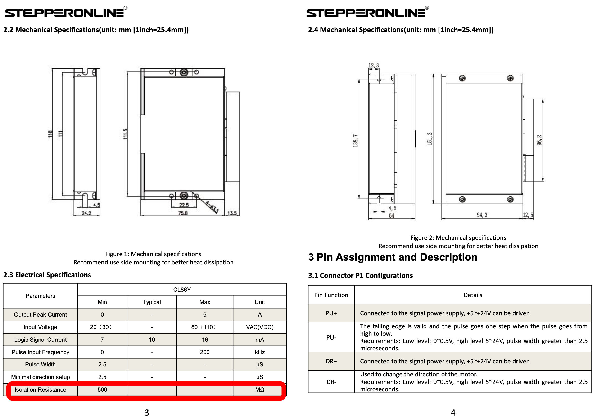

Now from what I've read, the closed loop stepper driver has a 500M ohm resistance on the opto-isolator.... the wiring diagram has "unspecified resistors" assuming a 5V field IO... but the Mesa 7i76E.. as described above, is running at 24V. I presume the light dependent resistor in the opto-isolator can handle the higher voltage?
I just want to run the 24V+ to the driver, and run the V- from the driver to a digital input on the Mesa Card. However, in a nagging self-doubting moment, I'm not sure if I have to bring that down to a lower voltage for the driver, then bring it back up again for the Mesa card... as it would expect the 24V signal.
How have others CL86Y owners done this? Any of you out there?

Alarm and Pending can be used with 24V, just need a bigger resistance, roughly 5 times bigger. Can also be wired differently, but am no good at explaining so i'll skip.
Pending is usually not used (can not think of any use right now), it is also called "in position" and can also be used as "drive ready".

Pending: Tommy's right. That's an 'on-position' signal, don't bother with it.
The unspecified resistors in the diagram are pull-ups, and they're assuming you've got a 5v power supply - it's just drawn badly showing either sourcing or sinking. The optos will handle 24v fine. I've attached the function description from the CL86T version and it's much more clear. The diagram is the same for both drives (Y and T series).
Alarm: Run 24v from VFIELD to the ALM+, and ALM- to the input of your choice. You may have to flip the signal from high to low in LCNC as I don't trust the drive manual on the default setting. It should be active high ("high impedance") in the alarm (24V to 7i76e for no-alarm state, 0V for alarm), but you never know. This way a broken wire, buggered terminal, drive power failure or whatever will cause an alarm.
Bonus 1: if you want to save inputs, you can do it one of two ways:
- 24v from VFIELD to ALM+ on all drives. ALM- on all drives to a single input. If any one drive faults, the 7i76e input will see 24V (you decide what you want ot have happen at that point). This requires changing the alarm signal in the drives. Not recommended as a drive power interruption will NOT register as a signal on the 7i76e.
- OR
- 24v from VFIELD to ALM+ on drive 1, ALM- to ALM+ on next drive, and so forth daisy-chaining through the drives and terminating at 7i76e single input. Drive fault will interrupt the daisy-chained 24v signal. Again, you decide what you want to have happen

#---Super-cool drive alarm test stuff--- (this is a comment)
net random-signal-name0 7i76gibberish.0.input-05 [Mesa pin to a signal]
net random-signal-name0 joint.0.amp-fault-in [same signal to a HAL pin that might stop all motion]
net random-signal-name1 7i76gibberish.0.input-06 [Mesa pin to a signal]
net random-signal-name1 joint.1.amp-fault-in [same signal to a HAL pin that might stop all motion]
lather rinse repeat.
I'm going to stop here, because I've probably made some gross errors and need one of the smart people to add their two cents.
But, fundamentally... you decide what you want to have happen in software and meat-space, then bend LCNC to your will. Not the other way 'round.
-R
-R
