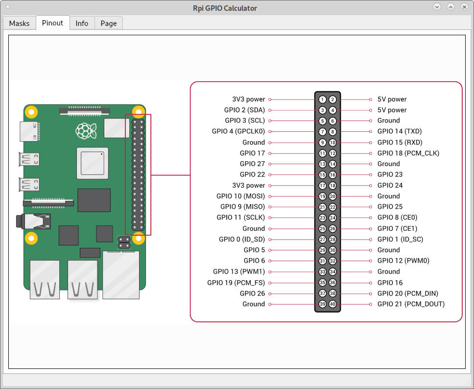

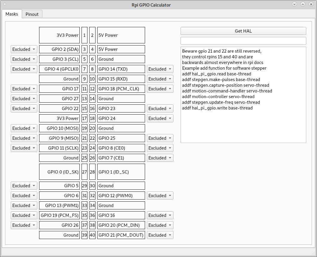

After a guy on the IRC pointed me to a thread about a Hal driver for Rpi GPIO I went looking for the man page but there is none. Andy pointed me to an example and the masks used seemed very confusing to figure out so I made a configuration tool for the hal_pi_gpio driver. Still need to polish it up and see about adding it to 2.8 maybe. Going to add the pinout map on a tab and make the man page.

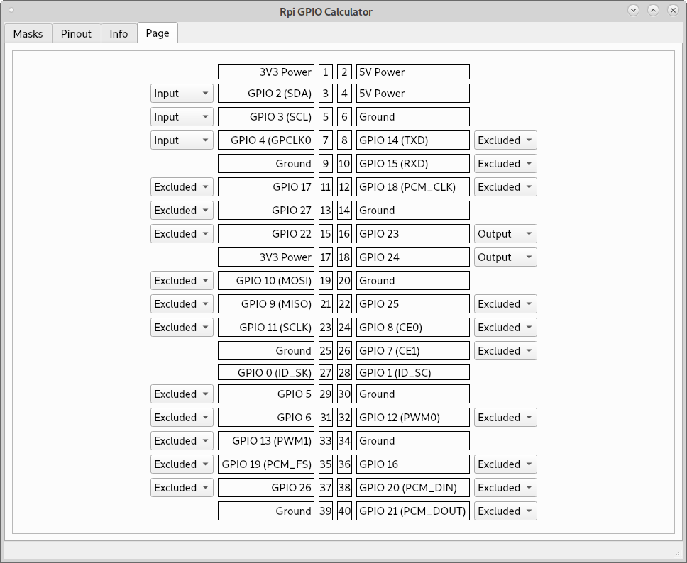

Maybe configure the layout to mirror the pinout with the fixed pins (5V, 3.3V etc) included (but not editable)
A drop down of IN / OUT / EXC might be easier to follow too, rather than having to keep two controls synched. (or 0, 1, 2 if drop-down is harder.)

Replied by BigJohnT on topic Rpi 4 GPIO Calculator
That's a very good idea, I'll see what I can do during coffee time in the AM. At least I got the math sorted out so making it pretty is easy. A combo box might be an idea I'll look at that and 0, 1, 2 spin box.
