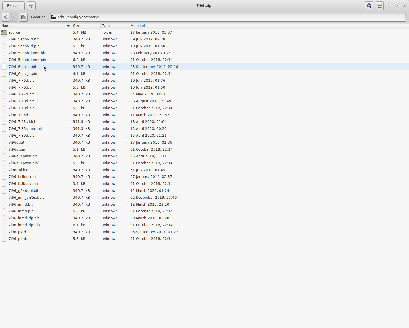

I have been using a 7i96 with a Chinese BOB on the P1 connector. @PCW supplied me with a .bit file so I could flash the card and use the pwm on the BOB. This all worked great for a few years.
Now I have the need for more I/O and ordered a 7i75 card.
I am looking for a bitfile that will work with the 7i96 and 7i75 cards (I will discard the BOB), but I can not seem to find any. Or is the standard plain 7i96.bit the solution?

The plain 7i96d bitfile should work if all you need is GPIO
