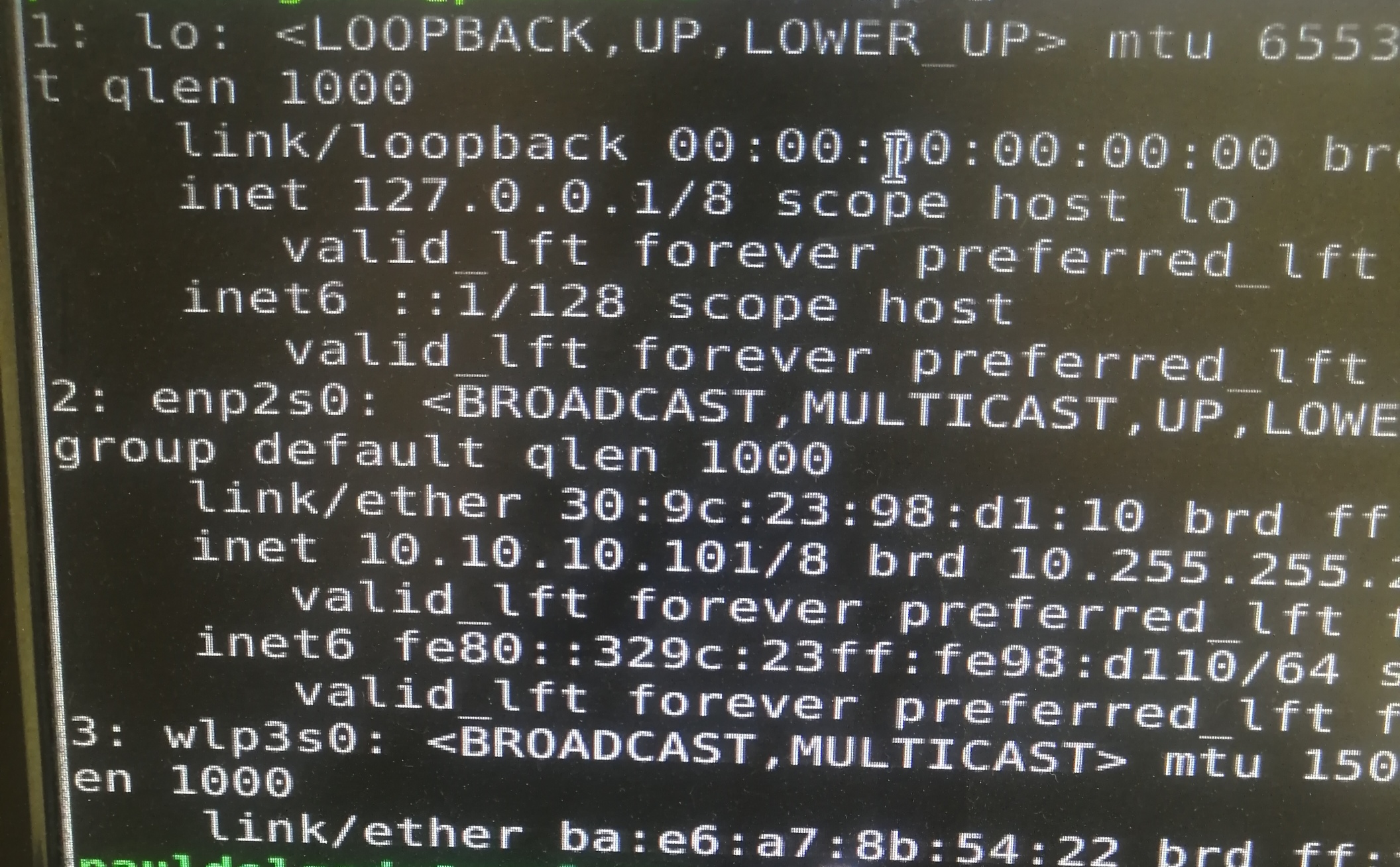

Greetings to all.

What does the command:
ip a
report?

Mesaflash requires the IP address of the card for ethernet boards, most probably 10.10.10.10

Yes, forgot that, if the FPGA card address is not the default 192.168.1.121, you must
supply the address on the mesaflash command line:
mesaflash --device 7i96 --addr 10.10.10.10 --readhmid

Thanks for your help, was that the problem.
