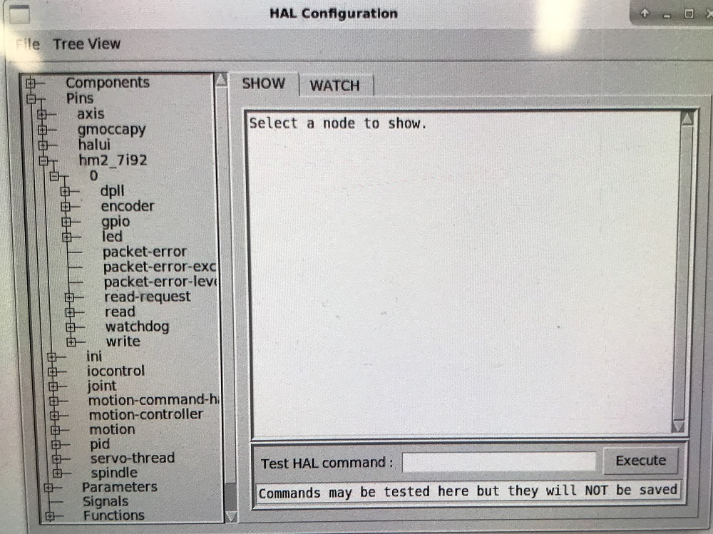

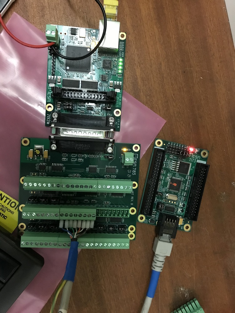

Hi Peter,
I have the 7i85sx2d bitfile loaded in my 7i92, and the 7i85 connected. When I connect a 7i73 to SSerial 0, and start the system with ...
loadrt hostmot2
loadrt hm2_eth board_ip="10.10.10.10" config=" num_encoders=5 num_pwmgens=1 num_stepgens=2 sserial_port_0=0000xx"
setp hm2_7i92.0.watchdog.timeout_ns 5000000
addf hm2_7i92.0.read servo-thread
addf hm2_7i92.0.write servo-thread
setp hm2_7i92.0.dpll.01.timer-us -50
...LinuxCNC starts up fine, without errors, or messages.
Halshow does not return any 7i73 pins, and and the red watchdog LED of the 7i73 just glares at me. I suspect that the syntax of sserial_port_0=0000xx is wrong, and also tried 0=000000 and 0=xxxxxx
Here is what the HALshow within linuxCNC returns for the 7i92:
I would appreciate any inputs you have into trouble shooting my error here.

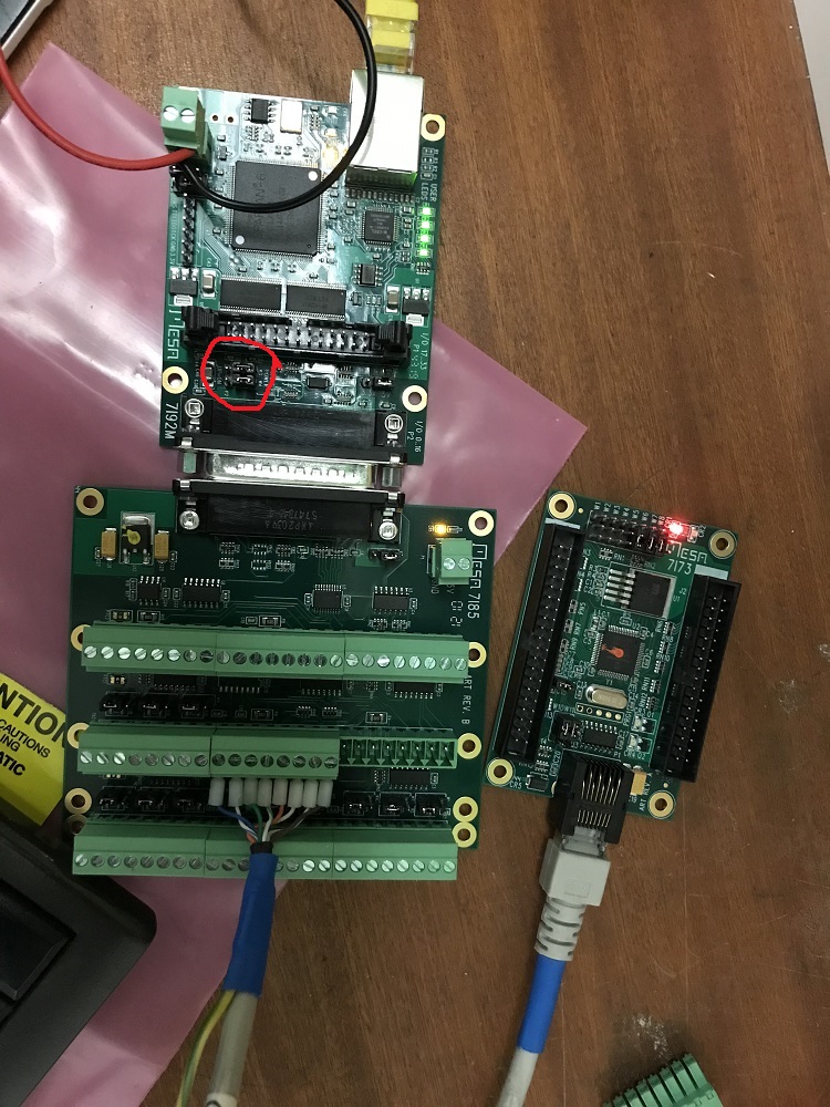

W3-W4 is up? That's is what you need to provide 5v power ti 7i85 which is selected to get 5v from the cable. Looks to me like W3 ,W4 is down on 7i92.

Thanks guys. W3 and 4 are both up. You are right that I got the 7i85S bitfile instead of the 7i85 Peter. Thanks for picking that up.

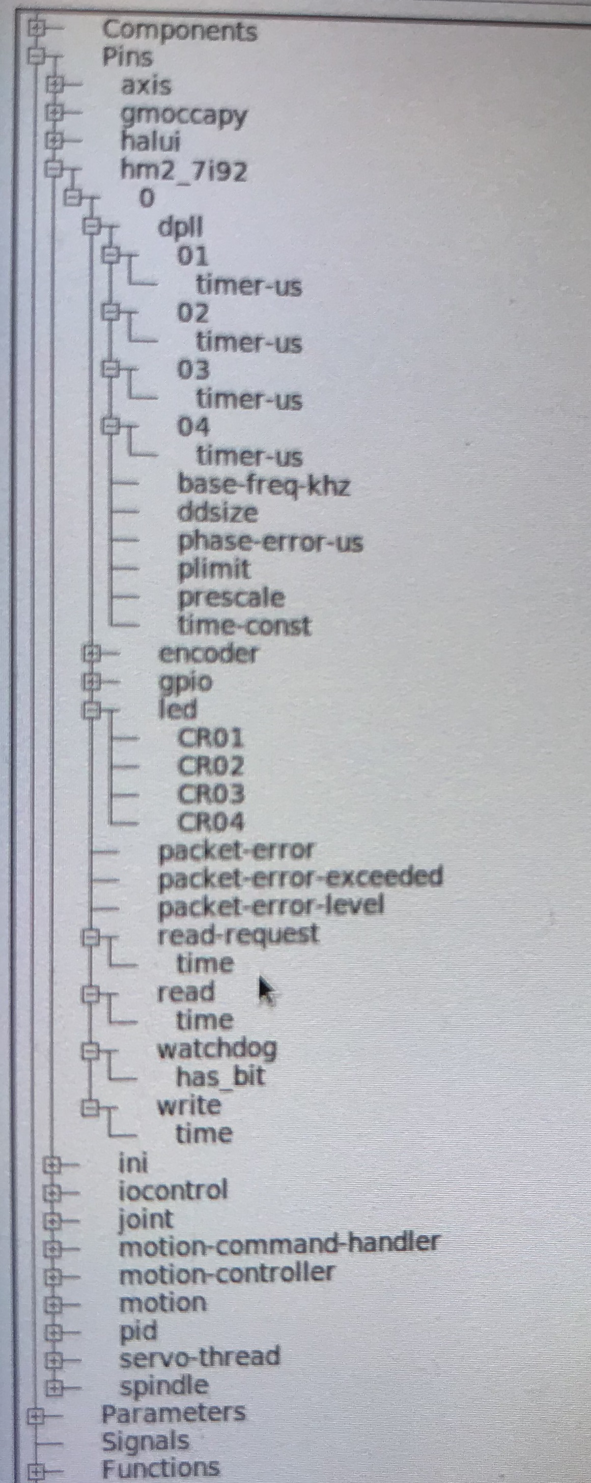

I have now flashed it with 7i92_7i85x2d.bit, and attached is the readhmid.
Running linuxcnc CNC, with the attached HAL, the connected 7i73 still just gives a steady watchdog LED , and the HALshow still shows no further pins.

Changed the HAL to sserial_ports= 0x0000000 and now the 7i73 is showing green. Yaahhhh!
