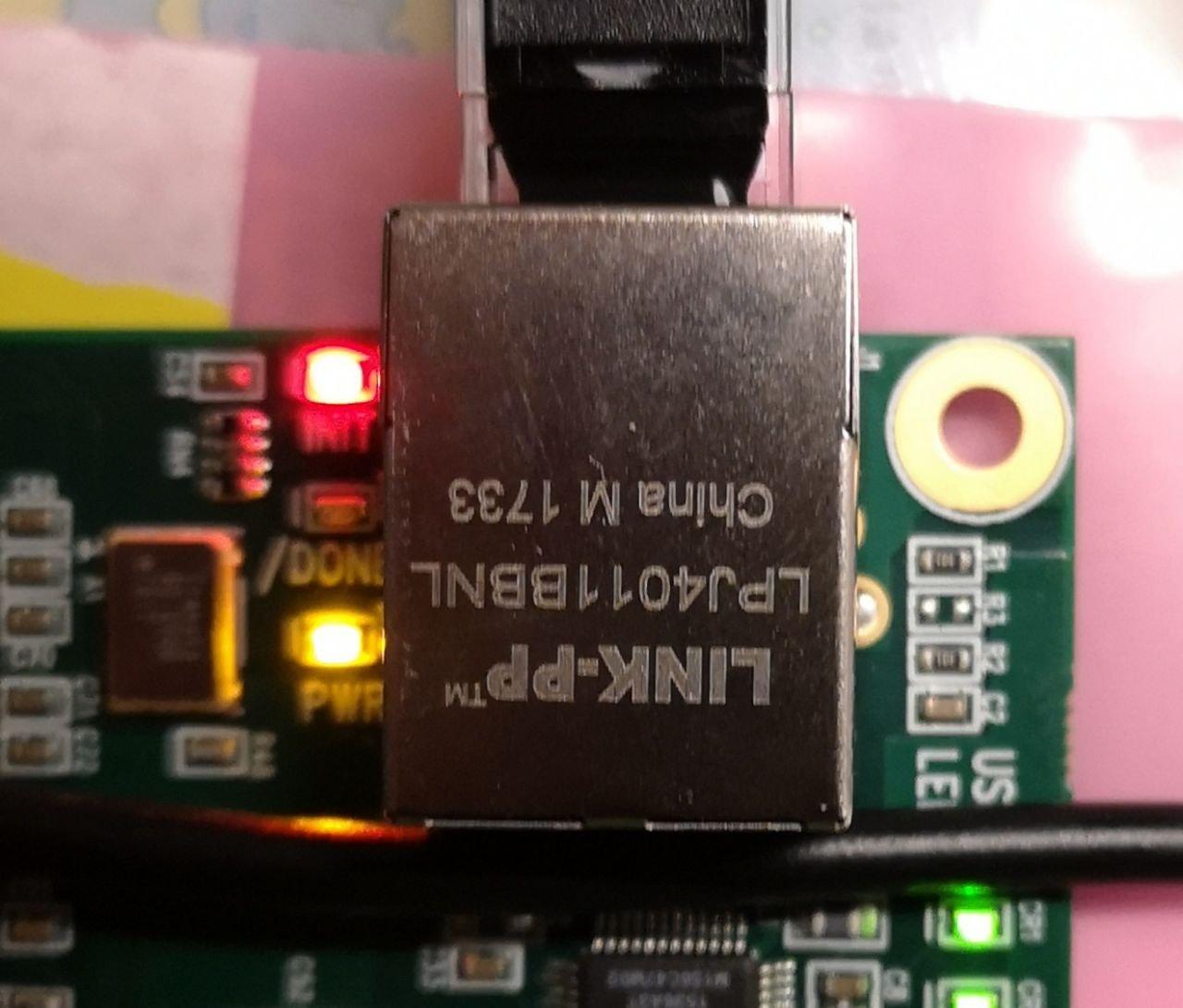

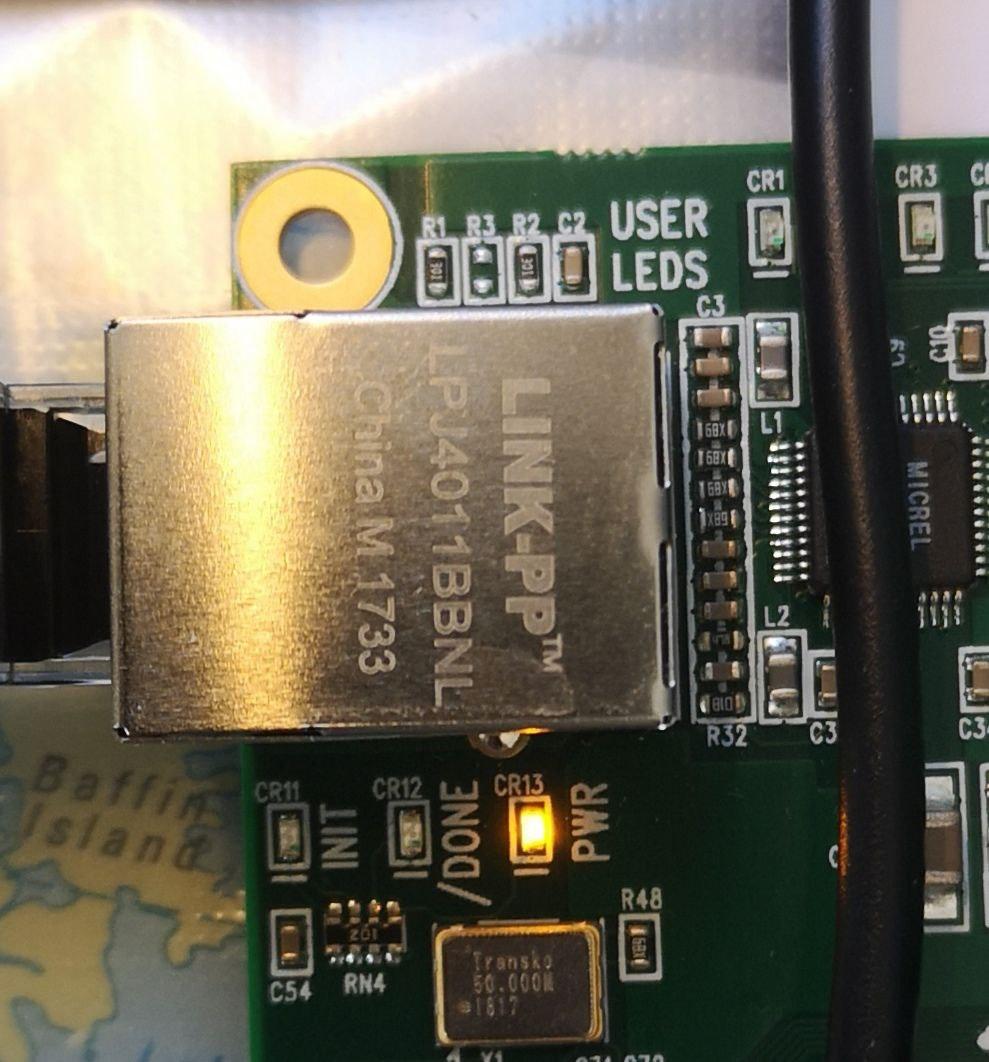

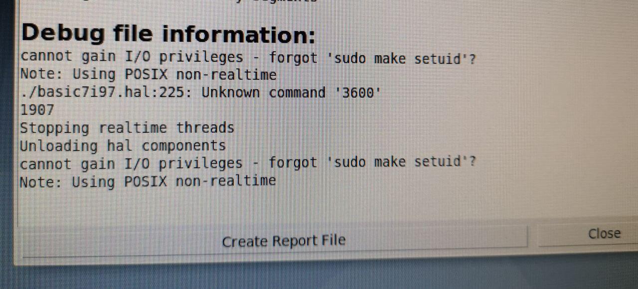

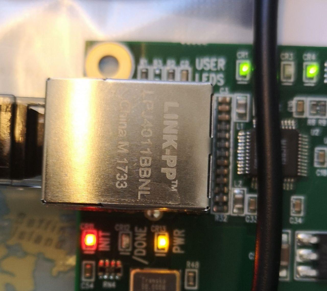

30 Nov 2021 17:48 #228047 by Arnold
Replied by Arnold on topic 7i97 no ethernet connection
Debug info
Before running linuxcnc
After running linuxcnc
30 Nov 2021 18:07 - 30 Nov 2021 18:12 #228050 by PCW
Replied by PCW on topic 7i97 no ethernet connection
The LEDS are in the expected states
Looks like there's extra text on line 225 of the hal file
"[SPINDLE_0]OUTPUT_SCALE"
Deleting that line should fix the "unknown command" error
The "cannot gain I/O privileges" and "using POSIX non-realtime" errors
are caused by some installation problem. How did you install LinuxCNC?

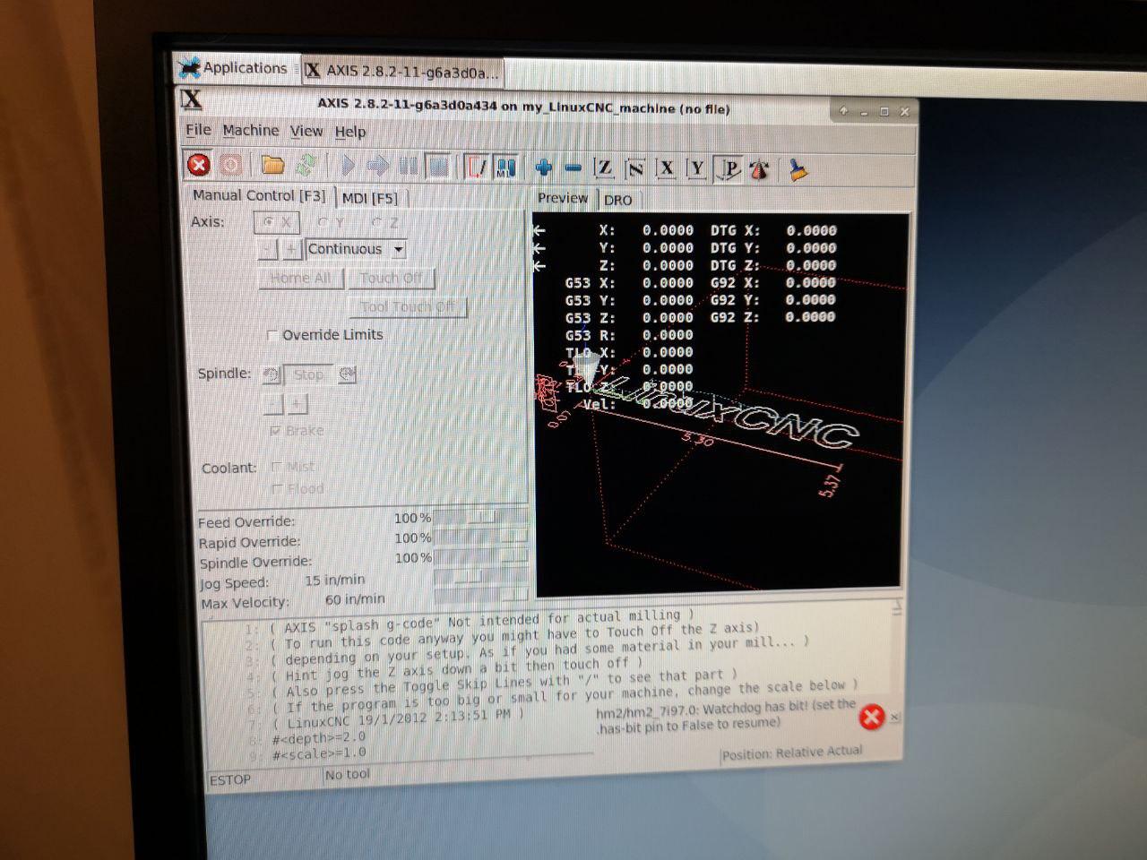

30 Nov 2021 18:53 #228053 by Arnold
Thanks!
#[SPINDLE_0]OUTPUT_SCALE
it let Linuxcnc to start, but it takes long very long time, and seems unstable
red light again

30 Nov 2021 19:35 #228064 by PCW
Not sure what's broken on your installation, but "cannot gain I/O privileges"
is a show-stopper (unless you just want to run in simulation mode)
The hang is likely because in the ini file:
[TASK]
TASK = milltask
CYCLE_TIME = 100
Should be changed to:
[TASK]
TASK = milltask
CYCLE_TIME = 0.100
(there was a change in the interpretation of these timing values
at some point so 100 used to mean 100 ms but now means 100 seconds)
The following user(s) said Thank You: Arnold
[TASK]
TASK = milltask
CYCLE_TIME = 100
[TASK]
TASK = milltask
CYCLE_TIME = 0.100
New Install, and CYCLE TIME corrected as you mentioned.
Things start to improve
Thanks!!
