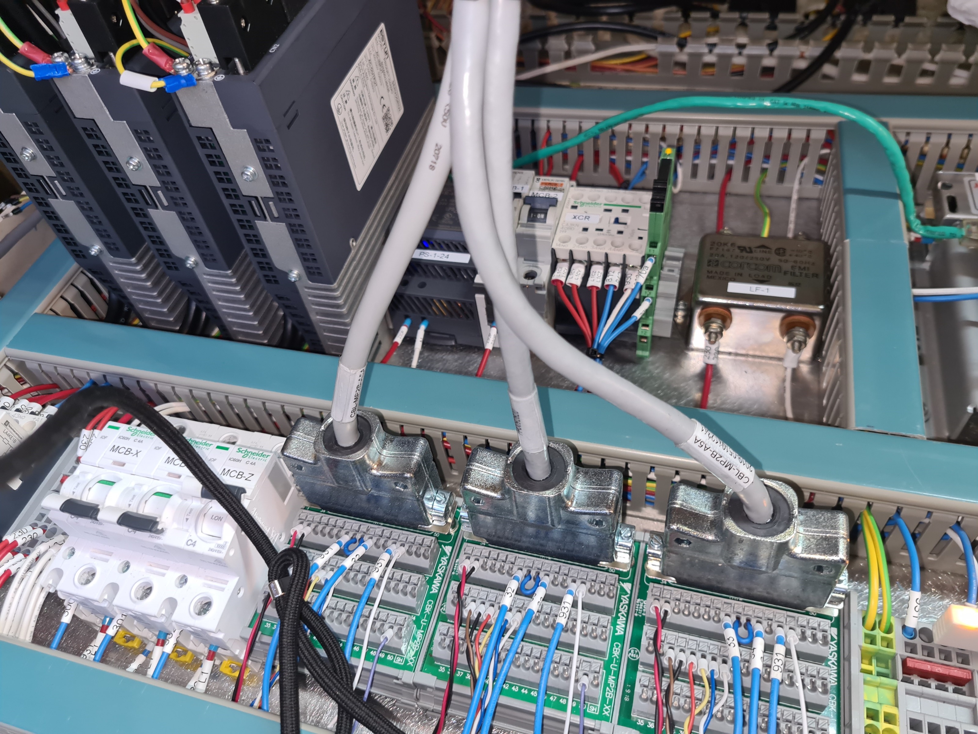

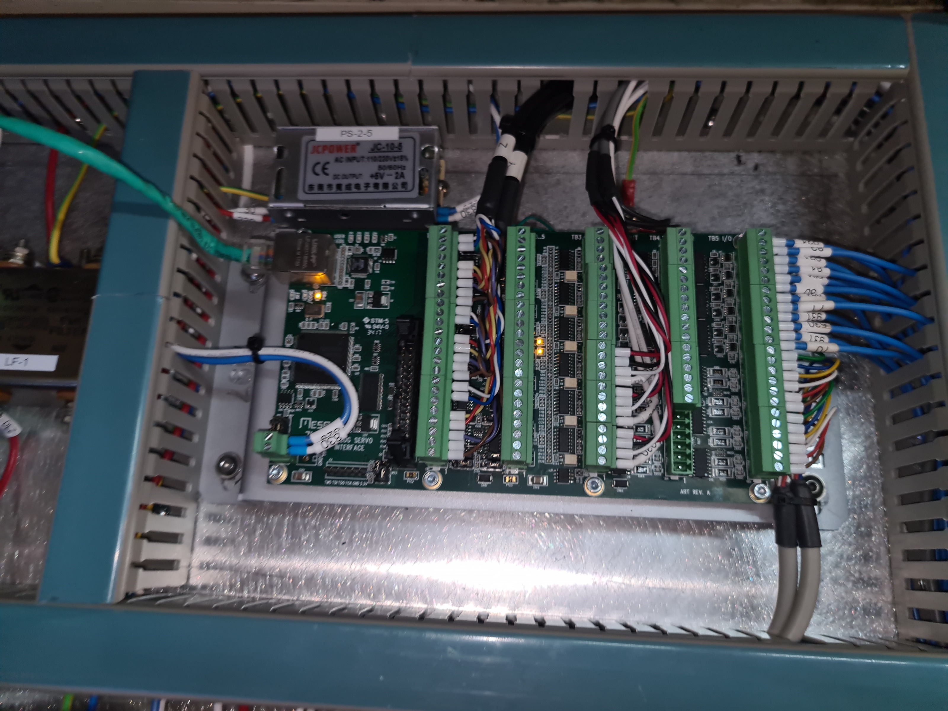

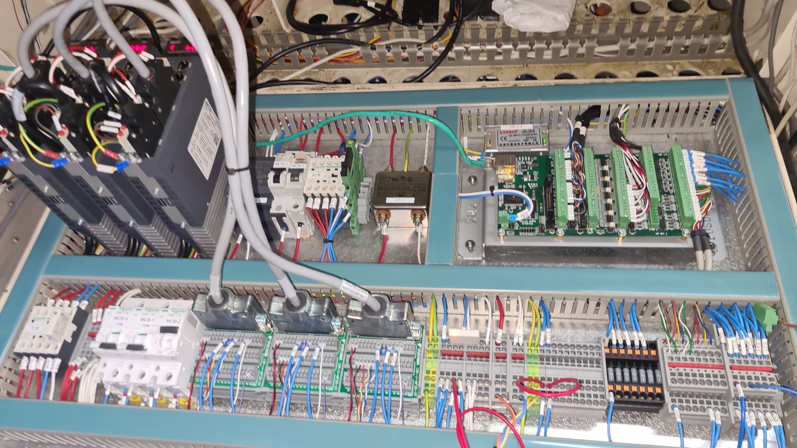

Yes the wiring is as per your postabove.The whole thing was wired up by Yaskawa engineer and my Service engineer helped me a bit over the weekend, but he specialises in Bostomatics with OpenCnc, so no one can help me with linuxcnc, attached some pics and the wiring for the servo.

I would the check Enable switching with a multimeter (across ENA+ and ENA- at the 7I97)
- mosoeng
- Posts: 36
03 Dec 2021 15:53 #228296
by mosoeng
Replied by mosoeng on topic Mesa 7i97
I put a meter on it and I cant see it switching
- Posts: 18100
- Thank you received: 5326
03 Dec 2021 16:02 #228299
Replied by PCW on topic Mesa 7i97
What voltage do you get between ENA+ and ENA-?
- mosoeng
- Posts: 36
03 Dec 2021 16:03 #228300
by mosoeng
24v
- Posts: 18100
03 Dec 2021 16:06 #228301
Can you enable the drives by shorting ENA+ to ENA- ?
- mosoeng
- Posts: 36
03 Dec 2021 16:24 #228303
by mosoeng
not able to enable by shorting ENA+ to ENA-
- Posts: 18100
03 Dec 2021 16:39 #228304
OK so that suggests a wiring or drive setup error
- mosoeng
- Posts: 36
07 Dec 2021 10:17 #228523
by mosoeng
I have found that the 24v on ENA+ to ENA- drops when I press F2, so is mesa board going into stop mode for some reason or is that ment to be?
- Posts: 18100
07 Dec 2021 16:25 #228540
OK that's correct.
The 7I97's ENA+ and ENA- connect when analog out is enabled in LinuxCNC
So when F2 is pressed the drives should be enabled and hold position.
(though they may "run away" if the feedback direction is backwards)
