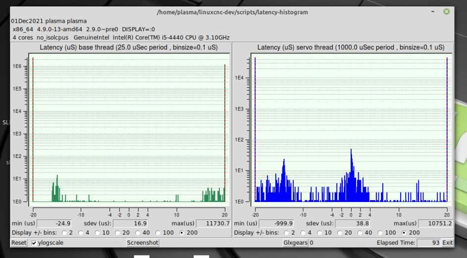

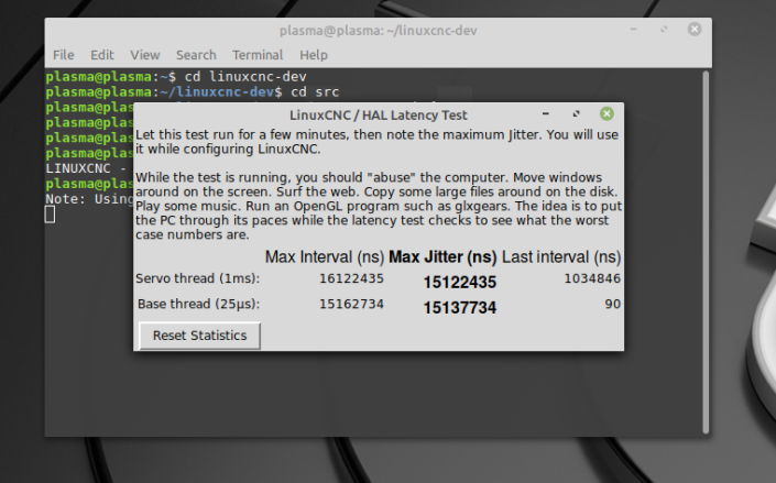

- thefabricator03
- Visitor
30 Nov 2021 22:25 #228077
by thefabricator03
Replied by thefabricator03 on topic 7i76e Start Up Error
PCW,
Please see attached screenshots. How bad is that latency?
- Posts: 18103
- Thank you received: 5326
30 Nov 2021 22:37 #228081
Replied by PCW on topic 7i76e Start Up Error
15 MS! (about 50X what the worst case should be)
The system must have "upgraded" your
kernel to a non-realtime version since
the kernel listed by the latency-histogram
is a stock kernel.
is a stock kernel.
