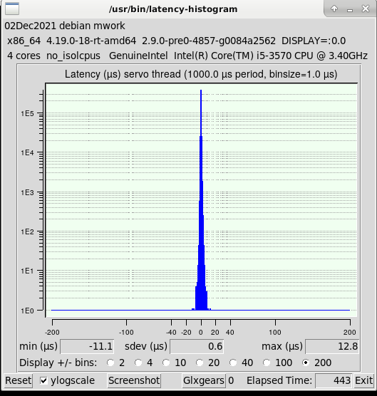

My test :  latency-histogram --nobase --sbinsize 1000

03 Dec 2021 15:14 #228290 by PCW
OK that's probably OK assuming a 2-3 Ghz CPU (times on X86 are in CPU clocks)
So not sure... might be a faulty 7I80 or faulty host Ethernet port, do you have an alternate
Ethernet interface you can try?
