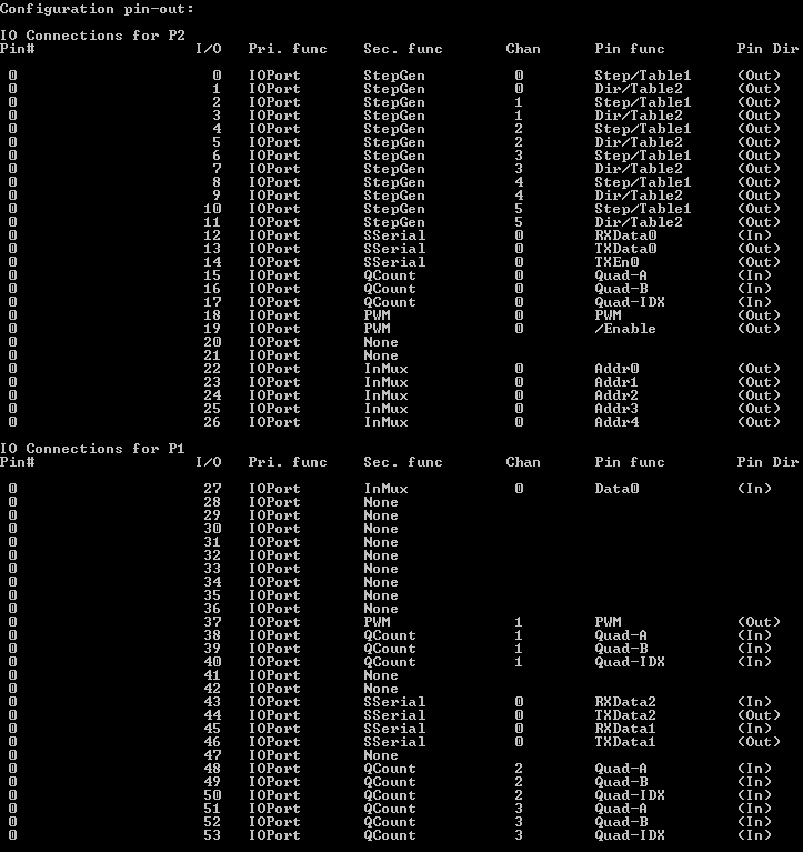

16 Feb 2022 17:51 - 16 Feb 2022 18:19 #235057 by Boaschti
Replied by Boaschti on topic Create a FPGA board for raspberry
Oh.
What I have to do if i have to compile linuxcnc with fixed driver?
Follow this  steps?
Can anybody make a bit File with following Pinout (IOPort<=>Pin from 7c80spi.ucf)?
IO Connections for StepGens+Misc
Pin#  I/O   Pri. func    Sec. func       Chan      Pin func        Pin Dir
 0      0   IOPort       StepGen          0        Step/Table1     (Out)
 0      1   IOPort       StepGen          0        Dir/Table2      (Out)
 0      2   IOPort       StepGen          1        Step/Table1     (Out)
 0      3   IOPort       StepGen          1        Dir/Table2      (Out)
 0      4   IOPort       StepGen          2        Step/Table1     (Out)
 0      5   IOPort       StepGen          2        Dir/Table2      (Out)
 0      6   IOPort       StepGen          3        Step/Table1     (Out)
 0      7   IOPort       StepGen          3        Dir/Table2      (Out)
 0      8   IOPort       StepGen          4        Step/Table1     (Out)
 0      9   IOPort       StepGen          4        Dir/Table2      (Out)
 0     10   IOPort       StepGen          5        Step/Table1     (Out)
 0     11   IOPort       StepGen          5        Dir/Table2      (Out)
 0     12   IOPort       SSerial          0        RXData0         (In)

Does anybody knows what th ssr funktionality is for?
Out0..7 in phase with AC Ref == on and Out0..7 out of phase with AC Ref == off.
The only logical for following hardware is a XOR chip. We never have seen sth like this and i cannot find sth about it.

16 Feb 2022 19:03 - 17 Feb 2022 10:31 #235064 by D.L.
Replied by D.L. on topic Create a FPGA board for raspberry
Bitfile for 7c80 without ssr module:
File Attachment:
File Name: 7c80d.zip
File Size:104 KB
Bitfile for 7c80 without ssr module and with PWM0 /Enable output:
File Attachment:
File Name: 7c80v2.zip
File Size:105 KB
Pinfile from 7c80v2.zip was tested on Hostmot2 ethernet hardware:
Last edit: 17 Feb 2022 10:31 by D.L..
16 Feb 2022 21:34 - 16 Feb 2022 22:47 #235081 by PCW
Replied by PCW on topic Create a FPGA board for raspberry
If you take the pinout file that D.L. provided and edit it to:
1. Add your additional encoders, sserial ports and PWMgens
2. Remove the inmux (actually not sure here if your hardware include the muxes or not)
Either D.L or I can take that new pinout and make a bitfile that
matches your hardware.
Last edit: 16 Feb 2022 22:47 by PCW.
17 Feb 2022 10:40 #235115 by D.L.
1. Additional encoders, sserial ports and PWMgens not needed, the pinout was created for the current scheme .
2. InMux module needed, in the current scheme used multiplexing(ICs: U1-U4) input signals IN0-IN23.
