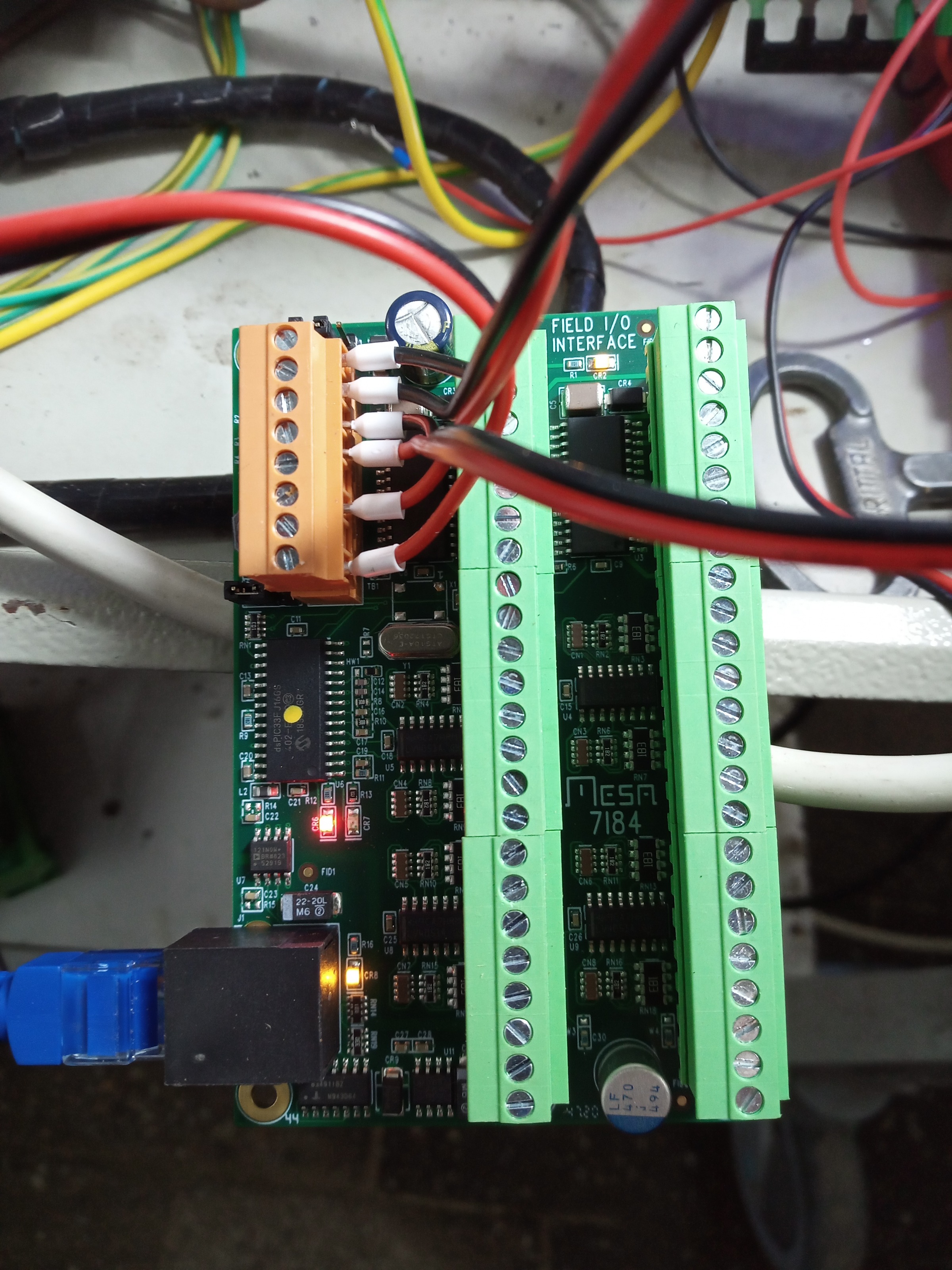

Hopefuly PCM can help me with this.
I have a 7i96 card, flashed with standard firmware. I also have a 7i85 connected to p3. This all works great.
Now I have bought a 7i84 and wonder if I have to adjust anything on the 7i96 to get it working? Or will it work straight out of the box?
Don't have the card yet, should arrive this afternoon.

7i84 is an I/O port with 32 in and 16 out, right ?
It connects to FPGA via smart serial, so if you have a free sserial on the 7i96 ( i do not know if 7i96 has it, still waiting for mine), use a RJ45 connector or an ethernet cable cut in half.
It does not require any programming flashing of cards.

Thanks, card just arrived and is connected. Does not work yet, but I will struggle on.7i84 is an I/O port with 32 in and 16 out, right ?

Did you power it with field power?
Also check the manual for cabling, it has a simple solution for the ethernet cable.
Start LinuxCNC, got to machine menu and open "show hal configuration", there on the left side navigate to find the 7i84.

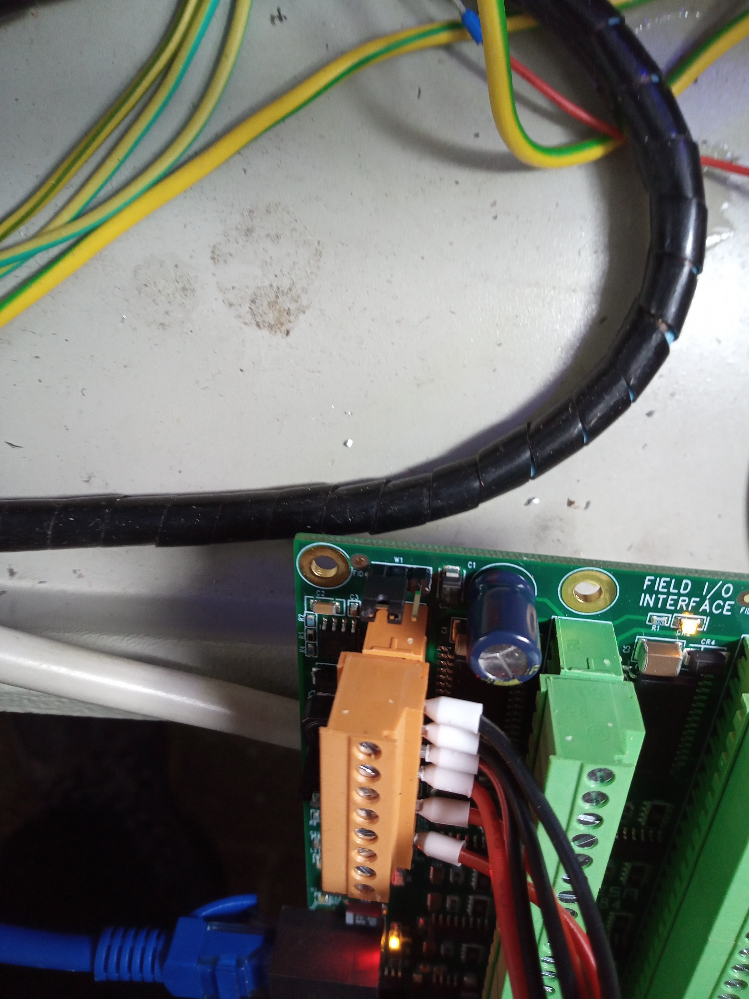

Yes, everything is connected. Field voltage 12v, logic 12vBut it looks like my 7i96 does not have the correct sserial connections.Configuration Name: HOSTMOT2General configuration information: BoardName : MESA7I96 FPGA Size: 9 KGates FPGA Pins: 144 Number of IO Ports: 3 Width of one I/O port: 17 Clock Low frequency: 100.0000 MHz Clock High frequency: 200.0000 MHz IDROM Type: 3 Instance Stride 0: 4 Instance Stride 1: 64 Register Stride 0: 256 Register Stride 1: 256Modules in configuration: Module: DPLL There are 1 of DPLL in configuration Version: 0 Registers: 7 BaseAddress: 7000 ClockFrequency: 100.000 MHz Register Stride: 256 bytes Instance Stride: 4 bytes Module: WatchDog There are 1 of WatchDog in configuration Version: 0 Registers: 3 BaseAddress: 0C00 ClockFrequency: 100.000 MHz Register Stride: 256 bytes Instance Stride: 4 bytes Module: IOPort There are 3 of IOPort in configuration Version: 0 Registers: 5 BaseAddress: 1000 ClockFrequency: 100.000 MHz Register Stride: 256 bytes Instance Stride: 4 bytes Module: PWM There are 1 of PWM in configuration Version: 0 Registers: 5 BaseAddress: 4100 ClockFrequency: 200.000 MHz Register Stride: 256 bytes Instance Stride: 4 bytes Module: StepGen There are 4 of StepGen in configuration Version: 2 Registers: 10 BaseAddress: 2000 ClockFrequency: 100.000 MHz Register Stride: 256 bytes Instance Stride: 4 bytes Module: QCount There are 1 of QCount in configuration Version: 2 Registers: 5 BaseAddress: 3000 ClockFrequency: 100.000 MHz Register Stride: 256 bytes Instance Stride: 4 bytes Module: SSerial There are 1 of SSerial in configuration Version: 0 Registers: 6 BaseAddress: 5B00 ClockFrequency: 100.000 MHz Register Stride: 256 bytes Instance Stride: 64 bytes Module: SSR There are 1 of SSR in configuration Version: 0 Registers: 2 BaseAddress: 7D00 ClockFrequency: 100.000 MHz Register Stride: 256 bytes Instance Stride: 4 bytes Module: LED There are 1 of LED in configuration Version: 0 Registers: 1 BaseAddress: 0200 ClockFrequency: 100.000 MHz Register Stride: 256 bytes Instance Stride: 4 bytesConfiguration pin-out:IO Connections for TB3Pin

29 Dec 2021 17:09 #230255
by ikkuh
Here are pictures of the leds and jumpers LinuxCNC not running
Replied by ikkuh on topic Mesa 7i96+7i85+7i84
Thanks!To get the 7I84 working you should have the jumpers in the default position
(W1 and W2 in the left position), field power applied to both A and B sides,
and the correct RJ45 cable.
When LinuxCNC is not running but everything is powered up, you should have
two yellow and one red LED illuminated. When LinuxCNC is running, the red
LED should extinguish and you should get a blinking green LED instead.
- Posts: 18104
- Thank you received: 5328
29 Dec 2021 17:15 #230257
Replied by PCW on topic Mesa 7i96+7i85+7i84
Possibly a cable error of some kind
Time to create page: 0.385 seconds
