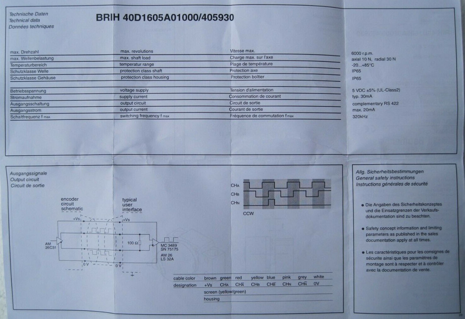

1. How do I setup and wire this encoder(BRIH-40D1605A1000)correctly?
brown + Vs
green ChA
red ChA
yellow ChB
blue ChB
pink ChN
gray ChN
white 0v
yell/gr screen
do I need 2 pins for each channel(A. B. N)?

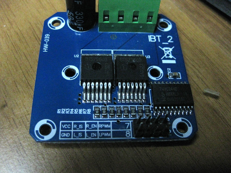

2. How do I setup and wire an IBT-2 (BTS7960) with the Mesa card?
Do I need 2 PWM pins (RPWM, LPWM) and 2 enable pins (R_EN, L_EN) per motor?

That is a differential encoder, normally you would use a differential
input daughtercard for interfacing with this type of encoder but if you
connect it directly to a 7I98, you would only use one of each pair, that is,
only connect to:
CHA
CHB
CHN
+5V
GND

the BTS7960 has R-PWM, L-PWM and 2 Enable pins,
is it the right way if I connect the 2 PWM pins together and switch the R-EN and L-EN with DIR signals?

I would expect to drive the R-PWM and L-PWM pins with PWM outputs
with the PWM output type set to 2=up/down mode. The enables are
probably tied together and connected to a GPIO bit
NOTE: Directly connecting the FPGA outputs to a non-isolated driver chip
(with a common ground with the motor power supply) is quite likely
to damage the FPGA card unless you are very careful about EMI and ground
bumping. This also applies to the encoder connections. If you wish to do this,
at least add a 220 Ohm or so series resistor to each FPGA I/O pin to prevent
damage from negative voltage spikes

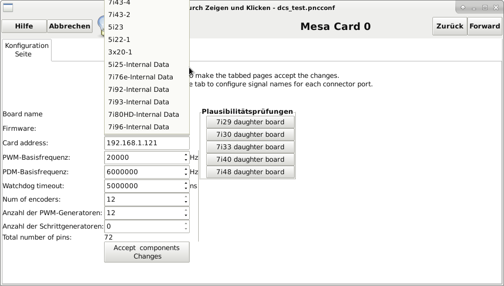

finally i managed to flash my Mesa card, but the card does not appear in pncconf. How can I add the 7i98.
