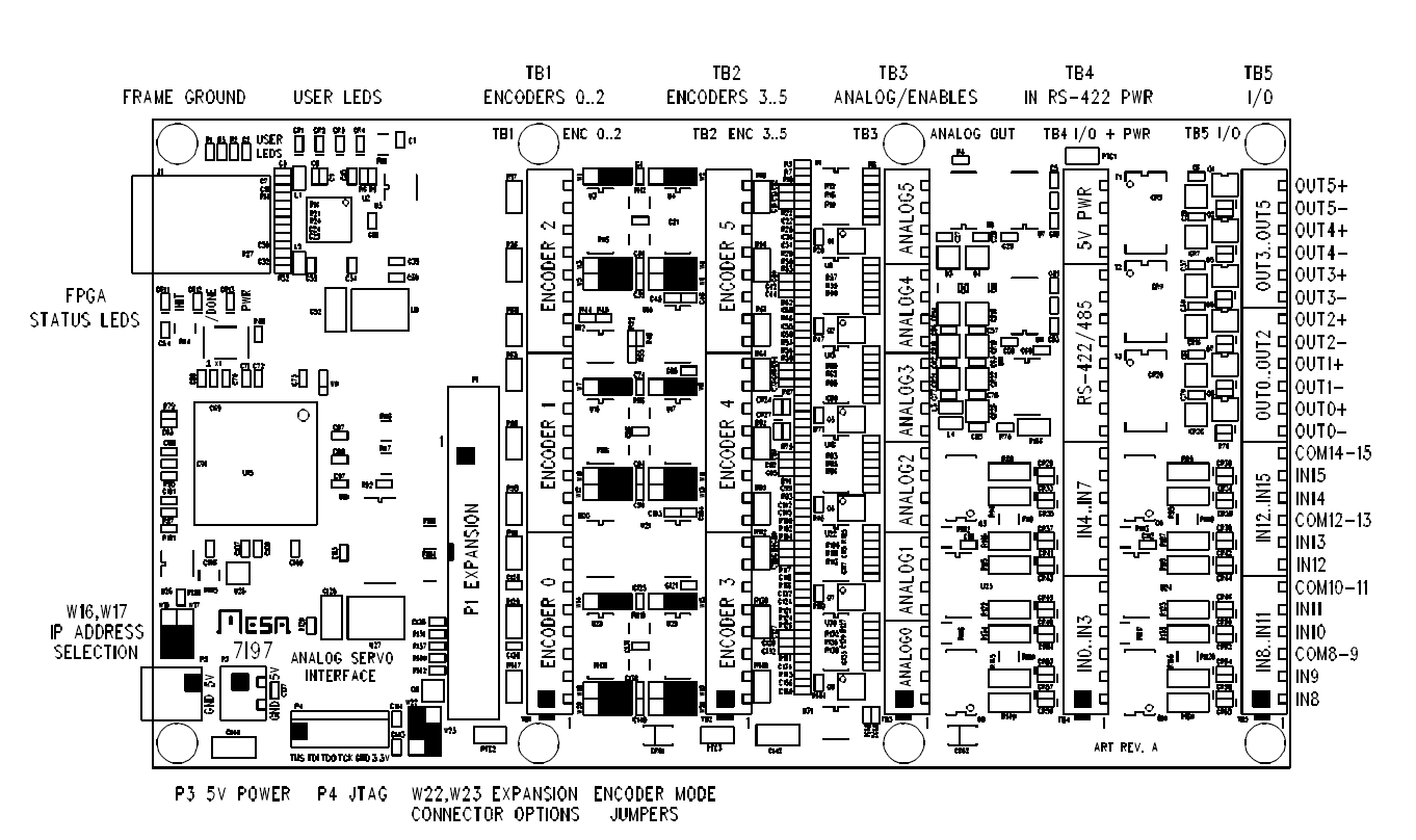

I´ve read all manuals from back to forth, but I just cant figure out where to feed the 7i97 board with 24v, to get 24v outputs (manual states they can be up to 36v)...
I will be running -+10v to servo drivers, and 24v high to relays, so somewhere the board must get the 10v and 24v from...
P3 is the main 5v to run the board it self, TB4 is for 5v and I have no clue what to do with the 24v...

For 24V outputs you would wire
OUTN+ to +24V
OUTN- to Load
OUTN+ to +24V
OUTN- to Load

Aha to easy! Thx
