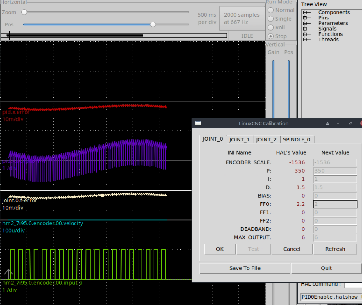

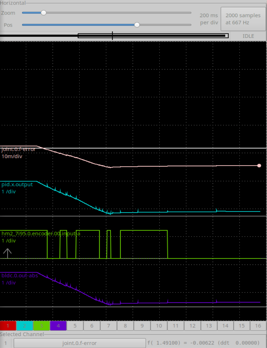

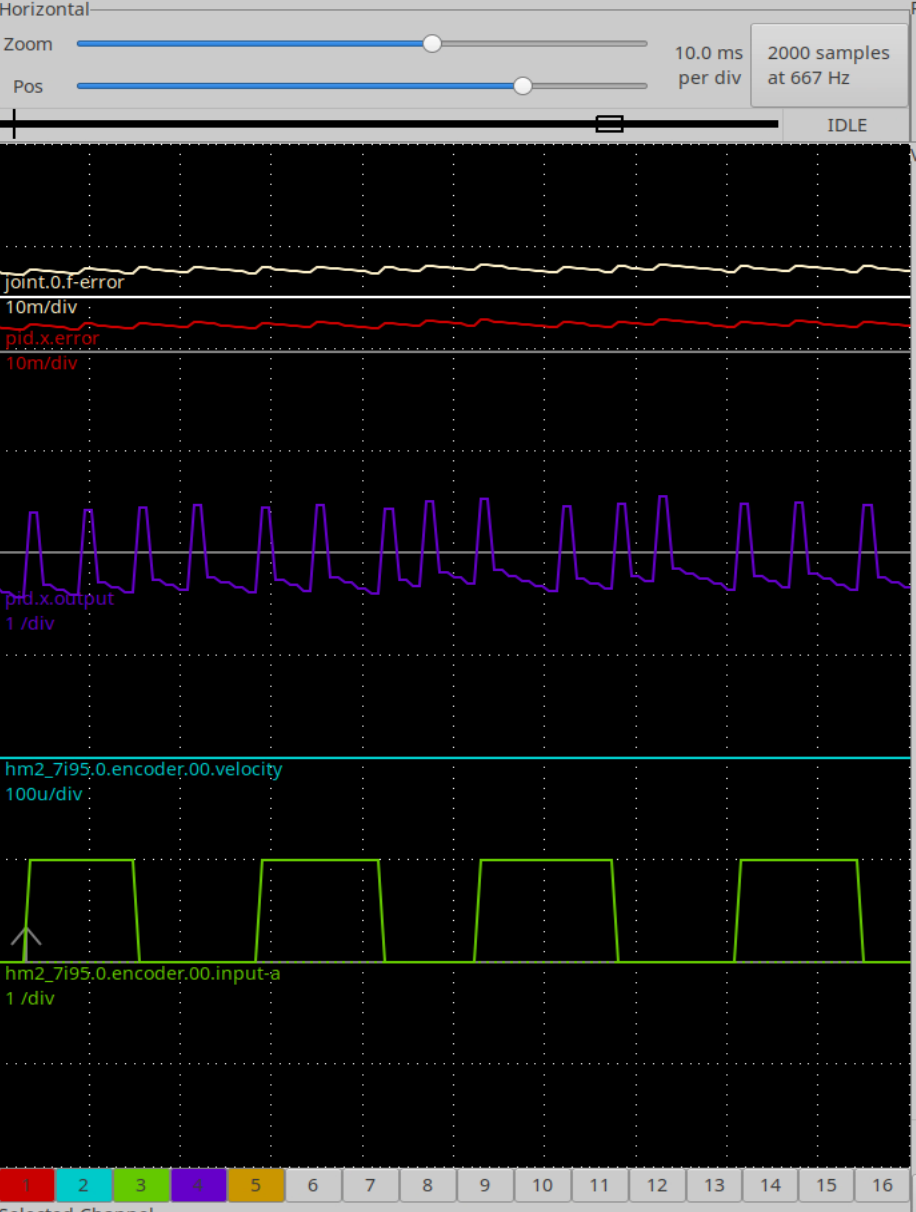

So I reduced the encoder counts from 8192 (which were clean - not spikey) to 1536 ppr, because I doubt 8192 x 3000rpm on three axis is gonna be kept up with anyway...
Still getting a non-smooth motion in two dimensions - tiny reactions to encoder inputs and some kind of long sinusoidal that I guess is from the motor cogging on 80% power.... Is the pid not smoothing though ? or is my I too low?
High speed pass.
Is the pid overreacting for some reason ?
High speed pass.

Replied by andypugh on topic 8i20
Hmm. Try zeroing out the D term?
