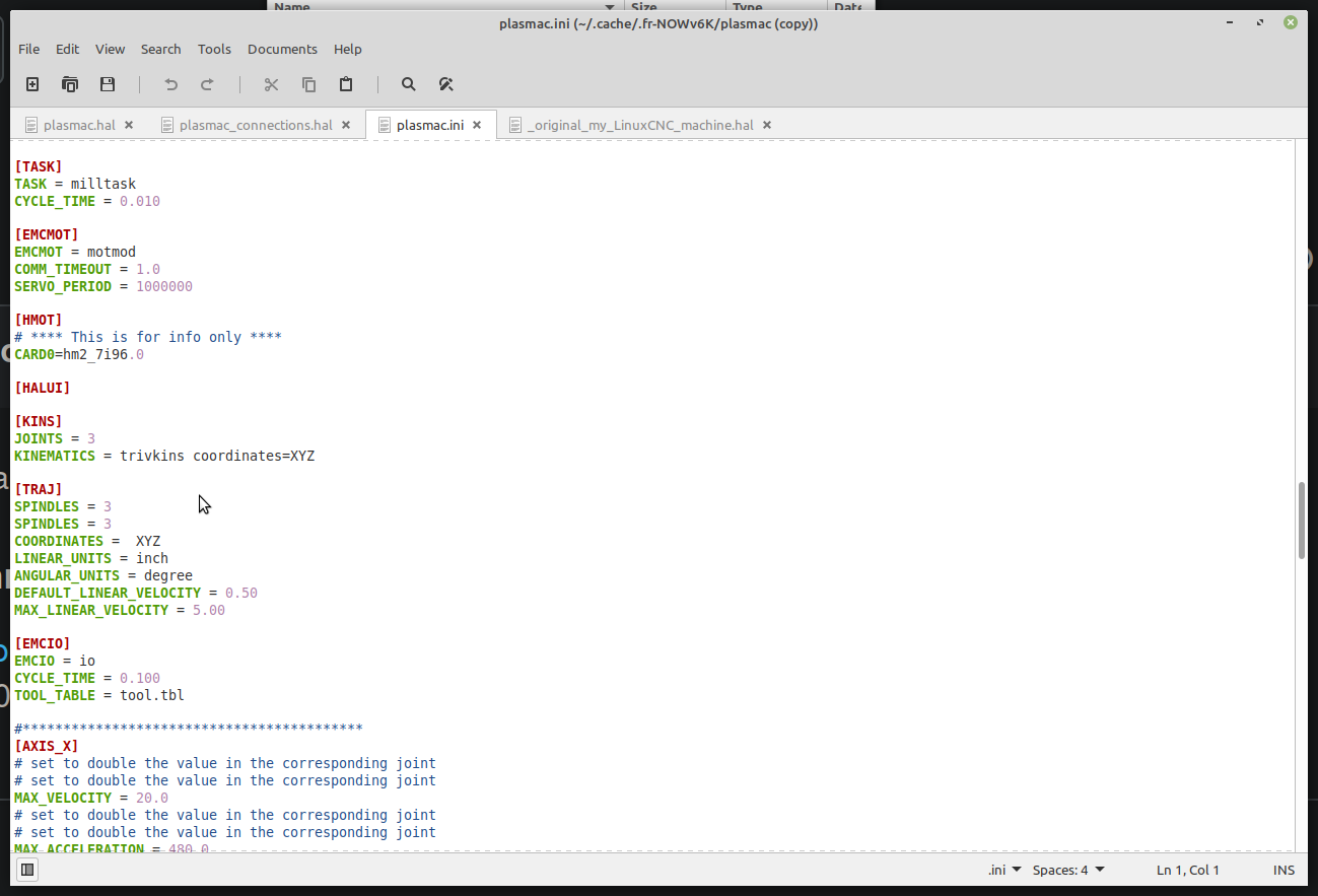

In your ini file you have SPINDLES=3 twice in the [TRAJ] section, try deleting one of them and see what happens.

well i want to thank all of you for your help but now i am getting this error
- Posts: 21980
- Thank you received: 7480
15 Mar 2022 22:29 - 15 Mar 2022 22:30 #237398
Replied by tommylight on topic 7i96 with stepper motors
Why are so many things on your config duplicates? How did that happen?
From the error report:Edit the ini file and remove any duplicate lines.
HAL: ERROR: duplicate component name 'plasmac_wizards'
*** GLADE VCP ERROR: Asking for a HAL component using a name that already exists
Last edit: 15 Mar 2022 22:30 by tommylight. Reason: more info

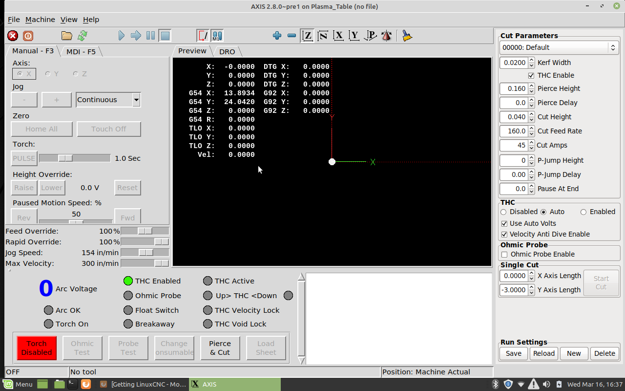

Good afternoon so i deleted all my previous setup files and started all over now i have a opening plasmac that i can home and move the table around but well i tell it to cut a line nothing happens. seams like i am missing 2 tabs where preview and dro are also at the bottom it shows no tool can i please get some help with what to do next? also i added a compressed version of my full linux cnc file

Try commenting out the following line in plasma_table.ini
You seem to be using a very old version of LinuxCNC 2.8, I would recommend changing the repositories to the Buildbot and updating to the latest.
buildbot.linuxcnc.org/
EMBED_TAB_NAME = RunYou seem to be using a very old version of LinuxCNC 2.8, I would recommend changing the repositories to the Buildbot and updating to the latest.
