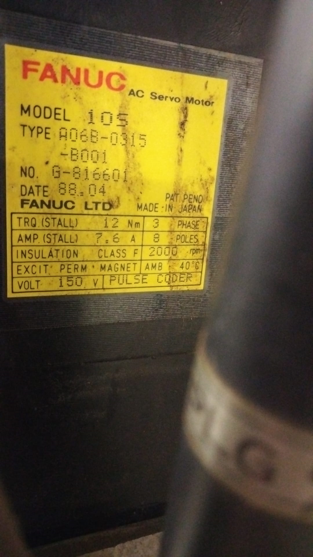

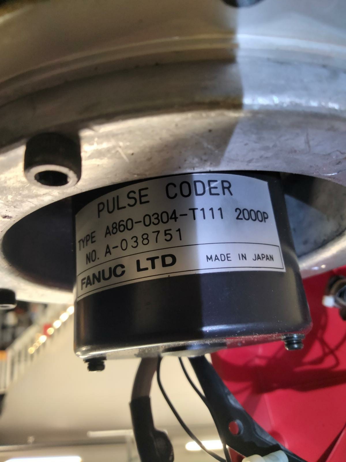

Servos are for X and Y fanuc 5s, not sure about the exact model yet, but smaller than the Z servo that is 10S. I have attached pictures about the Z servo and its pulse coder, have i understood right that I cant directly use this pulse coder for position feedback with mesa? I need to replace it or use converter? Changing it to some other encoder is not mechanically a problem for me, atleast the pico converters would became pretty expensive shipped to finland.
Have i understood right that the MESA 8i20 servo drive will be enough for these servos? Is it controlled directly from the ethernet or from the I/O daughtercard pins where the position feedback goes? (like 7i77 or 7i95)

Replied by andypugh on topic Mesa card setup for 3axis fanuc retrofit?
If you have existing compatible 0-10V servo drivers then I would keep them. (Are you sure that it is 0-10 + dir and not +/- 10V?)
If you need to switch to the 8i20 for some reason, then that communicated digitally using a CAT5 cable, but it is not Ethernet, but Mesa's own serial protocol. How many channels of Mesa smart-serial would you need?
I think that the encoders should be compatible with the LinuxCNC "bldc" component.
As far as I can tell (from Google sending me to this forum...) they have 4 commutation outputs and 2000 pulses per rev quadrature.
You should be able to connect the commutation to the bldc component, then send the rotor angle to the 8i20.
linuxcnc.org/docs/stable/html/man/man9/bldc.9.html
(specifically the "f" input mode)

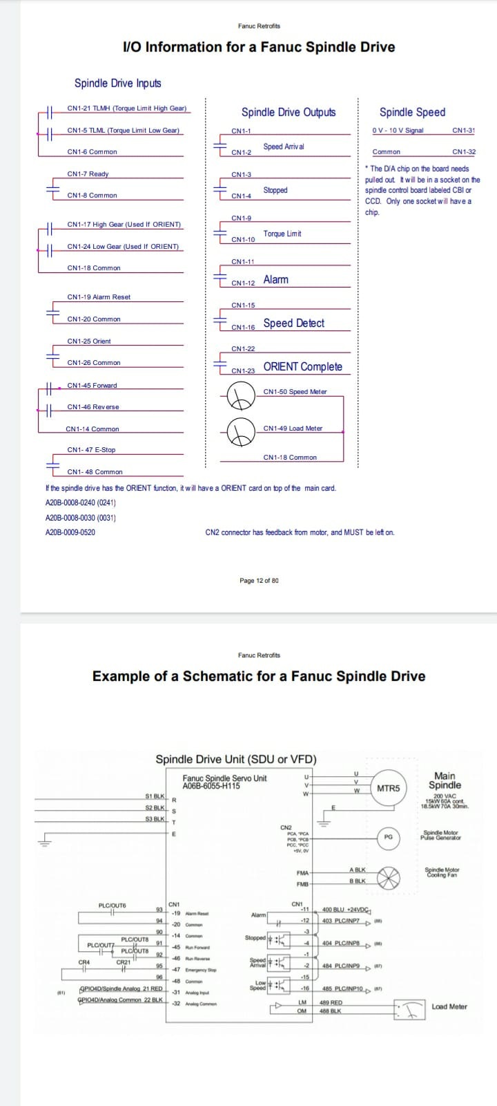

Yes, spindle servo drive is 0-10v and direction. Its pinout seems to be much same as in the "Centroid CNC
Centroid Fanuc CNC Retrofit Installation Manual CNC Retrofits" (picture)

I’ll have to take a deeper look in to that encoder thing. I found probably the same discussion about these encoders, but it looked to me that it was a no go. I already ordered one Omron PNP 2000p encoder, for testing if I can’t for some reason get the fanuc ones to work. My goal is (like it seems to for many others too) to get one axis drive to work first, and then do the rest if the first one seems to work properly.

I don't seem to be able to zoom enough to read the text on the bottom picture.
There is a lot to be decided, but for the user panel I would look at putting a 7i73 in the panel (one smart-serial channel)

Oh, well there is run forward and run rewerse pins that goes to common when actiwated, and the spindle speed sure is 0-10v, I have played with these with jumper wires and is confirmed.
