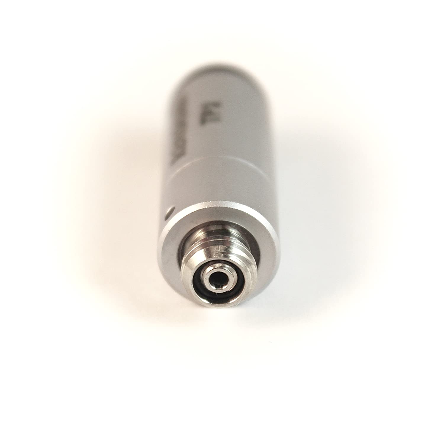

I am trying to interface with a renishaw probe, TP2 and maybe TP200, with M8 connector. I thought a touch trigger probe would be easier to interface but hooking up to a multimeter(nothing happens), I cannot tell which pin is which. I cannot find any information from official renishaw because there is no need. I also have all the information on the external renishaw driver, but I dont know what it means, or how to wire it to a mesa. I was hoping to get away without using the official renishaw hardware.
This is the M8 connector. I cannot figure out which pin is what. A homie from work gave me the probe because they have no use for it, so I really dont want to wreck it before I get to use it. I am under the impression there is another internal driver inside the actual probe. I know the strain force probes have one, and fairly sure the TP2 has one. I get no reading from my multimeter, so I am very hesitant to hook it up to power without knowing the polarity.
If anyone knows the pin out that would be very helpful, or any tips on how I can non-destructively test to figure it out

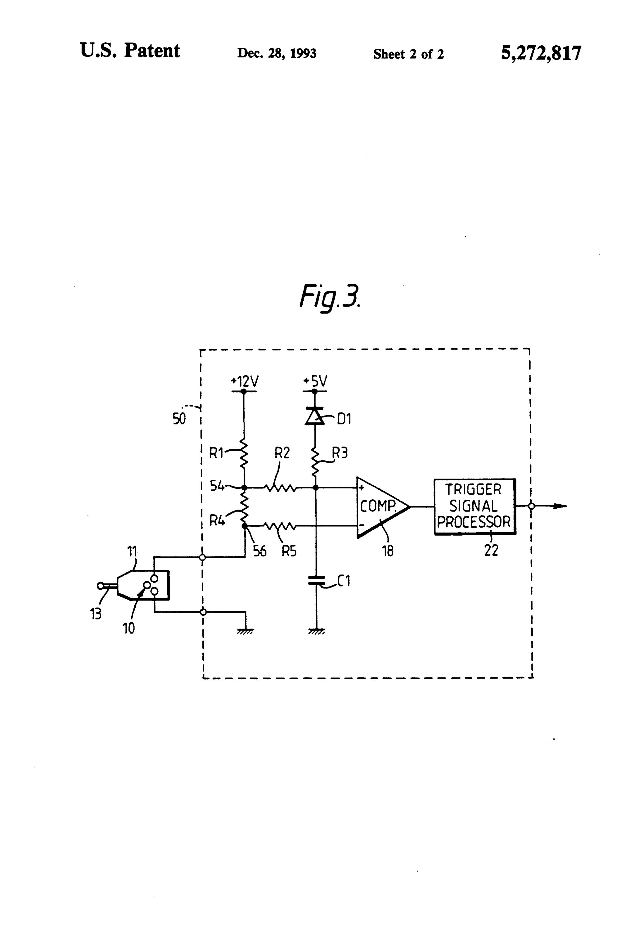

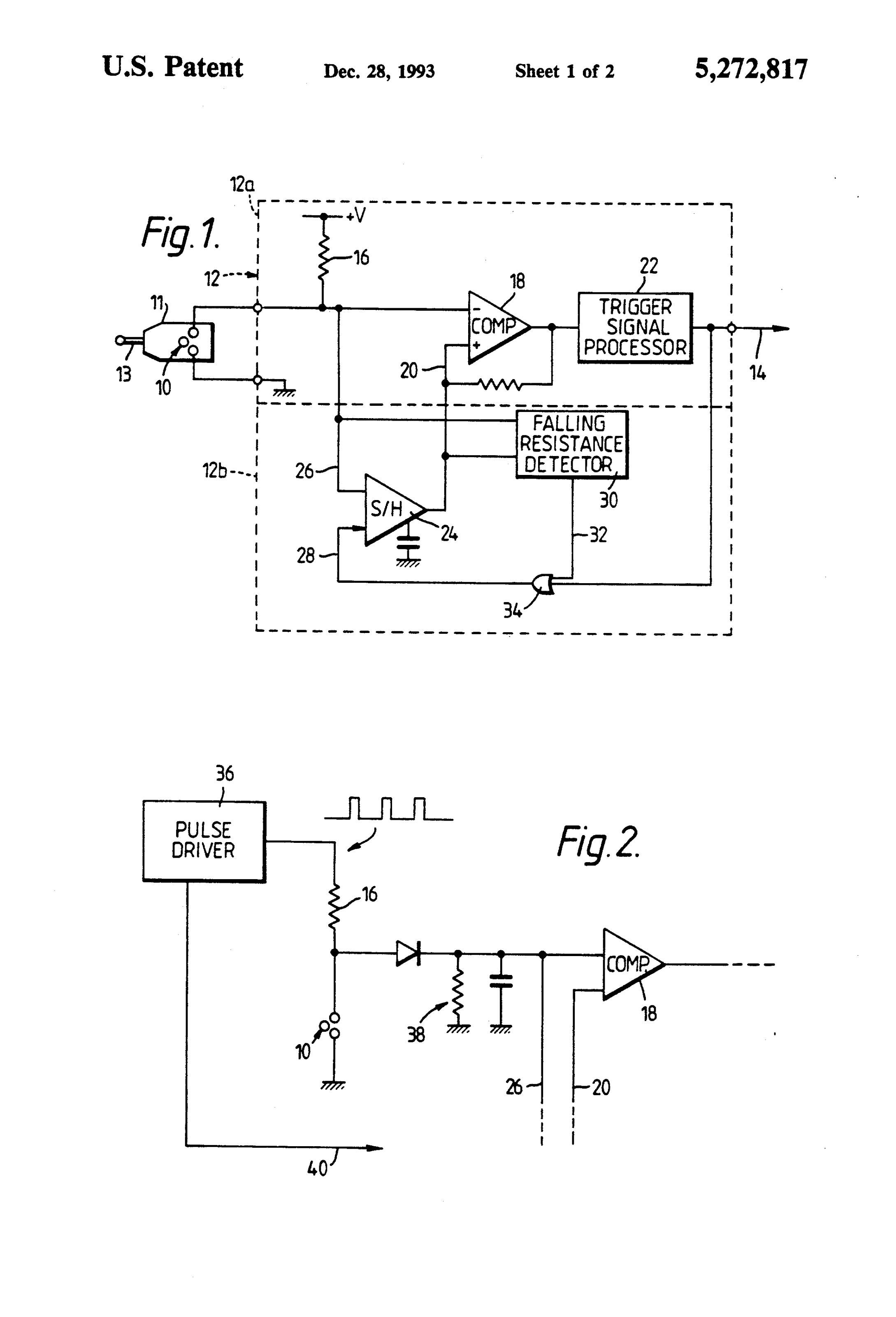

This is a link to the patent for the Renishaw PI4 interface used for trigger force probes. It has a schematic kinda with a detailed explanation of what and how the interface works.
The problem is I dont know what it means relative to the mesa card. What kind of signal is this? Is this just a fancy differential signal?
patents.google.com/patent/US5272817A/en

I have a feeling that what you have there is just the interface module, without the actual probe.
What does the other end look like?

yeah, thats the docs/patent for the TP2 compatible interface, the Renishaw PI4. While I could not find the exact probe patent for the TP2, I have found for various other probes like the Mp1 (i think) and (either the tp20 or tp200) with schematics for the internal driver. These docs are relevent to my TP200 probe, but since I only have half a TP200 (the m8 side), I cant really test it easily. The TP200 is also a strainforce probe, which I figured would be more difficult to interface to. I assumed since the TP2 is just a touch trigger probe, it might be easier to work with, but it is not simple a switch, but has a driver also it appears. None of the patents or docs say what the pinout is for the m8 connector, because they are supposed to be connected to another adapter. The schematic appears to have the details only related to the probe signal, and 10,11,13 look like they represent the 2 contacts on the probe
So, my issue is two fold, I dont know how to determine what the m8 connector pinout is, or what kind of input I can connect it to a mesa (specifically 7i76 but help will do)

TP2 is just a switch .Normally Closed contact.
If you check the TP2 data sheet / catalogue it triggers( or contact opens) with few gram force like 5gram force
usually it should be a TP2-5W (5way )
There is only two contact point from TP2 .
Its a NC contact . One point is usually connected ground body
Contact opens with any force on probe tip
1) Outer M8 thread 2) Middle metal contact.
Use these point to check with multi meter

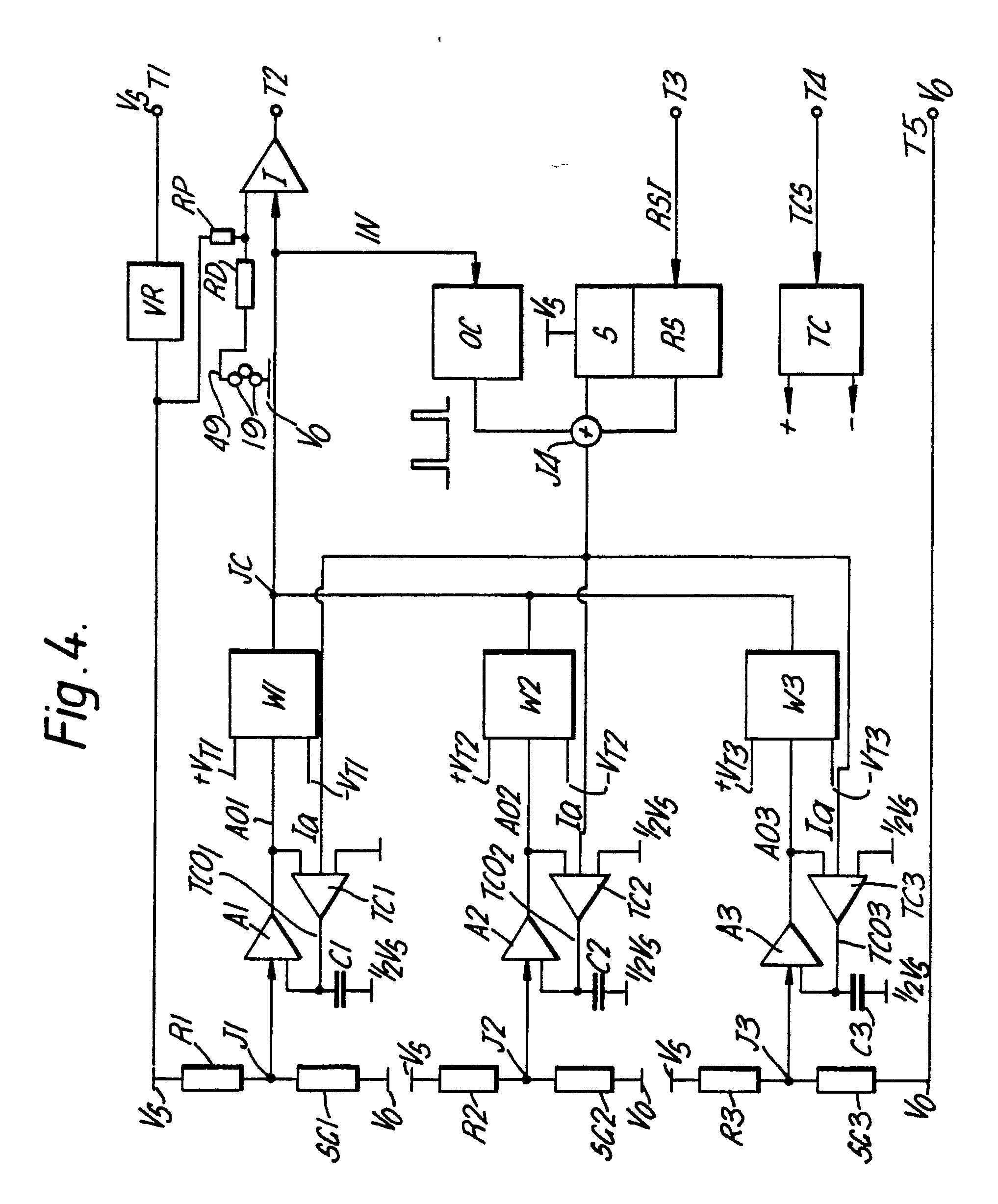

I cannot find any info on internal driver for touch trigger probe, but I have found what appears to be internal driver from strain force gauge probes, and some other information on the renishaw input driver, but still not sure how you would replace the renishaw driver with just a mesa driver board
patents.google.com/patent/US5669151A/en
patents.google.com/patent/US4443946A/en
these ones are for the strain force gauge probe
patents.google.com/patent/US4769919A/en
patents.google.com/patent/EP0388993A1/en
patents.google.com/patent/EP0242710B1/en

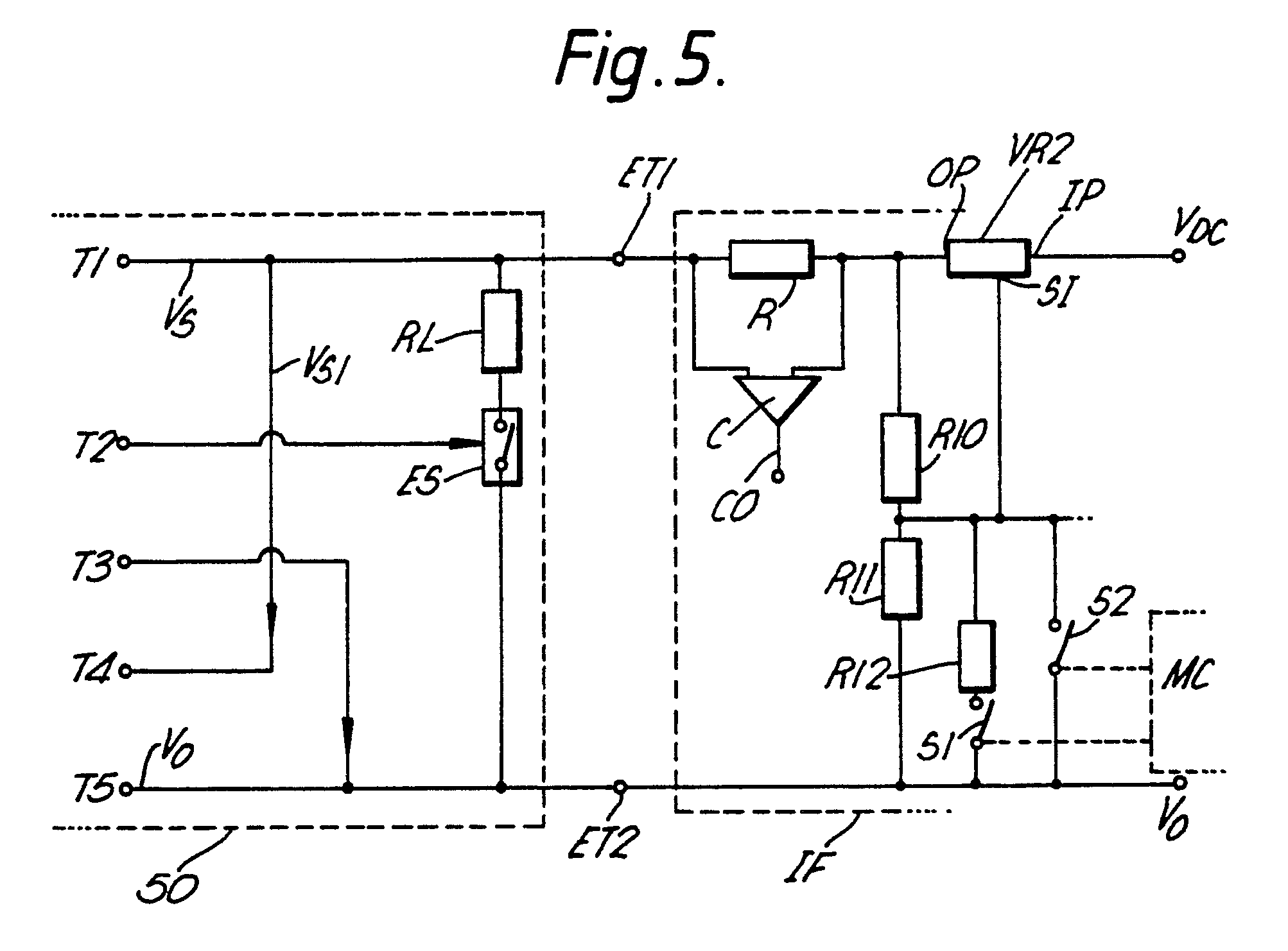

Now, how might one tackle a strain gauge probe? like the TP200
patents.google.com/patent/US5323540A/en
patents.google.com/patent/US5505005A/en
