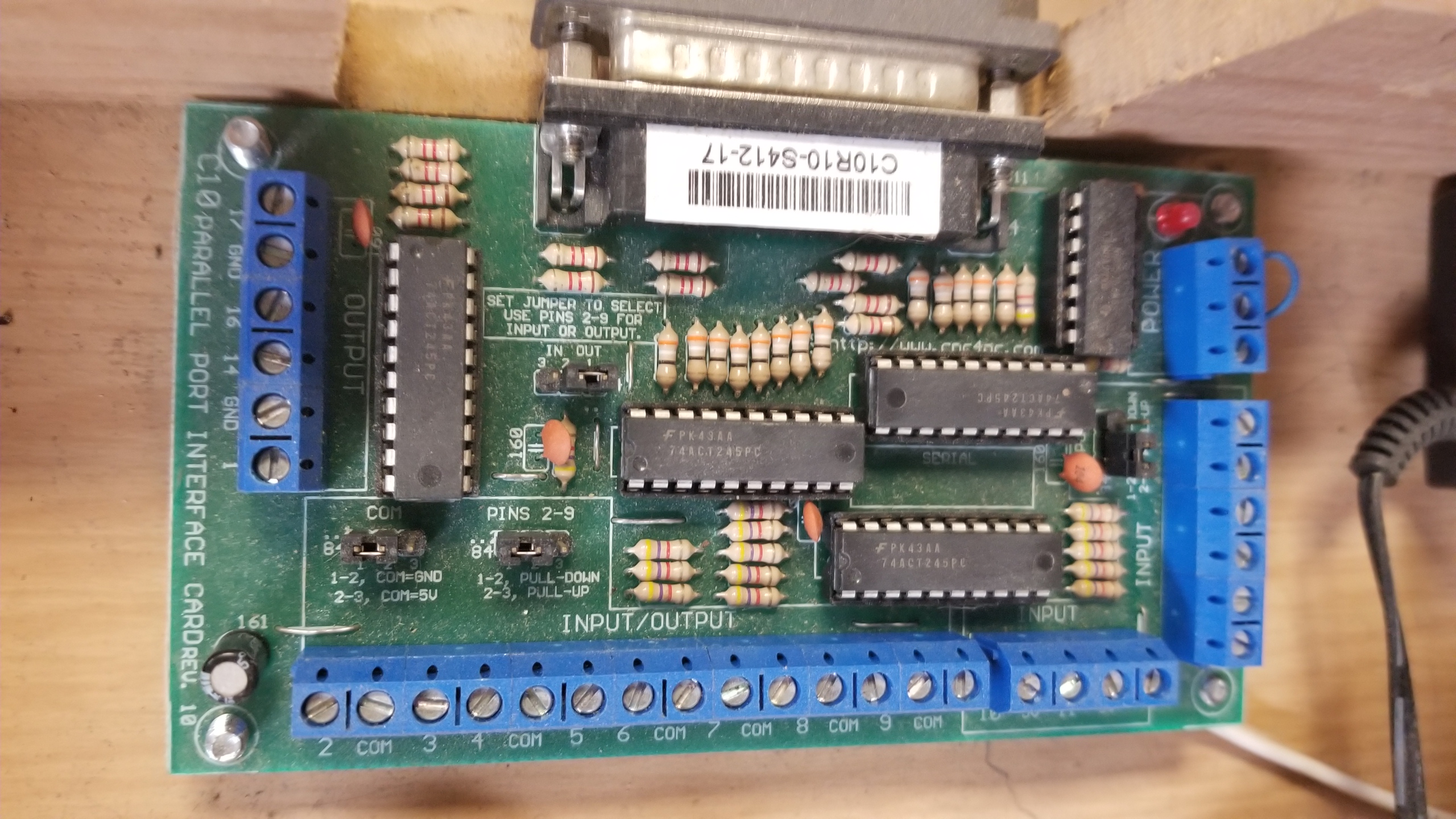

anyone recognize this?
- tater1337
- Posts: 48
- Thank you received: 3
30 Apr 2022 21:06 #241736
by tater1337
anyone recognize this? was created by tater1337

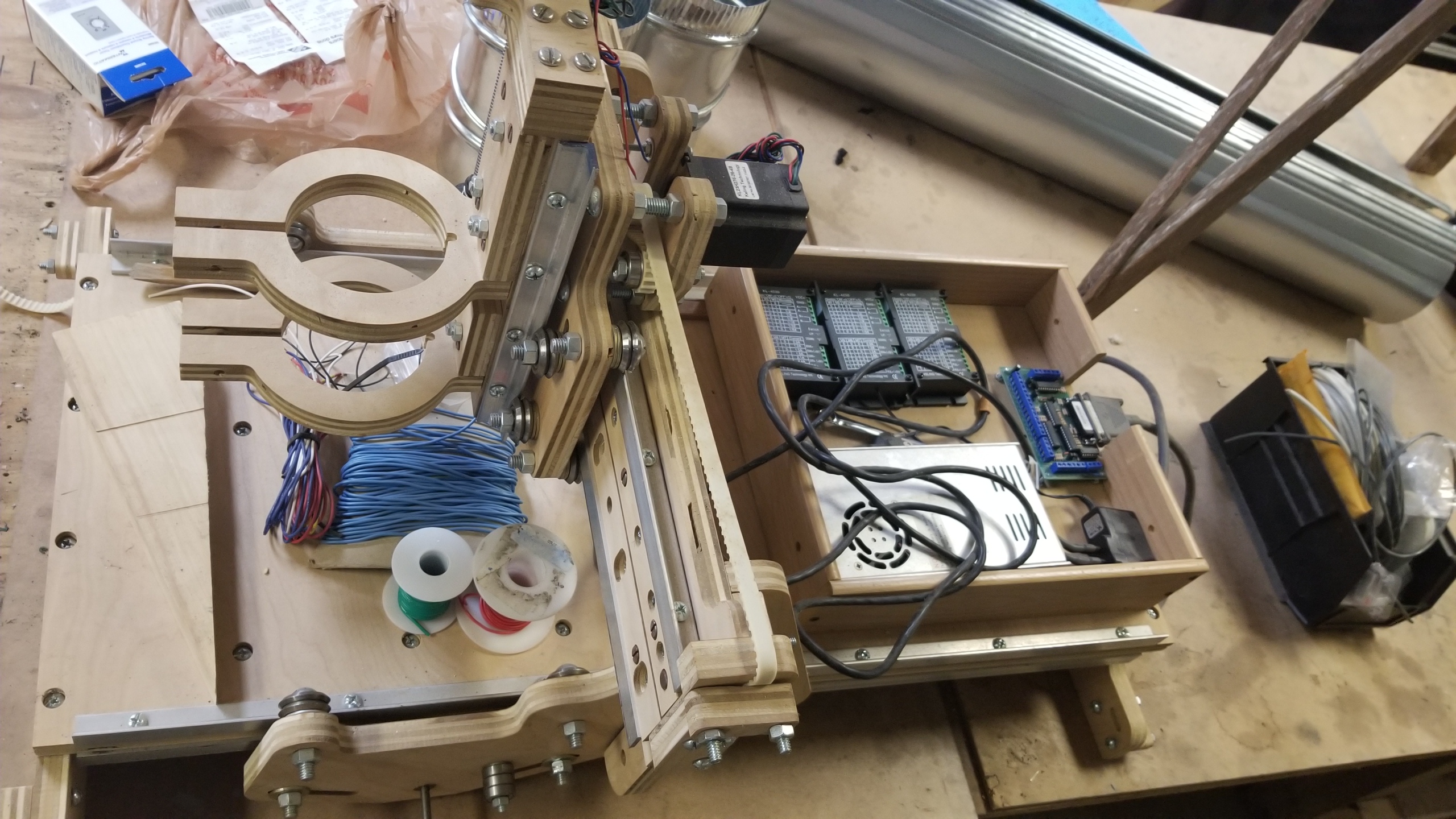

one former member donated this....thing a few years ago, and during a recent cleanup another member announced some interest in reviving this project
so we took an old PC installed linuxCNC, but now I need to know what the interface is
or he does, I pointed to this forum, just trying to get a step ahead of him

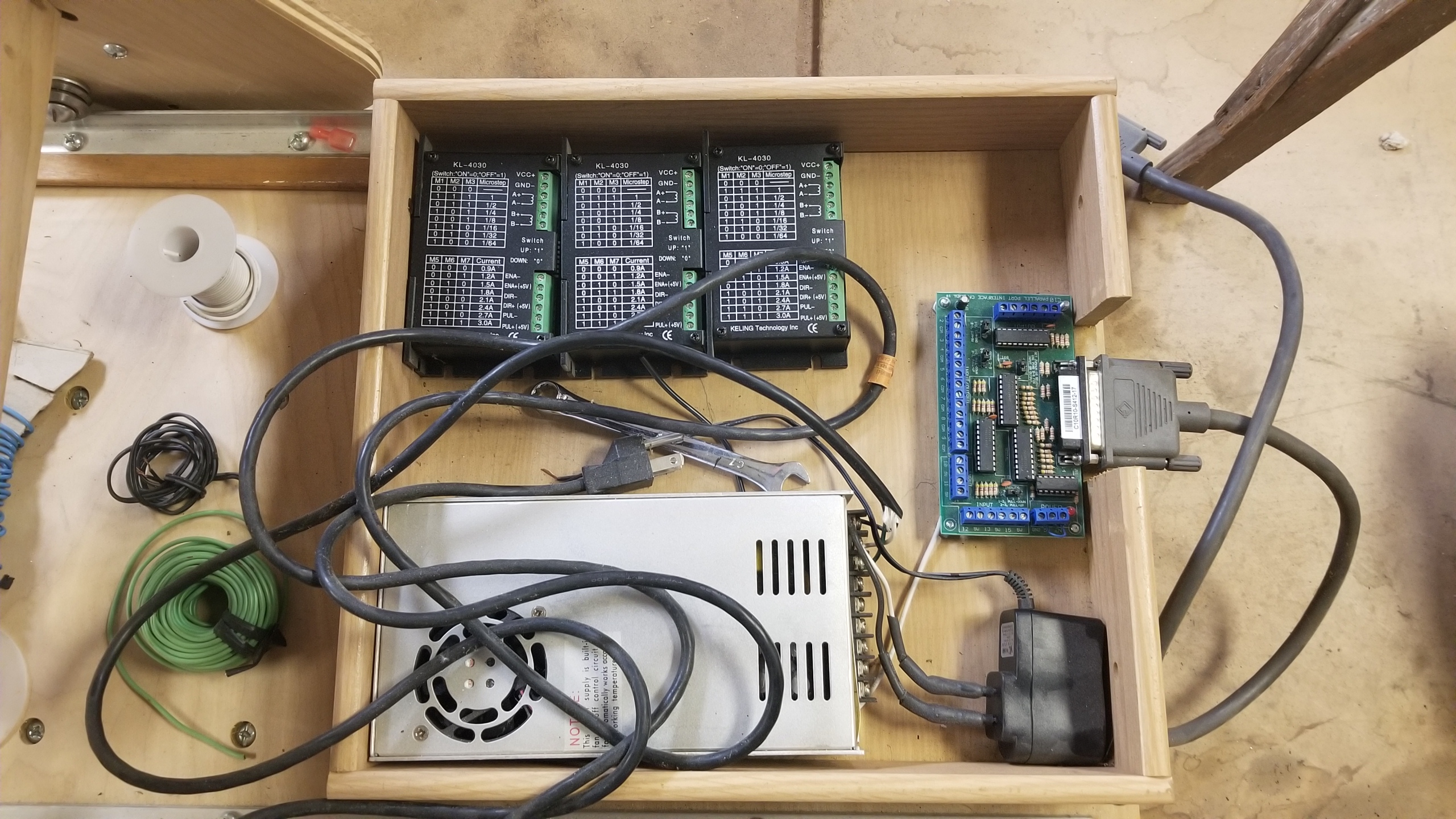

and yes, I am kindly going to chew out the person with the bright idea of hooking up the wall wart like that

its just a standard C10 interface board
That one is from CNC4PC, they are still made:
www.cnc4pc.com/c10-bi-directional-parall...-interface-card.html
They are now used surface mount devices (SMD) components.
if you look under product info there is a load of info, it will all generally be the same as the board you have, just that one is an older board using DIP components
It will just use a standard LPT pinout (pins 1-9, 14, 16 and 17are outputs, pins 10, 11, 12, 13 and 15 are inputs)

I take it linuxcnc will have no problem with it then?
- Posts: 21980
- Thank you received: 7480
01 May 2022 00:54 #241757
Replied by tommylight on topic anyone recognize this?
It should work just fine.

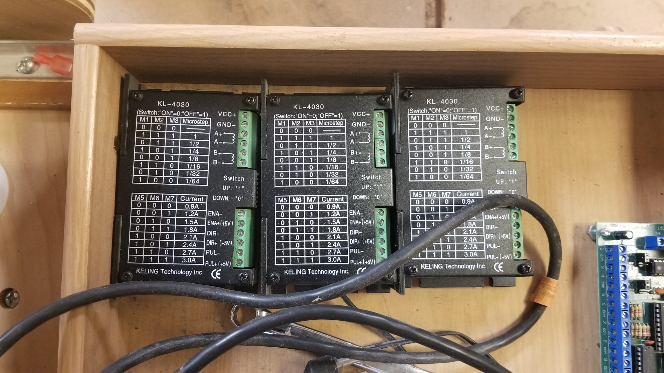

I would suggest if you have an old PC with a parrallel port to just have a go at setting linuxcnc up with a parrallel port.
I don't normally recommend the use of the parrallel port, but if you just want to get some motion first (all you need to do is wired up the stepper motors and stepper motor drives to 6 output pins of the break out board (step + direction for each stepper) and you can get some motion.
most people would use pins 2,3,4,5,6 and 7 for the 3 x axis.
once you get some motion you can then add to it with a mushroom emergency stop (I would highly recommend if you are new to cnc as you'll get it wrong and need a quick "off" button).
and then limit switches and a probe / touch off input.
I have never used the parallel port with cnc (that includes Mach3/Mach4 + linuxcnc), but I believe you will need to install the RTAI kernel.
I don't know how much you know about linuxcnc but I'd suggest just installing from the iso here from a usb memory stick.
Don't worry about upgrading or doing anything out of the ordinary until you get motion and you get used to linuxcnc working.
LinuxCNC 2.8.0 Debian 7 Wheezy RTAI
