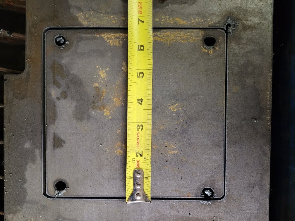

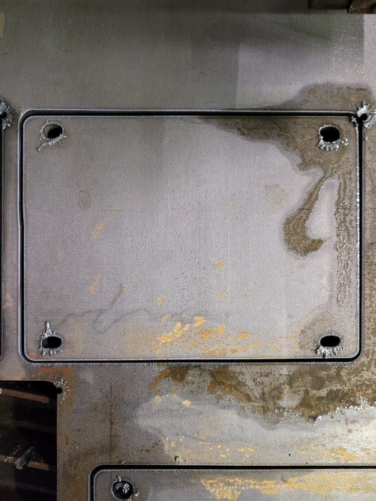

Follow up. I'm still unable to replicate the finishing read/write errors, but I've now had a chance to do some test cuts and they're coming out the wrong shape. Could this be a result of changing the servo period?
It seems that the Y axis (dual motor) is being shrunk. Perhaps missing steps? The issue progressively gets worse if the machine isn't re-homed between jobs.
Attached are two separate files. The first you can see how the bolt holes are oval/oblong, and the second is supposed to be 7" square. It appears this is only happening on the Y axis, but my brother was the one running these jobs and sending me the pictures so can't confirm 100%, but the one cut was dimensionally accurate to 7" along the X axis.
Any ideas?
Any ideas?

Could be mechanical or marginal step timing
(try doubling the STEPLEN parameter and see if anything changes)
Replied by PCW on topic Another 7i96 Error finishing read
No, the number of steps and scaling are independent of the servo period.Could this be a result of changing the servo period?
Any ideas?
If it's consistent check the Y axis scale, if it's random check the smoothness of the Y axis and that there are no sticky spots on that axis however usually if a stepper misses steps due to interference then the stepper stalls and just sits there and hums.
Run a stepper test for each axis as outlined in the documents Configuration > General Info > Stepper Diagnostics.
JT
Last edit: 23 May 2022 11:07 by BigJohnT.

Replied by chadfawcett on topic Another 7i96 Error finishing read
Thanks for all the responses! Sorry for the delay, I don't seem to be notified of followup responses so didn't realize there were more.
It ended up being a hardware issue after all for the Y axis stuff. The grub screw on one of the motor pulleys wasn't tight so it was slipping on the motor shaft. Tightened that back up and everything functions as expected now.
Thanks again for all the replies.
