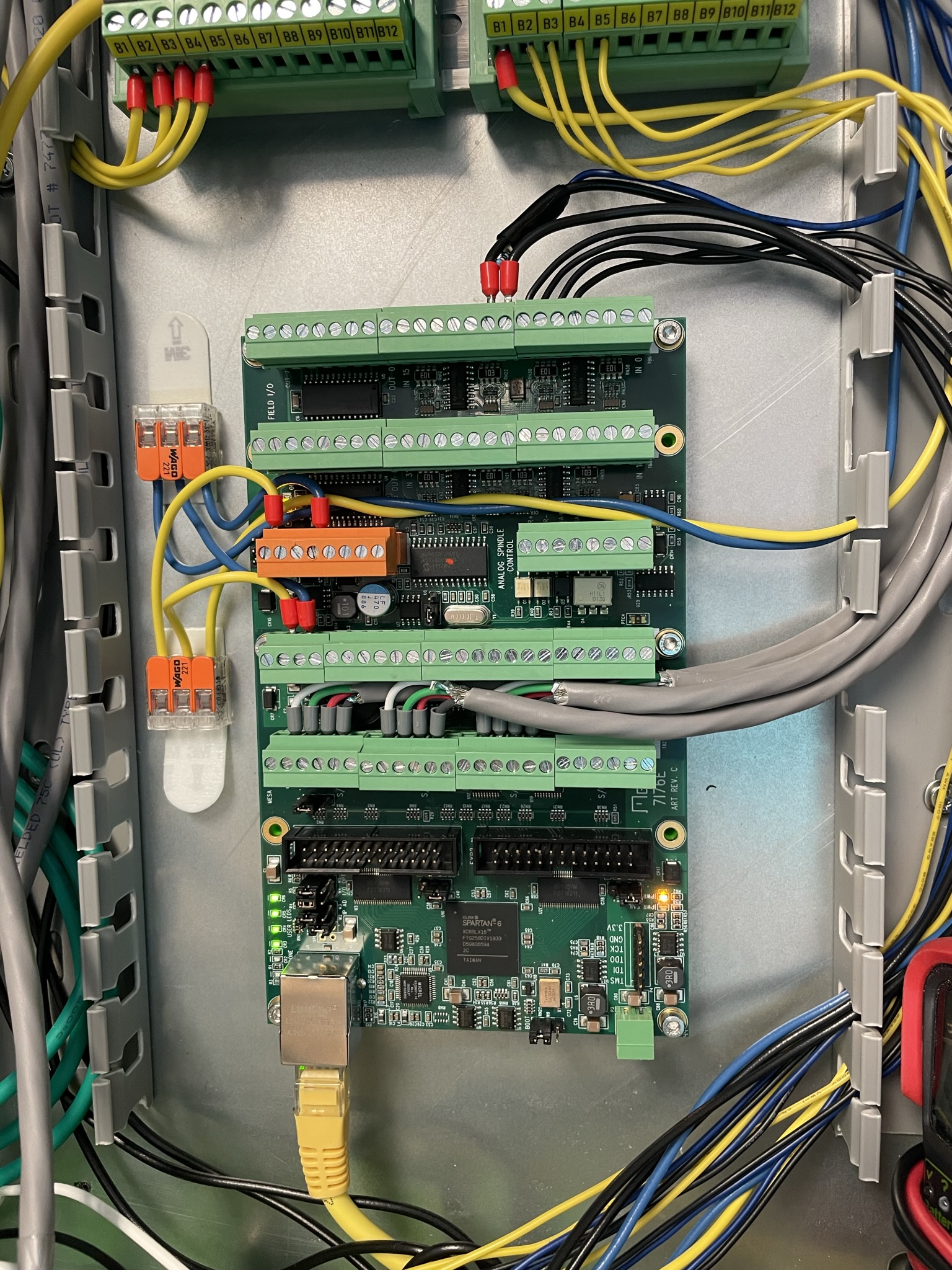

You should really, really isolate those shielding foils, that is an accident waiting to happen ... or already happened.

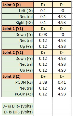

@ PCW: I performed those tests this afternoon. Since the machine must be homed prior to jogging, I went into the INI file and commented out the "HOME_SEQUENCE" numbers. This allowed me to jog without homing, with one caveat: Joint 2 (Y2) - the motor that worked seemingly correctly when homing - is not changing value on the gmoccapy GUI when I try to jog. What I mean is, I do not think Joint 2 is actually being commanded to move with the keyboard. No big deal, I was able to get data for the other three drivers.
The results were as follows:
Another thing I checked was stepper drive voltage (power supply) and confirmed that it is at the nominal 42V.

When you say isolate, you mean to avoid them touching the circuit board on the underside? I checked very carefully today to make sure that has not occurred, and they have a reasonable clearance below. Nonetheless I think that's great feedback and I will wrap the end of the insulation (and the foil) with electrical tape just to be sure.
I did try switching the DIPs back and forth to no avail. I also tried a new driver on the X axis and no change. I think per PCW's recommendation I am confident the drivers are doing what they are told.

That looks to me like the DIR+driver chip is damaged
(Its U19, a 74ACT541)
In any case the + pins must be in the opposite state of the - pins
if this is not the case, its very likely a driver has been damaged.
