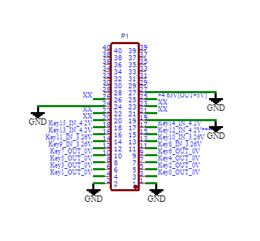

it works now I'm using hot air with RN7 all the input is 3.3v power.
I can watch 4x8 from halshow but still can't set the halfile.

Are you saying that there was a hardware problem that is now fixed, but that you still need help with the HAL configuration?
How far have you got wth the HAL?
If you watch the keycode pin in HAL, does it appear to be showing key-up and key-down events?

That's right, the hardware works.
I can watch the keycode pin in HAL.
but when i connect to jogging it does not respond
Please show an example HAL?

This is just from memory
[/code]
loadrt matrix_kb config=8x8
addf matrix_kb.0 servo-thread
net hm2_.....7i73.00.scancode => matrix_kb.0.keycode
[/code]
At that point you should be able to see one of the output pins toggling on and off when you press the key.
Can you confirm that that part works? (halshow is the easiest way to monitor a lot of pins.
[/code]
[/code]
