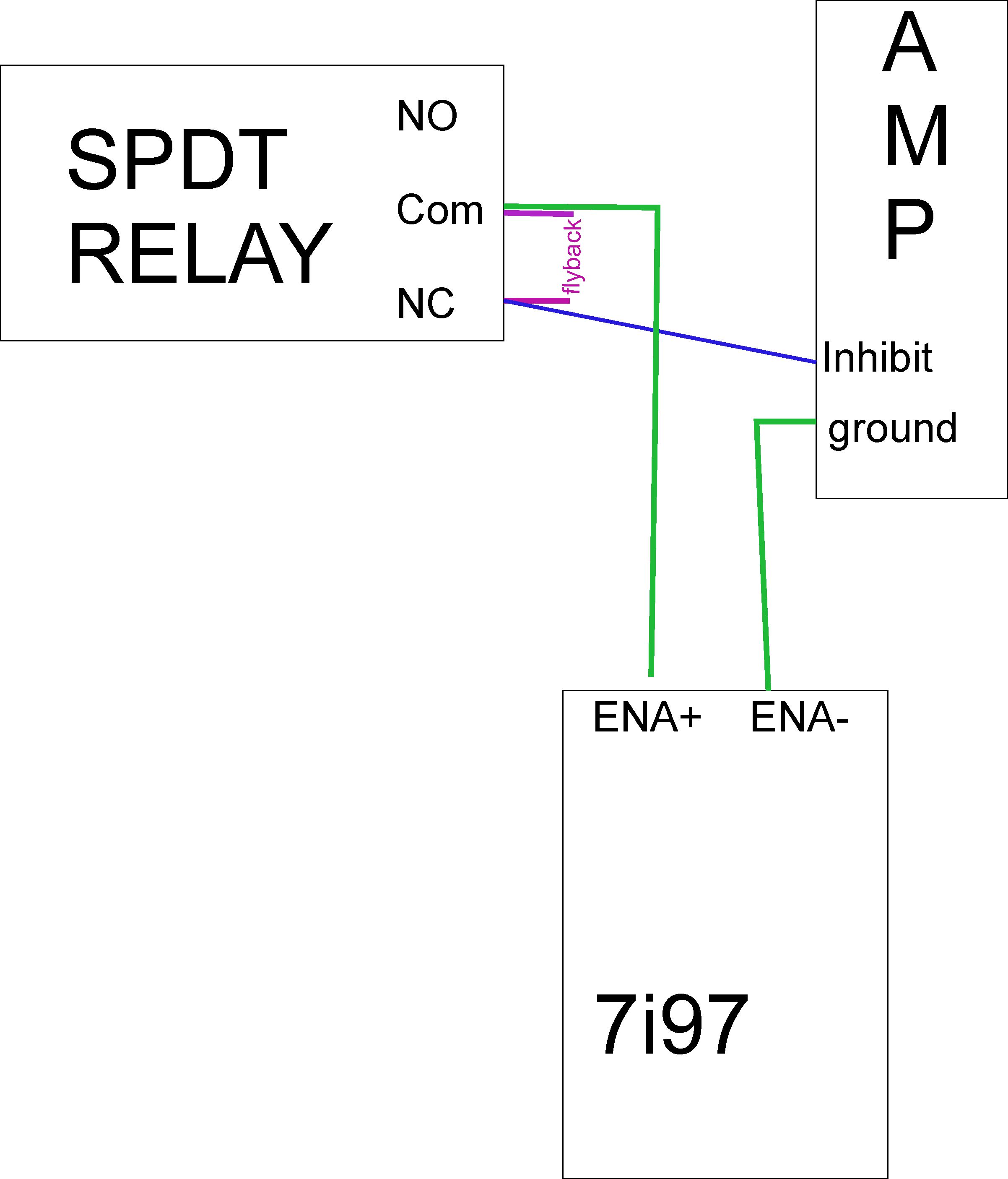

By pulldown resistor I mean an external resistor from the drives inhibit input
to ground. This should disable the drive unless the inhibit input is pulled up
by the enable output or SSR output.
You would need to measure the open circuit voltage (no pulldown resistor)
on the inhibit input to determine the required pullup voltage.
Connections:
V+ --> SSR+
SSR- --> drive inhibit input
Resistor_pin1 --> drive inhibit input
Resisior_pin2 --> drive ground
V+ determined by open circuit inhibit voltage
By SSR I mean one of the 7I97s 6 built in SSRs

12 Jul 2022 15:16 #247155
Replied by PCW on topic 7i97 hookup help
No, there is no power supply involved on the inhibit side
(If grounding the inhibit line disables the drives)
Relay NC ---> Drive Inhibit
Relay COM -->Drive GND

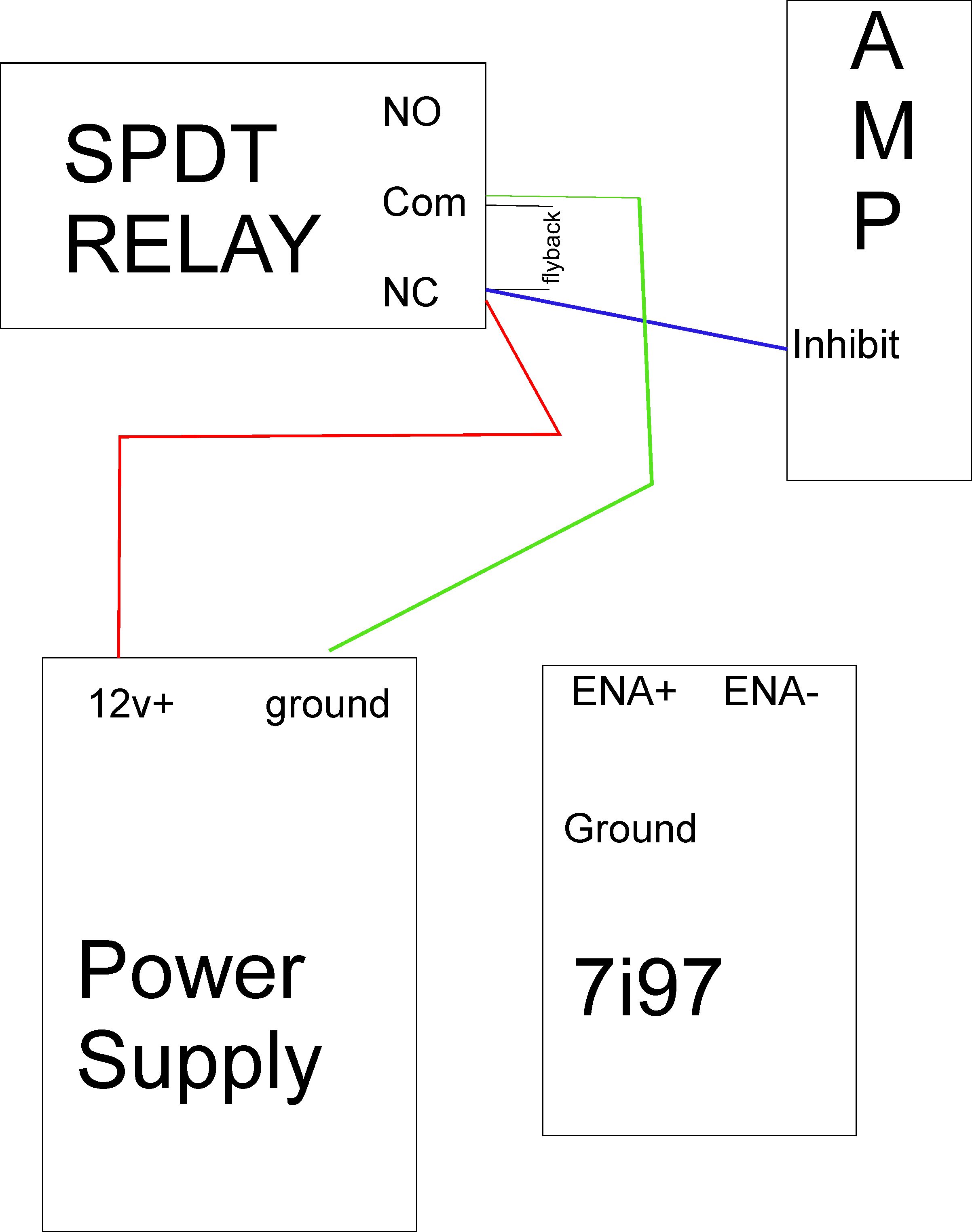

- JPL
- Posts: 337
- Thank you received: 118
12 Jul 2022 16:37 #247162
by JPL
Replied by JPL on topic 7i97 hookup help
And you're are basically shorting your power supply by doing it this way
See: The NC and COM contact from your relay are normally closed (eg. connected together inside the relay) . The full circuit you have is: 12V+ --> Relay NC --> Relay COM --> ground. This is doing the very same as connecting directly the 12v+ to ground (Pouf!!!)... Unless, of course, the relay is being kept activated. (Then Pouf!!! once the relay is deactivated)

- Posts: 18103
- Thank you received: 5326
12 Jul 2022 17:17 - 12 Jul 2022 17:19 #247168
No, the relay NC and COM contacts connect to
the drives inhibit and GND and no flyback diode is used there.
There is no connection at all from the drive to the ENA lines,
the ENA lines are used to drive the relay coil (the relay coil has the flyback installed)
I will try and draw a simple schematic later today

- Posts: 18103
12 Jul 2022 20:02 - 12 Jul 2022 22:53 #247178
Note that diode polarity is critical (band to +12V) , you will damage the 7I97 if it is installed backwards
Note that the relay pin numbers are meaningless unless you are using an identical relay
