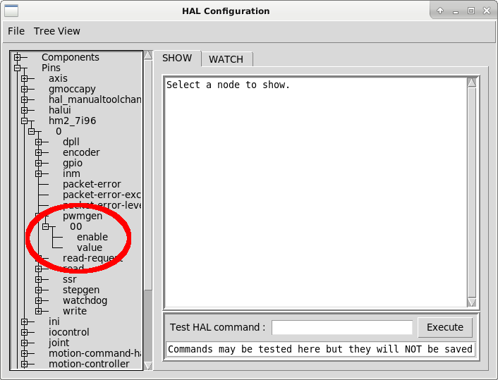

7i96s inverting PWM was created by zz912

Replied by PCW on topic 7i96s inverting PWM
There is no PWM invert pin on the 7I96S local analog PWM (but it is not needed either).
The Analog out PWM on the 7I96S is a "local I/O" pin and is not accessible as GPIO.
The inversion feature is a part of the GPIO functionality.
Note that if you had 7I96S firmware that had an actual PWM output pin (say on the
expansion connector or a step/dir pin), it _would_ have the invert option.
