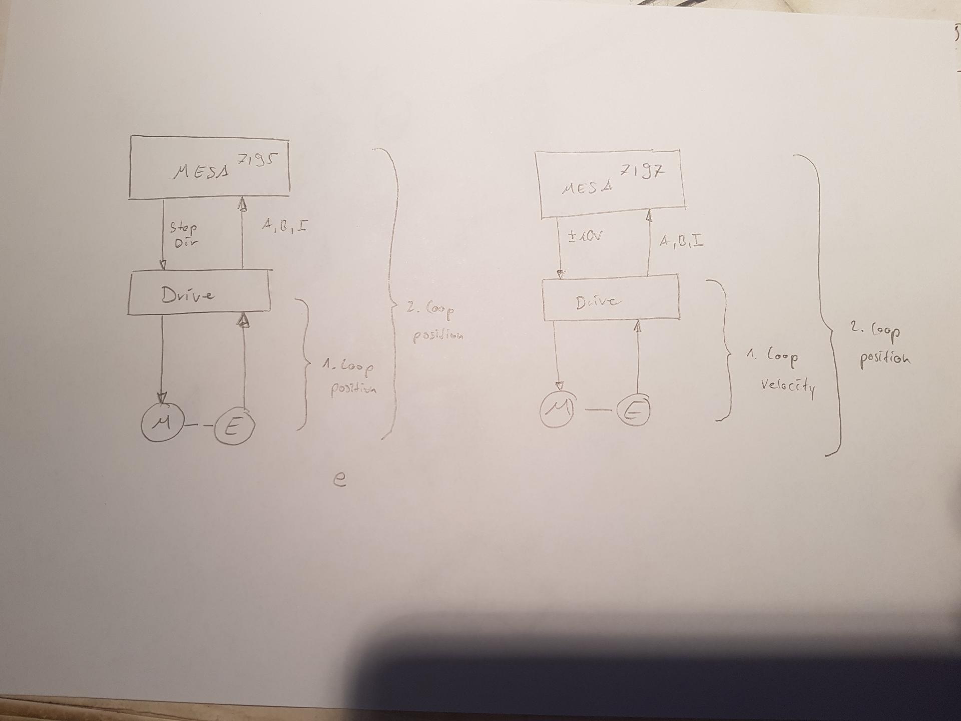

im planning my new mill. I use JMC Drives + Motor. The motor`s encoder has 2500 lines per rev. The ballscrews have 10mm pitch.The gear ratio is 1:1, so i got 1 micron accuracy.
I can use the drive in torque (analog) , velocity (analog) or position mode (step / dir).
I want linuxcnc to close the loop (linuxcnc should know where the axis/joint is)
Now i figured aut 2 configurations for my machine but im not sure about loosing accuracy.
My favorite is to use a Mesa 7i95 so i can easy use a stepper for my toolchanger.
But i think ithat the drive acts like a stepper with 2500 lines per rev - so its maybe not possible to position the axis with the same accuracy like a system with a 7i97 ?
maybe somebody can help me

Pretty sure that both those will work the same as far as precision is concerned, LinuxCNC can drive steppers in velocity mode so i do not think there is any difference.

i think when i use the 7i79/7i95 i can use 4x mode to read the encoder (i got 10000) - so i have a scale of 1000.
but the encoder just can 2500 - so i got a scale of 250 (in position mode)
the drive allows torqe and velocity only with analog setpoint
this is why im think that i need the Mesa with analog setpoint

If the only feedback is at the motors then you might as well close the position loop in the drives.
But it's up to you, you can close it in LinuxCNC if you prefer. It is easier to see what is happenign during tuning that way. Though the tuning might be less effective than the tighter loop at the drive.
