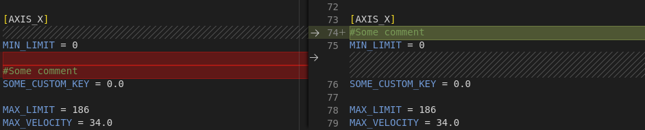

On another note I just finished the new ini2 branch and you can add new comments, sections and key/value pairs and they will be retained the next time you open the ini file. Comments can be indented and use either # or ; at the start of the comment.

29 Sep 2022 10:39 #253018
by JT
Replied by JT on topic Mesa Confguration Tool Update
I'm working on a bug that if a comment is on the line before a section the rest of the comments get out of place because the configparser puts a blank line before each section and that throws the position off for following comments.
Boolean values can be any of 1, true, True, yes, Yes or 0, false, False, no, No even though the docs fail to mention that.
