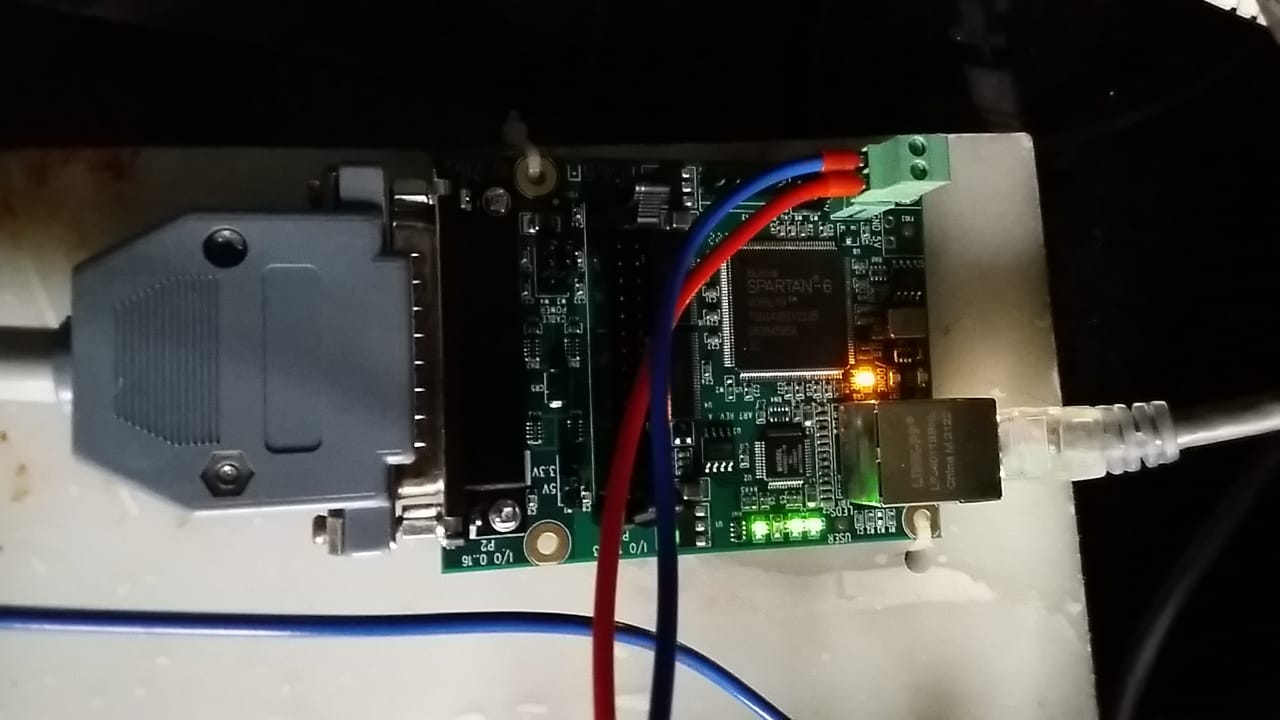

I completed power connections.

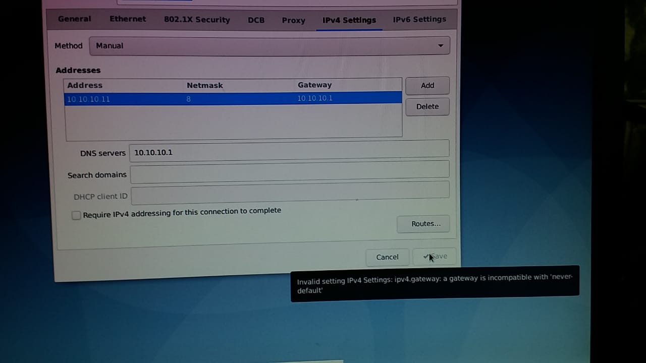

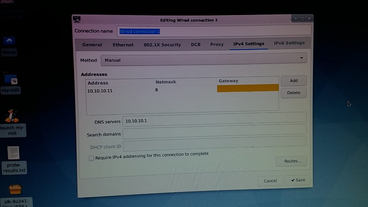

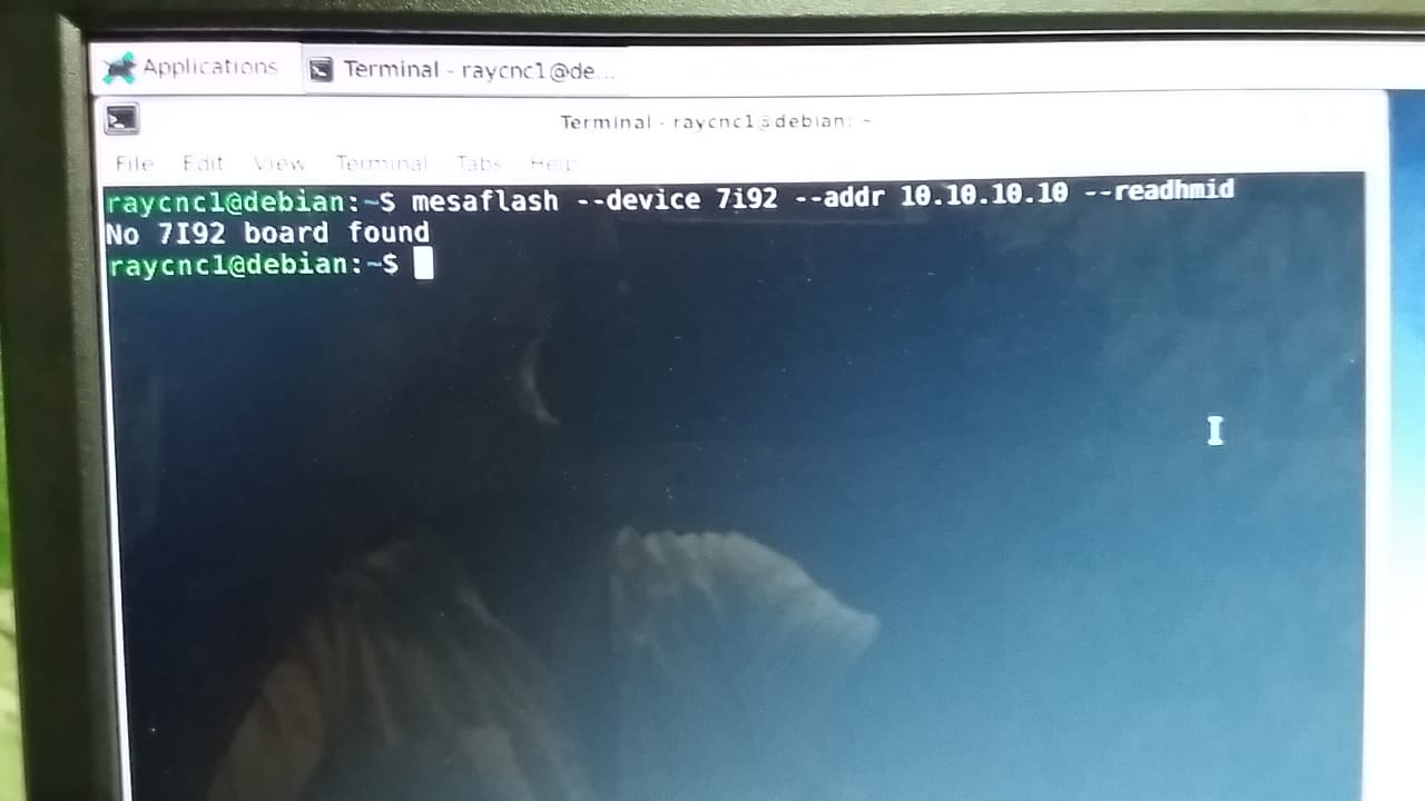

But stuck in Network..I followed this thread
forum.linuxcnc.org/27-driver-boards/3559...ethernet-mesa-boards
but on ping, its a failure. "From 10.10.10.11 icmp_seq=1 Destination Host Unreachable" Refer attached file.
upon terminal command "mesaflash --device 7i92 --addr 10.10.10.10 -readhmid", resulted " No 7i92 board found". Refer attached file.
7i92 connected with 5VDC (4.99 VDC on measurement) power, LED status are as per attached photo and video.
All 7i92 jumpers are in default position.
What to do??

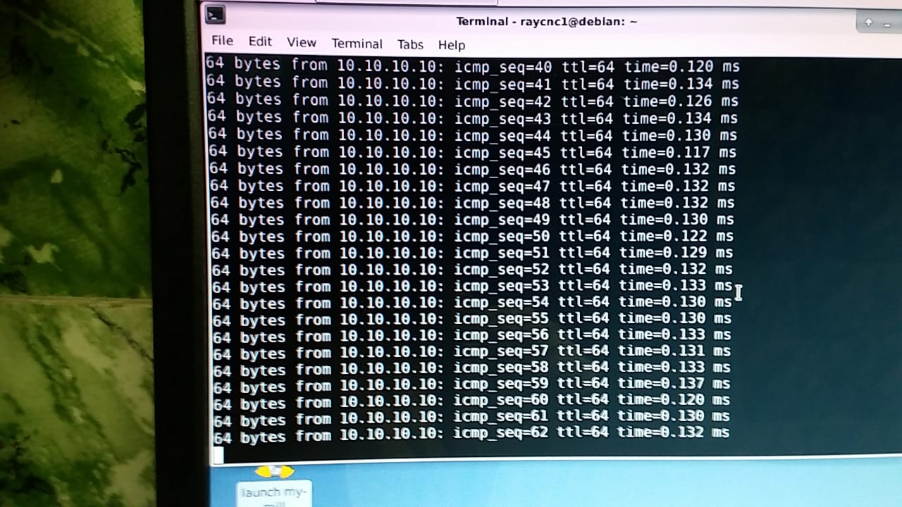

- Clive S
- Posts: 2204
- Thank you received: 486
14 Aug 2022 07:37 - 14 Aug 2022 07:41 #249702
by Clive S
Replied by Clive S on topic 7i92 + 7i76 + 7i84
I think the default I.P. is in the 192.168.1.121 ish
So you have to set the jumper to the 10.10.10.10 range (its is shown in the manual)
W6 should be up
www.mesanet.com/pdf/parallel/7i92man.pdf
W6 should be up
Last edit: 14 Aug 2022 07:41 by Clive S.
- rajsekhar
- Posts: 206
- Thank you received: 12
14 Aug 2022 08:08 #249704
by rajsekhar
Replied by rajsekhar on topic 7i92 + 7i76 + 7i84
Thank you. W6 made Up and problem solved. Its pinging, attached photo. Hope it is ok.
