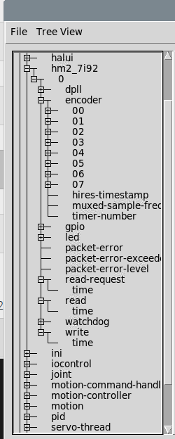

I'm having trouble getting smart serial setup with the combination of mesa cards: 7i92->7i85->7i83
I have the 7i92 flashed with: "sudo mesaflash --device 7i92 --addr 10.10.10.10 --write 7i92/configs/hostmot2/7i92_7i85x2D.bit"
readhmid shows 2 serial interfaces on my 7i92 now. But when I launch linuxcnc halshow does not show any downstream devices and I get yellow lights on the 7i85, 7i83. It does show
I made my cables per the manual instructions and verified that the cable end is wired with T568B pinout.
I've tried everything I can think of but this is my first setup with multiple mesa boards and its entirely likely I'm missing something basic here..

Do you have the 7I83's VIN supplied?

I have 5v power going to the 7i92 and the jumpers on the 7i92 W3,W4 are in the up "breakout power enabled" setting. I do get yellow LEDs lighting on the 7i85,7i83 boards.

Sounds like you do not have VIN power to the 7I83 (on TB1)

Ah yup that was it! I was thinking I would see something in halshow for the 7i85 so had not turned my attention to the 7i83.
