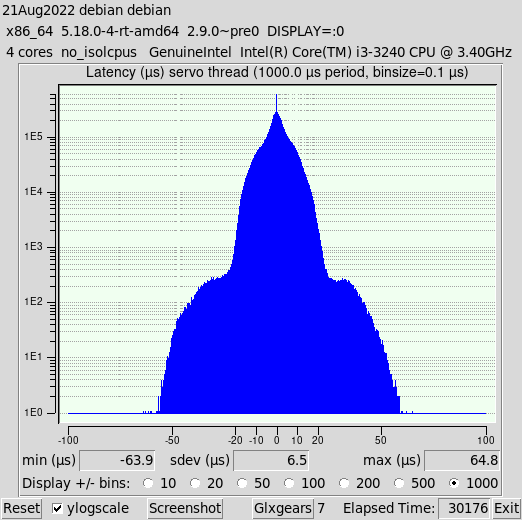

Hi guys, I have an Intel i3 All in one touchscreen PC thats getting the dreaded "error finishing read" fault.
I'm wondering if there are any other things I can do to resolve this as the PC has decent overnight latency
CPU: Intel(R) Core(TM) i3-3240 CPU @ 3.40GHz
RAM: 8 Gb
NIC: RTL8111/8168/8411 PCI Express Gigabit Ethernet Controller
NIC Driver = r8168 (I changed from r8169 default as I heard it could be buggy)
OS: Debian Bookworm: SMP PREEMPT_RT Debian 5.18.16-1 (2022-08-10)
GUI: Default Debian GUI not XFCE

Can you post the results of
halcmd show param *.tmax
after LinuxCNC has run for a while?

Replied by rodw on topic another 7i76e error finishing read question
Yeh, I did that. The 7i76e TMAX is up over 3000000.
I'll post it up this evening becasue the machine is at home.

>>>>>36 s32 RW 5094432 hm2_7i76e.0.read.tmax
Yeah, 5094432/3.4G = ~1.5 ms,
so the Ethernet latency is definitely terrible.
Does the PC have an Intel MAC?
If so have you turned off IRQ coalescing?

22 Aug 2022 20:45 #250227
The NIC is a Realtek RT8111 so not intel. I know somebody else who has trouble with this NIC and gave up on a similar machine.
I did try coalescing but it did not seem to make any difference so I took it out.
I might try on Bullseye instead of bookworm.
