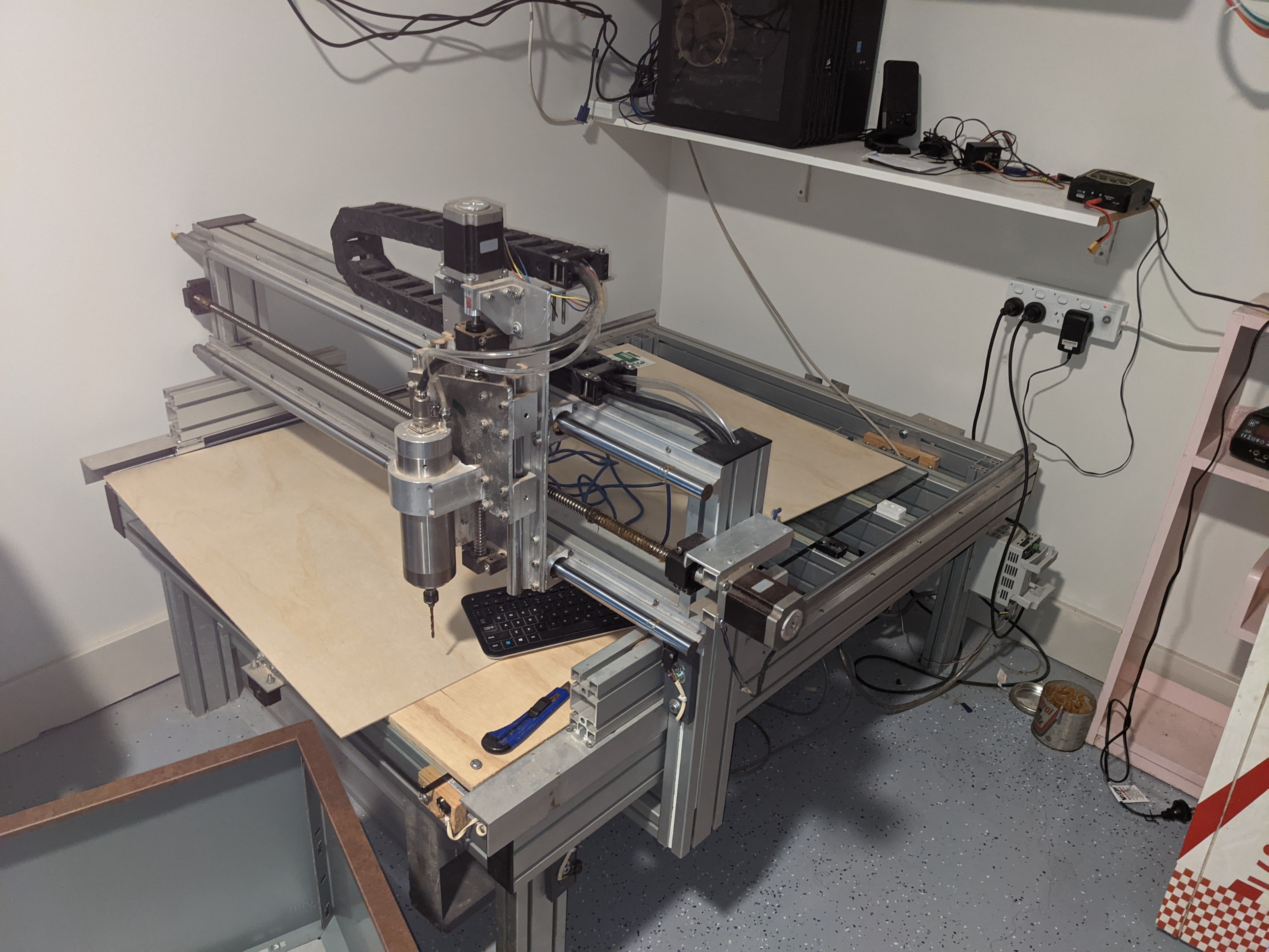

28 Jan 2023 08:44 - 28 Jan 2023 09:16 #263062
by SrLange61
Replied by SrLange61 on topic Driver+Firmware+PCB for Pi RP2040 PIO (i.e. an easy-to-configure FPGA-like card)
I would be interested if this was developed. My CNC runs a Gecko540 from the parallel port of a old over clocked Hasswell computer. Having more modern hardware options would be great. I’ve looked at driver boards but the postage from the US to Australia almost doubles the price and now the Raspberry pi4 has taken over.
srl

28 Jan 2023 13:07 #263079
Replied by tommylight on topic Driver+Firmware+PCB for Pi RP2040 PIO (i.e. an easy-to-configure FPGA-like card)
Find a shop that sells used PC in AU, the "Enterprise" type of PC's made by HP had add on parallel cards.
Mostly PCI but new-ish ones also had PCI-E although not as often as PCI.
I got several for free once.
- Posts: 12156
- Thank you received: 4149
28 Jan 2023 13:38 #263082
Or you could get a Mesa 7i92 for your G540 and hang the expense.... Seems like they have stock of some variants
Replied by rodw on topic Driver+Firmware+PCB for Pi RP2040 PIO (i.e. an easy-to-configure FPGA-like card)
You should be able to get them on FB market place for < AUD $100 HP or dellFind a shop that sells used PC in AU, the "Enterprise" type of PC's made by HP had add on parallel cards.
