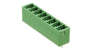

I'm looking to make a little PCB with a power rail and a bunch of pull up resistors on it and I'd like to use the same terminal blocks as whats on the MESA cards. Anybody know what those are called or what vendor? I've tried searching on mouser and digikey but can't quite seem to find the right parts.
Alternatively if anybody knows of a smarter way to interface a bunch of short-to-ground prox switches and push buttons to a 7i84 I'd be all ears on that too. My current plan is I'm going to use a mesa terminal strip gizmo and a bunch of 1/4 watt resistors crimped to wires with shrink tubing for testing. Then teach myself easyEDA to design a similar thing but with surface mount resistors tidy'd up.

What specific parts do you need?

Phoenix catalog for PCB terminal blocks and connectors here: www.phoenixcontact.com/assets/downloads_...S_COMBICON_LoRes.pdf

You guys rock.
I think this is the plug component:
www.phoenixcontact.com/en-us/products/pc...-35-1862865?type=pdf
I can track down the matching PCB header from there. Theres tons of options for these terminal blocks and the mesa ones are nice so I figured I'd go with what I know works.
