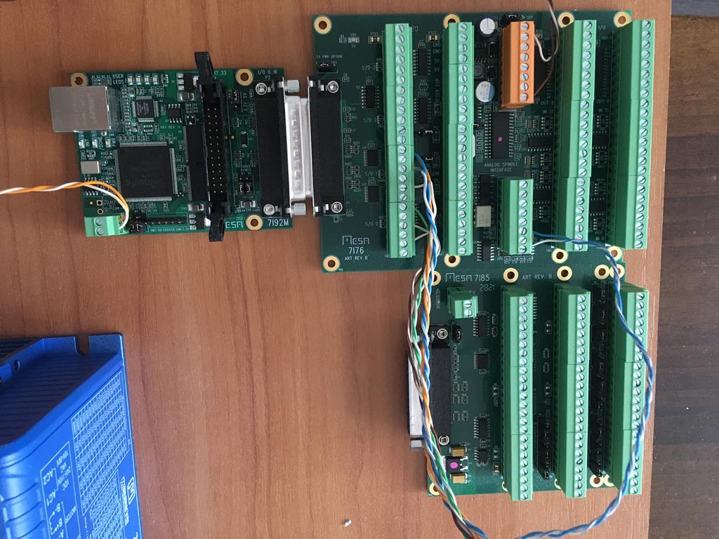

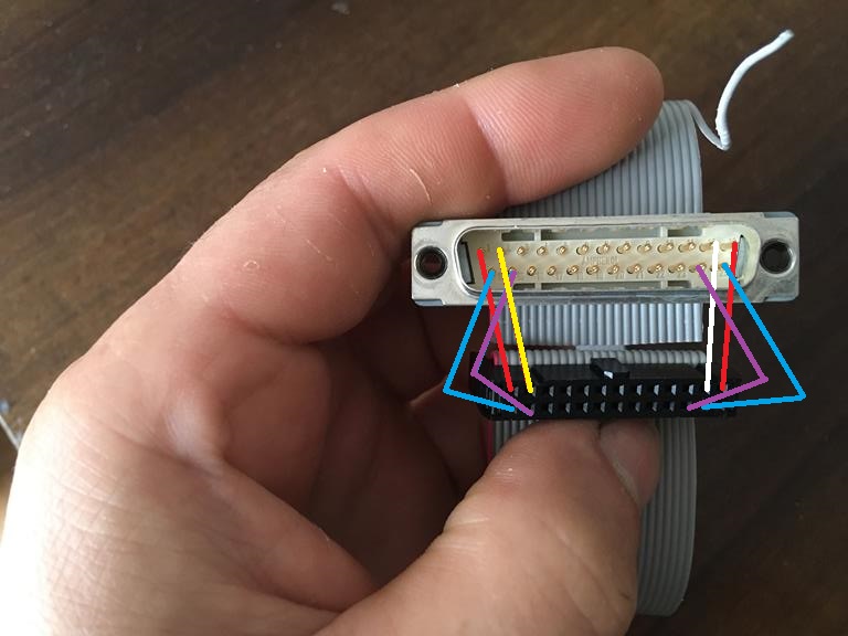

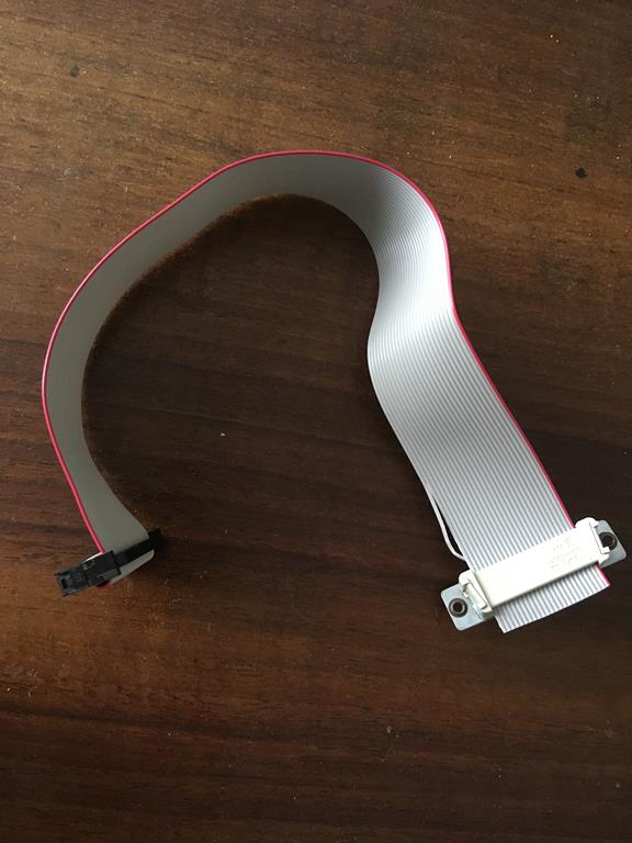

start to connect this setup for my lathe.
First problem about wiring
7i92 connect to 7i76 without problem.
But 7i92 to 7i85S I have problem. Buy separatery idc connector with cable and Dsub for connect with them.
Please look the foto and tell me this connection is ok?
- Posts: 18025
- Thank you received: 5295
10 Sep 2022 13:18 #251613
Replied by PCW on topic Mesa 7i92+7i76+7i85S
That looks correct, what problem do you have?

I connected and for now all working.
