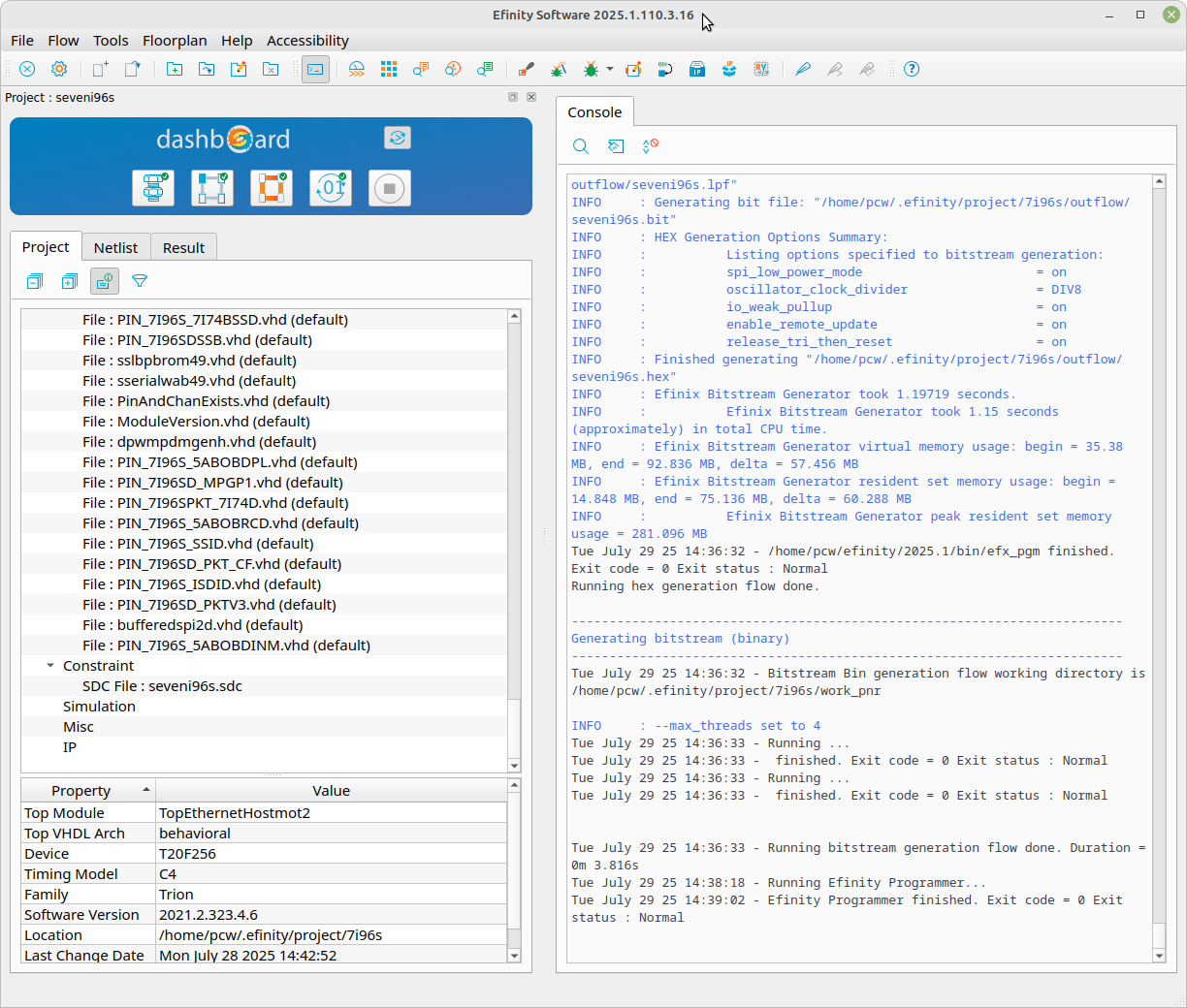

I tried efinity 2025.1.When I try to open the project seveni96s.xml i get the error:
The previous synthesis run has failed. To avoid potential problems or unreliable data, please run it again.
I click O then I get the message:
The family or device maybe invalid. Click OK to proceed with default family and device. Click Cancel to close project and abort.
Then I click OK the next message:
Encounter internal error. Please get help from support team
What does this all mean ? Do I have to choose a family or device first ?
I`m working on xubuntu 24.04
Do you have any suggestions ?

I'll try with 2025.1 today
Did you apply the 2025.1 patch?

The release notes say that Ubuntu 24.04 is supported, and the issue you had looks
like a problem with the XML project file, so I'm not sure whats going on.
Did you apply the latest patch?
If I get a chance, I can post a 7I96S Efinity 2025.1 project file
( I'll change something so the IDE re-writes the file )

Hello PCW,
Your advice was right. I applied the 2025.1 patch an everything went as expected.
Efinity 2025.1.110.3.16 works fine on ubuntu 24.04.
I can edit the files, change them and flash my 7i96s wit the expected result.
Thank you very much
Thank you very much

Glad it's working, I just automatically applied the patch.
The patch docs don't mention any project file
incompatibilities but that's what seems to have
been the issue.
