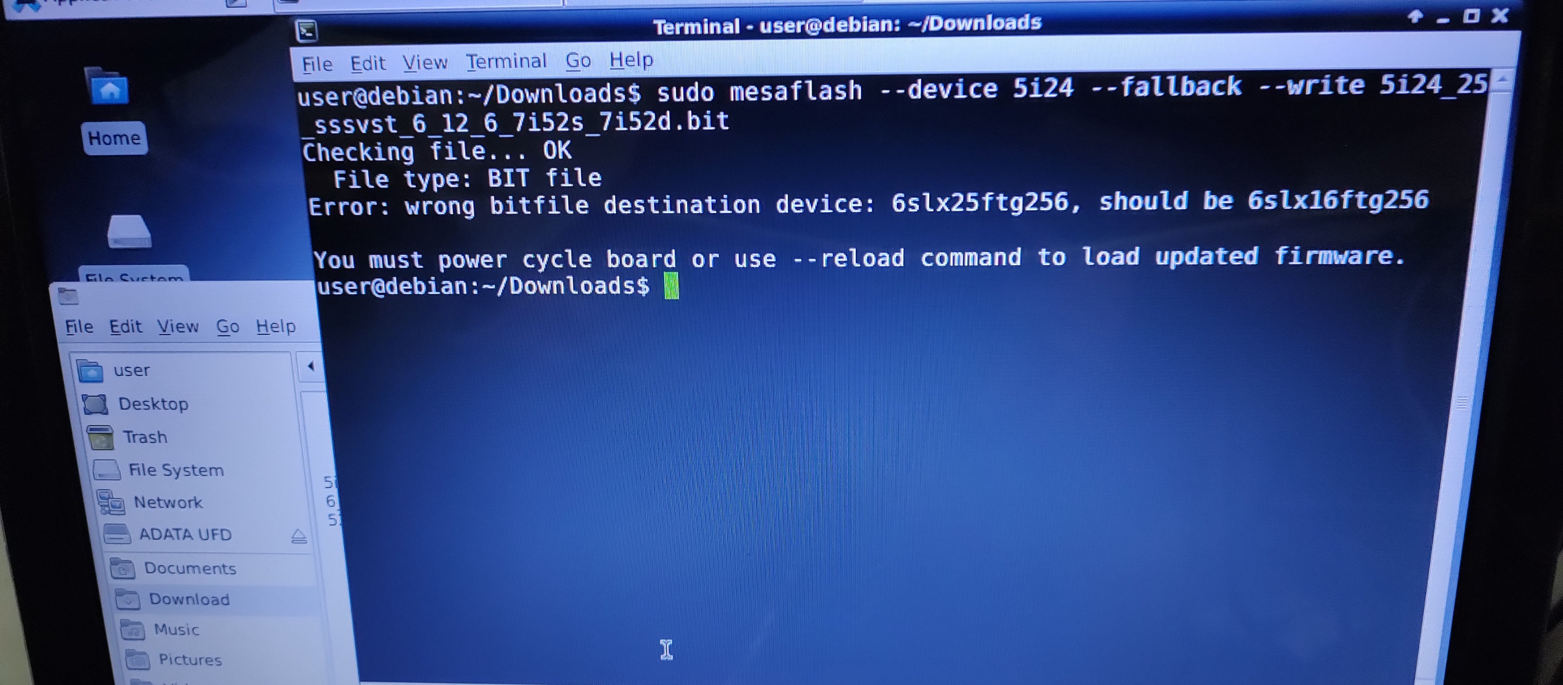

Greetings all!!!!
today I was trying to setup mine 5i24+5i52s+5i52 and accidentally i flashed 16k gate file in 25k gate file and so I tried power cycle as mentioned in manual but now both red and red lights are on all time and not able find board it's shows error 5i24 not found and is any way to recover it ?

now i am trying to flashing 5i24_25_svst6_6_7i52s.bit giving error as following
Checking file... OK
File type: BIT file
Error: wrong bitfile destination device: 6slx25ftg256, should be 6slx16ftg256
i think this firmware is for 16k gate
Checking file... OK
File type: BIT file

To recover, I would:
1. Move jumper W7 down (which selects the alternate EEPROM)
and then power cycle
2. Now with the system powered up, move W7 back up and
re-write the correct firmware

but it shows following error:
Checking file... OK
File type: BIT file
Third i am not able to get basic HAL file for 5i24 due to its not available in pncconf wizard so could you provide basic example as above combo and which bit file should i use ?
Thank you so much

and trying to flash 5i24_25_svst6_6_7i52s.bit from www.mesanet.com/software/parallel/5i24.zip
Checking file... OK
File type: BIT file
Thank you so much
- Posts: 18100
- Thank you received: 5326
20 Sep 2022 16:51 #252416
Replied by PCW on topic Mesa 5i24-25 stucked
Did you do what I suggested with W7?
- yrsiddhapura
- Posts: 134
20 Sep 2022 17:33 - 20 Sep 2022 17:45 #252418
by yrsiddhapura
Replied by yrsiddhapura on topic Mesa 5i24-25 stucked
Yes once when i accidentally flashed 16K gate Firmware after that i tried to recover as mentioned in manual book but after that it was showing error that board not found and then i tried once again but no result. Then i tried recover and reload command but again no result after that when i power up system(Not moved jumper it was up position at that time) suddenly both LED are turned off and i was able to read board
Is mine connection as mentioned above post to 7i52s to drive are correct and which firmware would work for 5i24-25+7i52s+7i52 ?

- Posts: 18100
20 Sep 2022 19:26 #252435
Here is a bitfile for a 5I24-25 with a 7I52S and a 7I52
You should be able to get the pinout with
sudo mesaflash --device 5i24 --dbname1 7i52S --dbname2 7i52 --readhmid
The following user(s) said Thank You: yrsiddhapura

- Posts: 18100
21 Sep 2022 04:45 #252462
Did you power up with W7 down, move W7 up (under power) and try
reprogramming the card?
