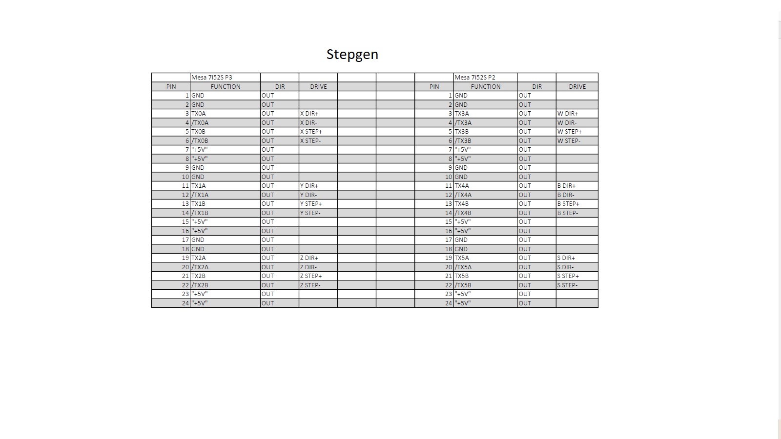

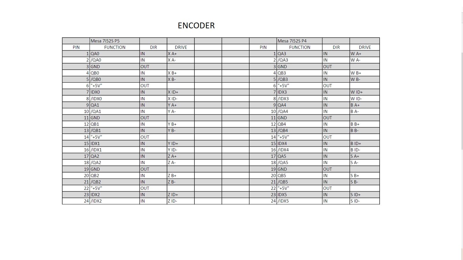

PCW thank you so much its looklike its working perfectly

Module: MuxedQCount
There are 12 of MuxedQCount in configuration
Version: 4
Registers: 5
BaseAddress: 3600
ClockFrequency: 33.333 MHz
Register Stride: 256 bytes
Instance Stride: 4 bytes
Module: MuxedQCountSel
There are 1 of MuxedQCountSel in configuration
Version: 0
Registers: 0
BaseAddress: 0000
Module: SSerial
There are 1 of SSerial in configuration
Version: 0
Registers: 6
BaseAddress: 5B00
Instance Stride: 64 bytes
Module: StepGen
There are 6 of StepGen in configuration
Version: 2
Registers: 10
BaseAddress: 2000
Module: LED
There are 1 of LED in configuration
Version: 0
Registers: 1
BaseAddress: 0200
Configuration pin-out:
IO Connections for P4 -> 7I52S
Pin# I/O Pri. func Sec. func Chan Sec. Pin func Sec. Pin Dir
P2-5,6:/Ena 0 IOPort None
P5-1,2,9,10 1 IOPort MuxedQCount 0 MuxQ-A (In)
P5-4,5,12,13 2 IOPort MuxedQCount 0 MuxQ-B (In)
P5-7,8,15,16 3 IOPort MuxedQCount 0 MuxQ-IDX (In)
P5-17,18,P4-1,2 4 IOPort MuxedQCount 1 MuxQ-A (In)
P5-20,21,P4-4,5 5 IOPort MuxedQCount 1 MuxQ-B (In)
P5-23,24,P4-7,8 6 IOPort MuxedQCount 1 MuxQ-IDX (In)
P3-9,10,17,18 7 IOPort MuxedQCount 2 MuxQ-A (In)
P3-12,13,20,21 8 IOPort MuxedQCount 2 MuxQ-B (In)
P3-15,16,23,24 9 IOPort MuxedQCount 2 MuxQ-IDX (In)
Internal-EncMux 10 IOPort MuxedQCountSel 0 MuxSel0 (Out)
P2-21,22 11 IOPort StepGen 5 Step/Table1 (Out)
P2-19,20 12 IOPort StepGen 5 Dir/Table2 (Out)
P2-13,14 13 IOPort StepGen 4 Step/Table1 (Out)
P2-11,12 14 IOPort StepGen 4 Dir/Table2 (Out)
P2-5,6 15 IOPort StepGen 3 Step/Table1 (Out)
P2-3,4 16 IOPort StepGen 3 Dir/Table2 (Out)
P3-21,22 17 IOPort StepGen 2 Step/Table1 (Out)
P3-19,20 18 IOPort StepGen 2 Dir/Table2 (Out)
P3-13,14 19 IOPort StepGen 1 Step/Table1 (Out)
P3-11,12 20 IOPort StepGen 1 Dir/Table2 (Out)
P3-5,6 21 IOPort StepGen 0 Step/Table1 (Out)
P3-3,4 22 IOPort StepGen 0 Dir/Table2 (Out)

Is positive (step+,dir+) and negative (step-,dir-) connection s are good to go ???
Last edit: 23 Sep 2022 03:48 by yrsiddhapura.
- Posts: 18100
- Thank you received: 5326
23 Sep 2022 13:59 #252615
Replied by PCW on topic Mesa 5i24-25 stucked
They look right if that's what you are asking.
In general, I would use differential wiring for servo drives
with high step rates and single ended wiring for standard
step motor drives with optocoupled inputs:
Differential:
7I52S Step+ --> Drive Step+
7I52S Dir+ --> Drive Dir+
7I52S Step- --> Drive Step-
7I52S Dir- --> Drive Dir-
Single Ended:
7I52S +5V --> Drive Step+
7I52S +5V --> Drive Dir+
Differential:
Single Ended:

Well yes I am going with differential option but i was confused with manual book coz I have worked with 7i76e where manual clearly says step+, dir+, step+, step- but 7i52s says, TX0A, /TX0A, TX0B, /TX0B so i am considering as
PULS+ is TX0A
PULS- is /TX0A
SIGN+ is TX0B
SIGN- is /TX0B
Is that right ?
PULS+ is TX0A
PULS- is /TX0A
SIGN+ is TX0B
SIGN- is /TX0B
Is that right ?
- Posts: 18100
23 Sep 2022 16:10 #252624
Actually (as described in the 7I52S manual) its:
PULS- is TX0A
PULS+ is /TX0A
SIGN- is TX0B
SIGN+ is /TX0B
PULS- is TX0A
PULS+ is /TX0A
SIGN- is TX0B
SIGN+ is /TX0B
The following user(s) said Thank You: yrsiddhapura

Well thank you so much you just save me i have to change connection. Then it would be same in encoder connections too ?
Last edit: 23 Sep 2022 16:38 by yrsiddhapura.
- Posts: 18100
23 Sep 2022 16:37 #252626
The encoder polarity is basically "dont-care"
