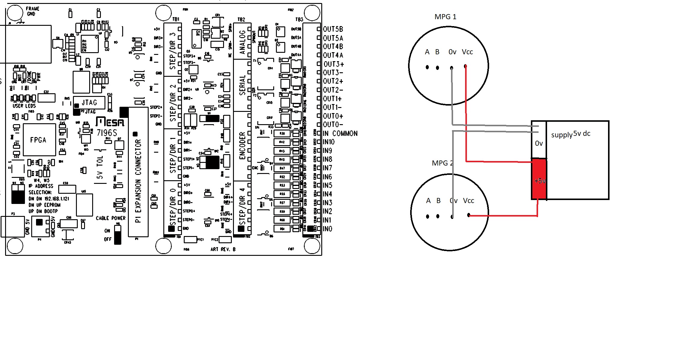

wiring MPGs to 7i96s
- Masiwood123
- Posts: 423
- Thank you received: 93
26 Sep 2022 12:57 - 26 Sep 2022 13:03 #252760
by Masiwood123
wiring MPGs to 7i96s was created by Masiwood123
Last edit: 26 Sep 2022 13:03 by Masiwood123.

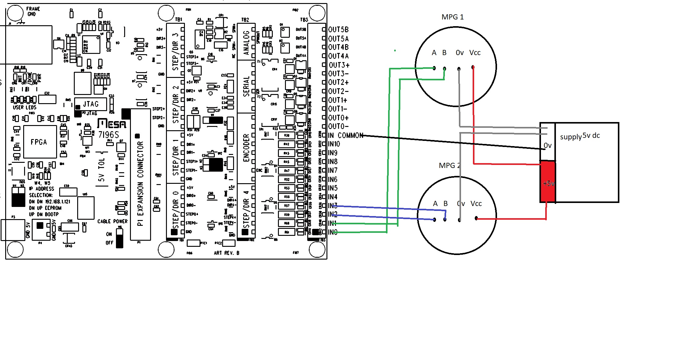

- Posts: 18004
- Thank you received: 5289
26 Sep 2022 14:40 #252769
Replied by PCW on topic wiring MPGs to 7i96s
MPG1-A 7I96S IN0
MPG1-B 7I96S IN1
MPG2-A 7I96S IN2
MPG2-B 7I96S IN3
GND 7I96 IN COMMON
This does mean the other 7I96S inputs are sinking inputs
(pull high to activate)
MPG1-B 7I96S IN1
MPG2-A 7I96S IN2
MPG2-B 7I96S IN3
GND 7I96 IN COMMON

26 Sep 2022 18:47 #252795
by Masiwood123
something like this
Replied by Masiwood123 on topic wiring MPGs to 7i96s
something like this
