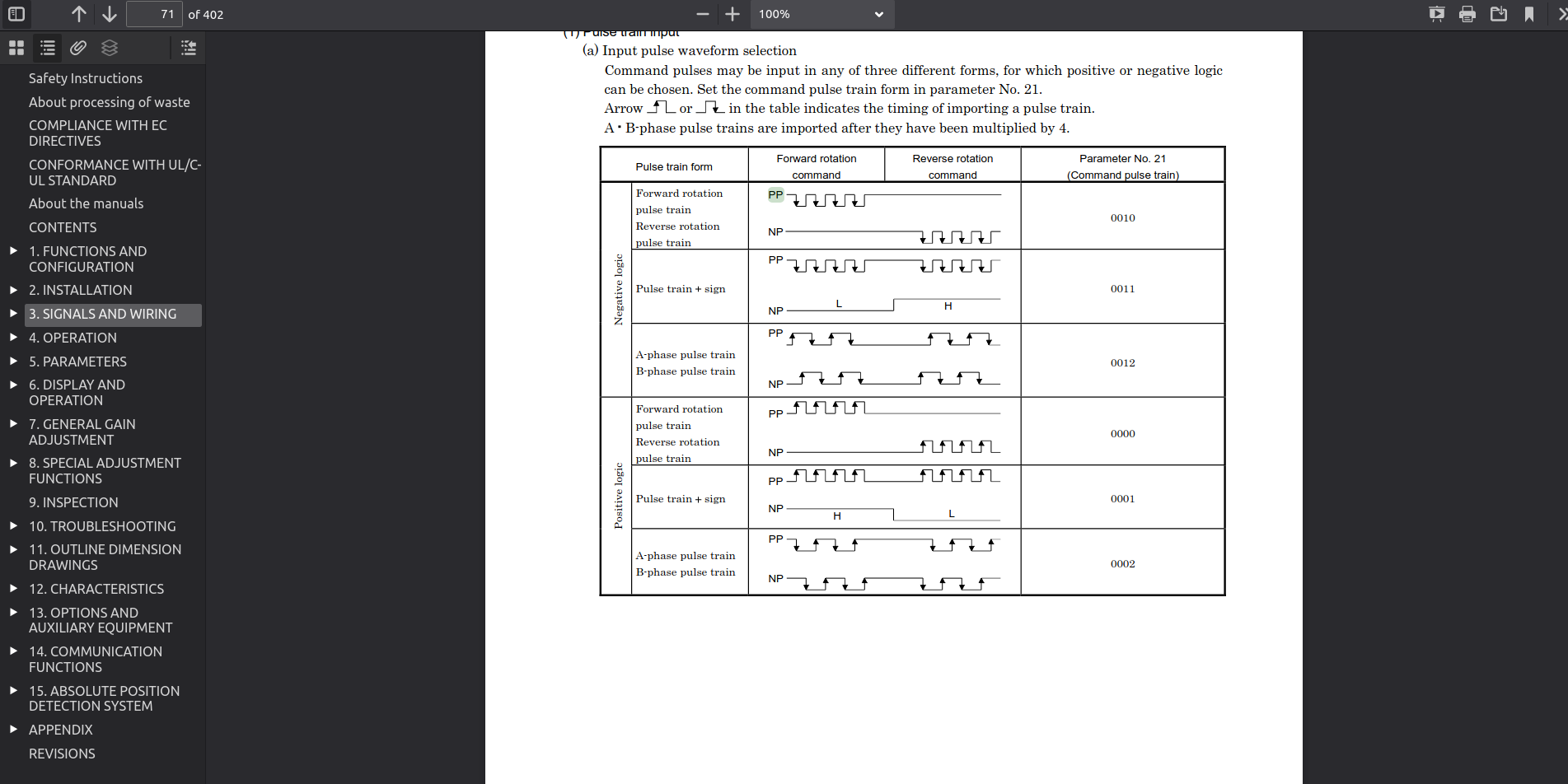

I am using servo motors via VFD for my 7i76e. The VFD has inputs Forward pulse and reverse pulse instead of step/dir pins. How should i go about it? Can I configure it somehow?
The VFD being used is MR-J2S-A

Edit the hal file, the line with:
loadrt stepgen step_type= 0,0,0
to
loadrt stepgen step_type= 1,1,1
linuxcnc.org/docs/2.8/html/man/man9/stepgen.9.html
to

Also note that those drives can be set to accept Step/Direction signals by setting Parameter 21 accordingly.
dl.mitsubishielectric.com/dl/fa/document...030006/sh030006j.pdf
