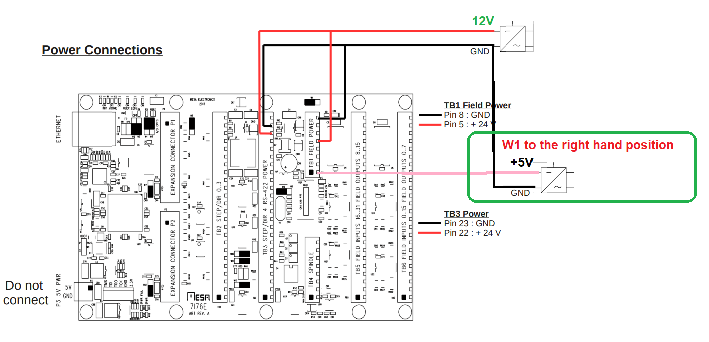

Allso I'm planning to use 5V field power, so am I right with this schema.
BR: Karri

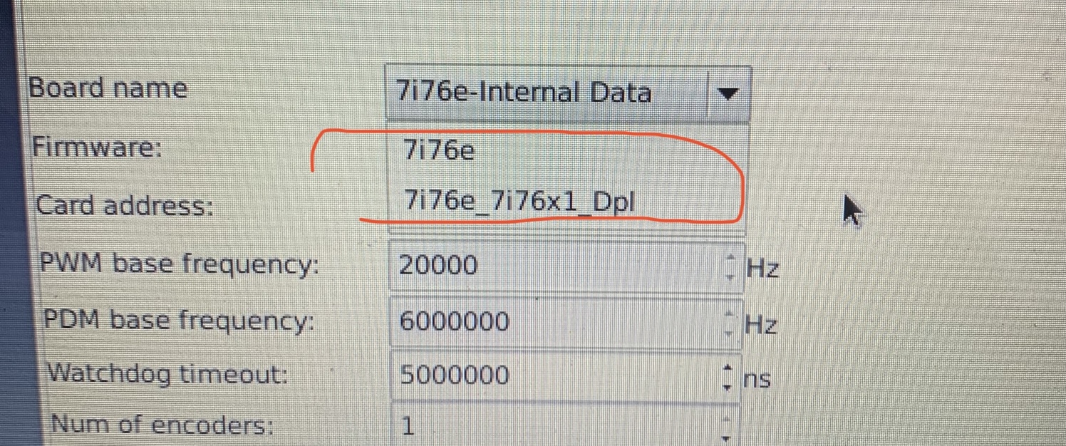

05 Oct 2022 09:33 #253512
Replied by tommylight on topic Hat spinning with 7i76E
The first one is for normal use, the second should be for plasma.
The only difference should be the first uses a normal A/B/I spindle encoder while the second has 3 A chanels for 3 of THCAD
