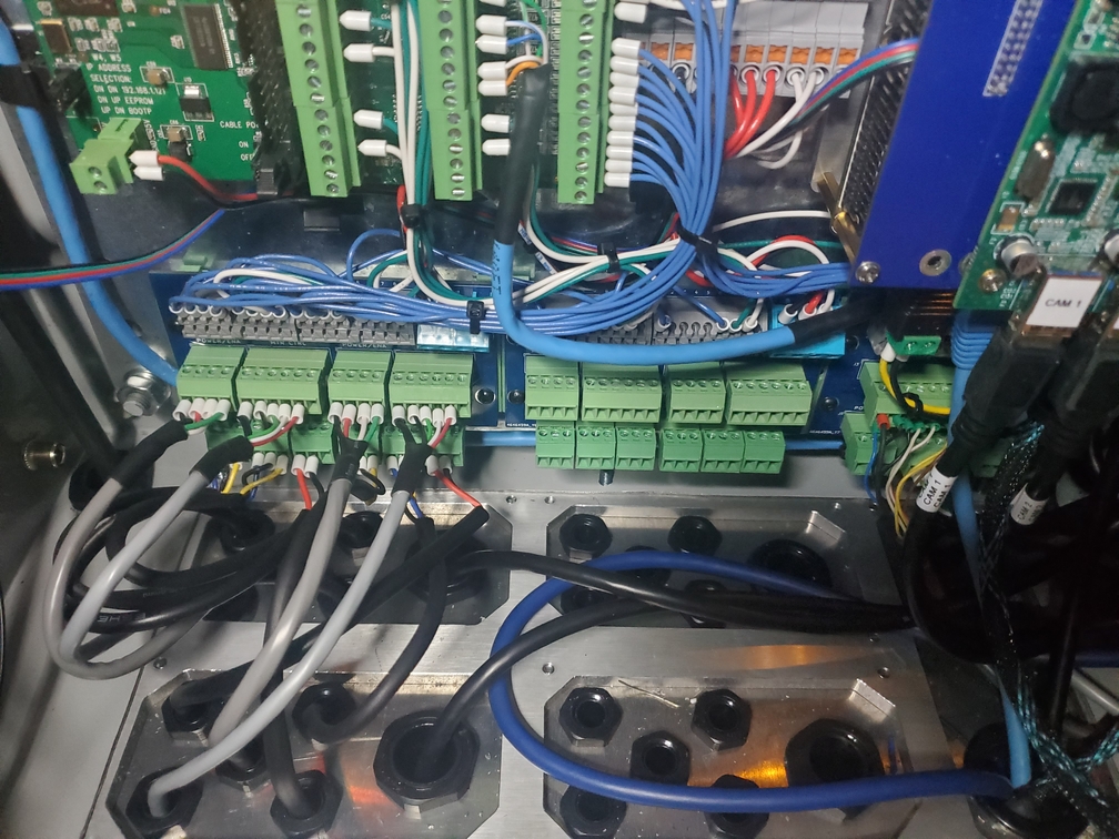

08 Oct 2022 19:33 #253771 by blazini36
Replied by blazini36 on topic Mesa and Efinix FPGAs
Yes, plus some other updates:
The new output drivers will be push pull so can be sourcing,
sinking or both ( software selectable and not need flyback diodes
regardless of load)
Input thresholds will be settable or auto.
I suppose that means they can me sinking, mixed voltage outputs? That's 90% of the reason I use a 7i96 for this application.
I suggest sticking with the same form factor for a 7i76e and keep the screw TBs.
I make these Terminal block PCBs for convenient wiring. The grey blocks on top are spring. There's nothing wrong with them except as pointed out you can't probe them as easily as a screw. They're nice where the TB is not pluggable because they are easier to get to but there's no point if the terminal block is pluggable. I used them here because too many pluggable connections in series can be problematic.
