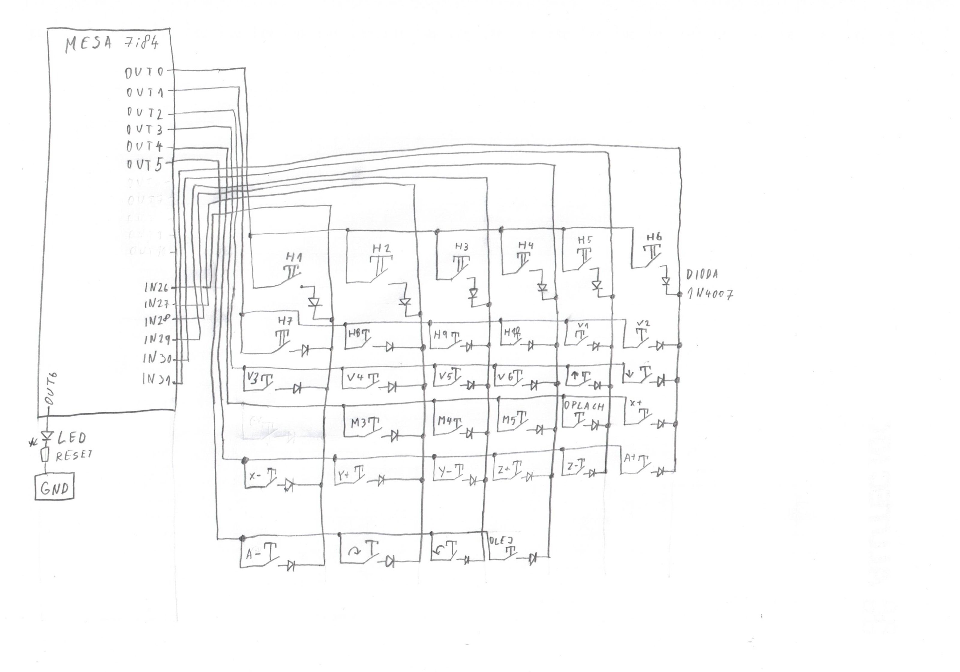

7i84 - matrix keypad possible?

25 Aug 2023 12:40 #278928
Replied by andypugh on topic 7i84 - matrix keypad possible?
The matrix looks OK to me. I did check the manual, and you seem to have the diodes pointing the right way:
Inputs are sinking type. That is they sense positive input
voltages relative to field ground.
