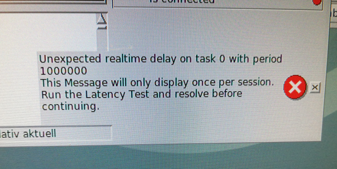

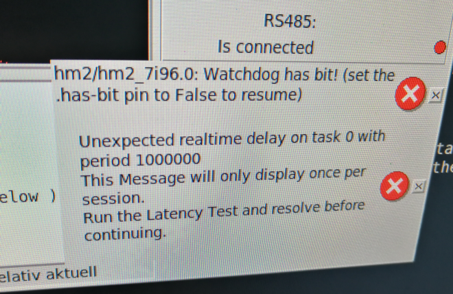

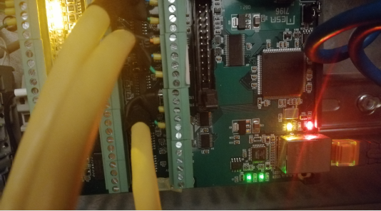

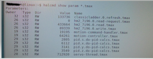

Hello, after fixing my ethernet connection to the mesa board I'm facing a new problem. In the past I never get these problems with my linuxcnc configuration with my pc system. This is my normal working procedure. Starting the system which powers up my mesa board and everyting boots up correct and all led's behave as expected. After turning LinuxCNC on and running it for a while (no jogging, no jobs ect) linuxcnc and the hole linux system freezes. Mouse and keypad also dont work at all. Also the red led CR11 /Init turns on. The manual says that CR11 is also used to signal HostMot2 watchdog bite when LinuxCNC exits, but here it's freezing. The whole system freezes only when LinuxCNC is running for a while.
As mentioned in other threads here are the tmax values and the cpu clock frequency if there is something strange?

Yes, a red /INIT light is signalling a watchdog bite.
This is probably secondary to the HOST PC crashing, and
subsequent loss of communications. Simple losing
communications with the 7I96 will not cause the host PC
to crash.
The PC crashing sounds like a hardware issue.

Since you say you checked the memory, check the processor for heat. Removing the CPU cooler and repasting it can sometimes fix this.
Next is the power supply.

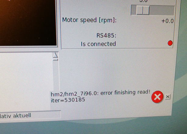

So I had the time to setup linuxcnc with the live cd on a second pc.
Same results here, the /Init led turns red signaling the watchdog bite. Also I get the folowing errors. The difference is that I the whole system don't freeze like on the other pc system.Keyboard mouse and linuxcnc app works fine expect from that the cnc cant move, no jogging possible. The other pc freezes even when linuxcnc is not started ,so another pc problem.

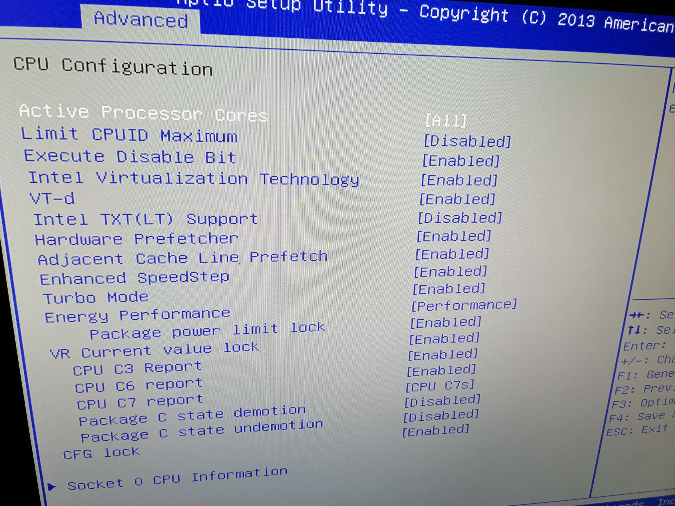

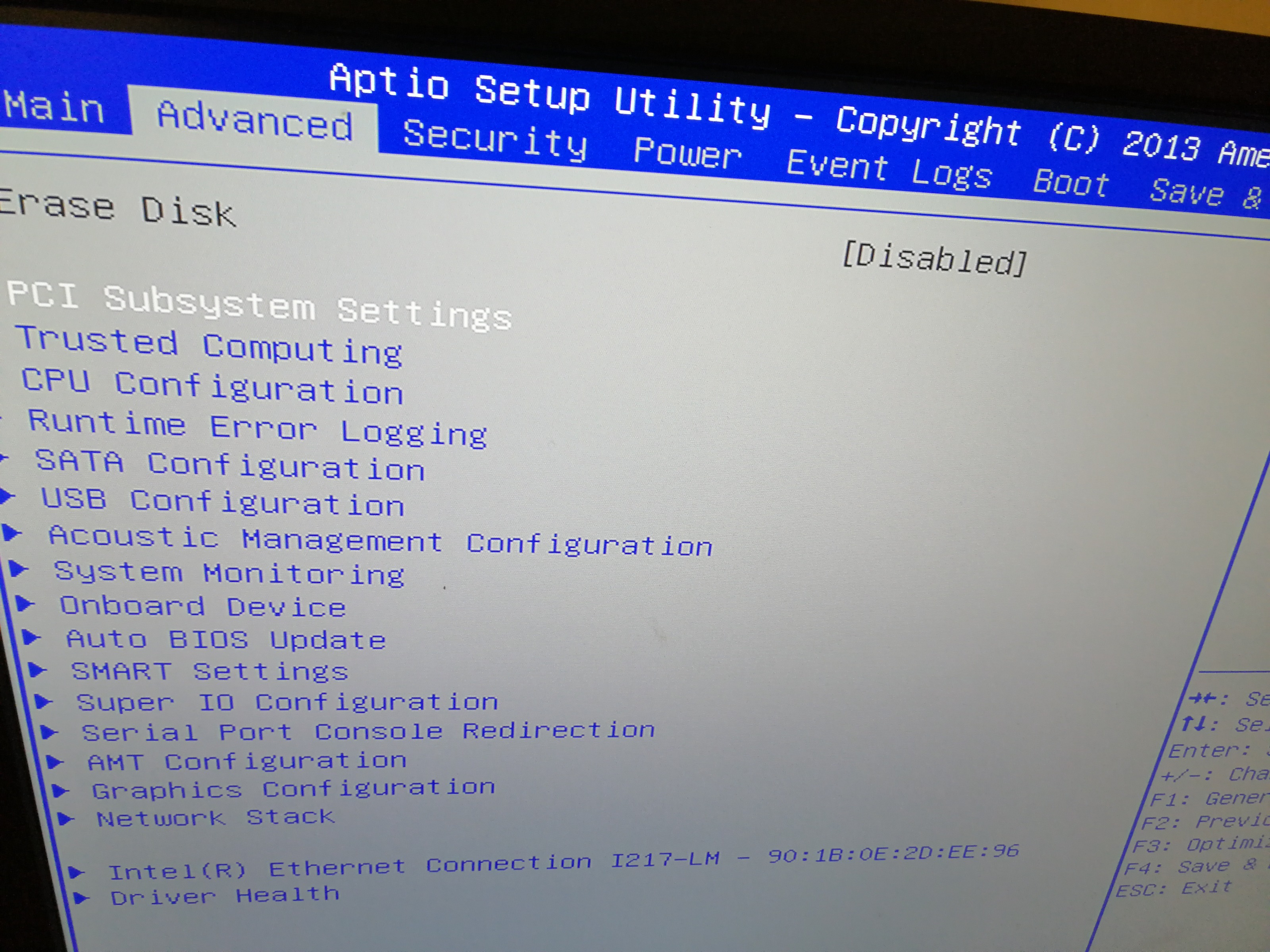

-Disable hyperthreading in BIOS, disable power saving features, C states, etc.
-Test again.
You already have everything working and Mesa board communicating properly, just the latency is causing the link between them to fail.
If you need help with BIOS settings, just take some pictures and post them here.
Replied by tommylight on topic Mesa 7i96 LinuxCNC freeze /Init Led lights up after some time
No, it is not a driver board issue, not yet. It is a PC issue, so:PS: @tommylight can you move back to the old topic (Mesa driver board) because its a mesa driver board issue? So more people can help me which maybe had the same issue
-Test again.

At the minimum, disable Intel Virtualization Technology, VT-d, Enhanced SpeedStep, and Turbo Mode.
