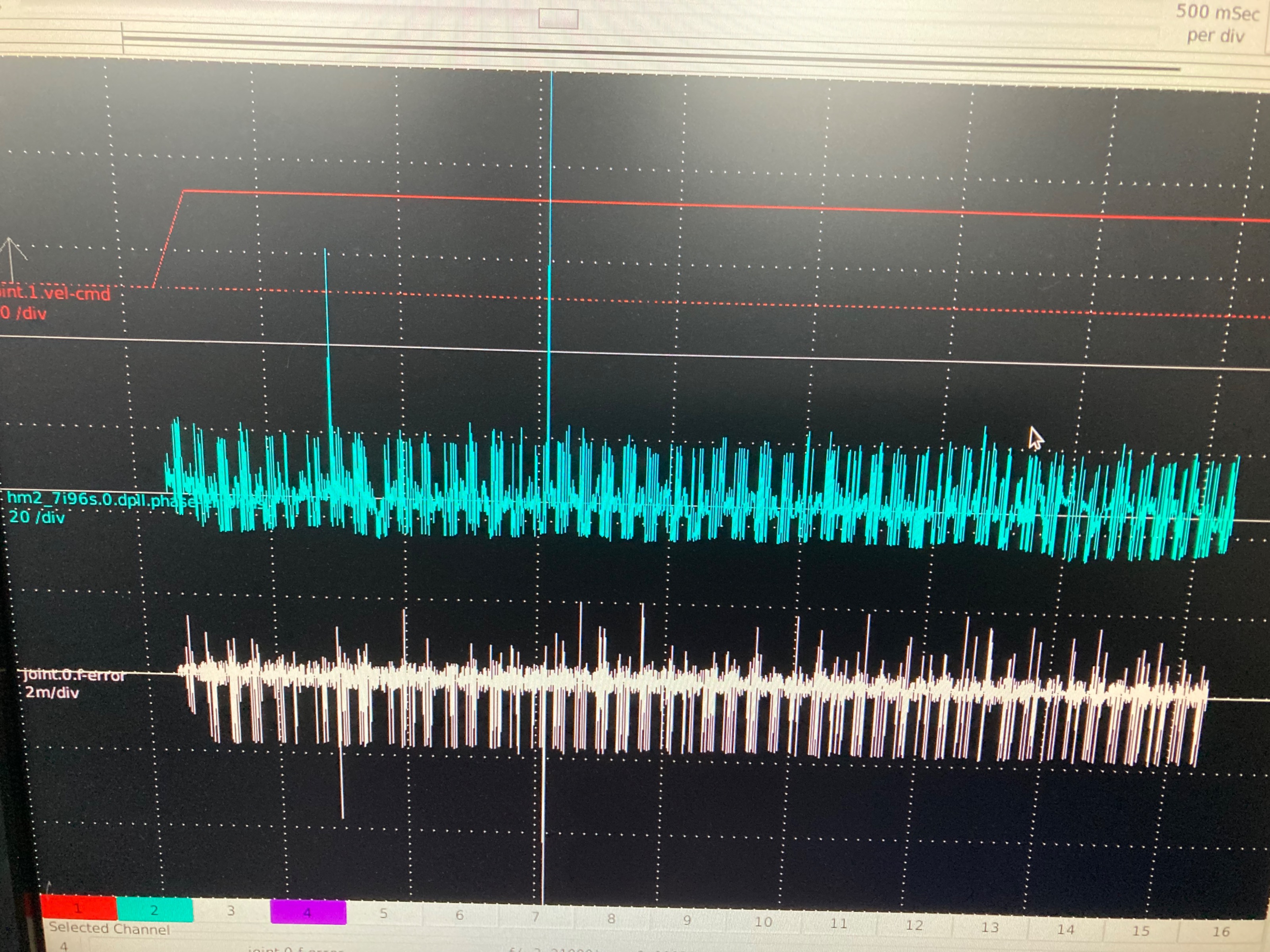

30 Nov 2022 00:49 #258059
by An
Replied by An on topic Mesa 7i96s a little jitter
Yeah it still works - il figure the multiple network manager applet opening later. I tried adding the static ip etc from the other tutorial and that rendered things dead so am back to where I started but with the improved ping response. Attached scope is of things now - some large spikes which is disappointing… any thoughts?

After reading some more I’m wondering if I should have or whether I do have the dpll timer enabled. Could this explain the spikes I’m seeing in the dpll phase error?
- Posts: 18103
- Thank you received: 5326
30 Nov 2022 14:38 #258126
Replied by PCW on topic Mesa 7i96s a little jitter
The big spikes are expected (those are from host latency)
To get an idea how bad they really are, you need to set the scale much larger
(say 200 per div or 0.2 ms per division)

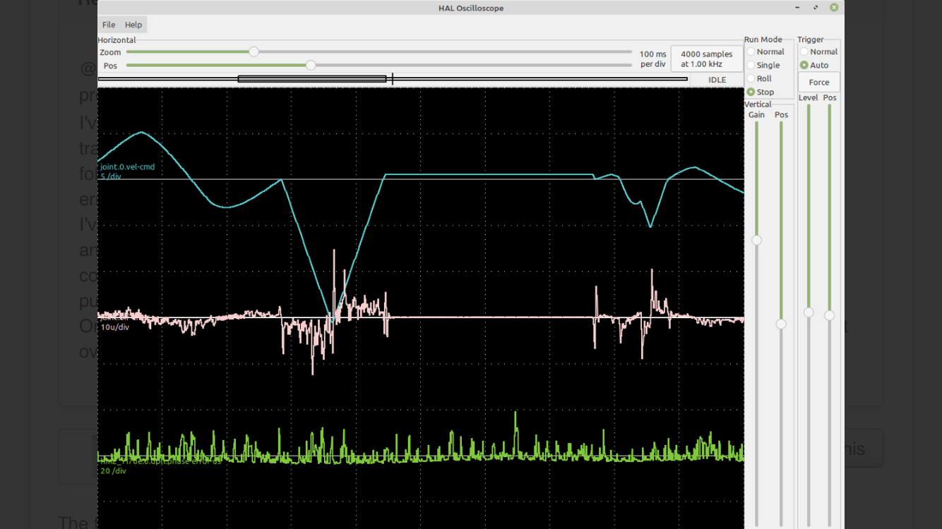

30 Nov 2022 17:34 #258147
by An
Ok thanks pcw I will do that. When I compare your scope plot (attached) from here forum.linuxcnc.org/38-general-linuxcnc-q...7i76e-solved?start=0
to mine (also attached) mine seems to have magnitude 10 worse joint follow error (after conversion to mm) and at least double the dpll phase error plus the spikes. Your joint follow error also appears to be zero at constant velocity where as mine is not. I’m trying to get it similar to yours as that’s what it should look like correct?
- Posts: 18103
30 Nov 2022 17:42 - 30 Nov 2022 17:43 #258148
Yes, it looks like you are not using the DPLL.
Can you post your hal/ini files?
