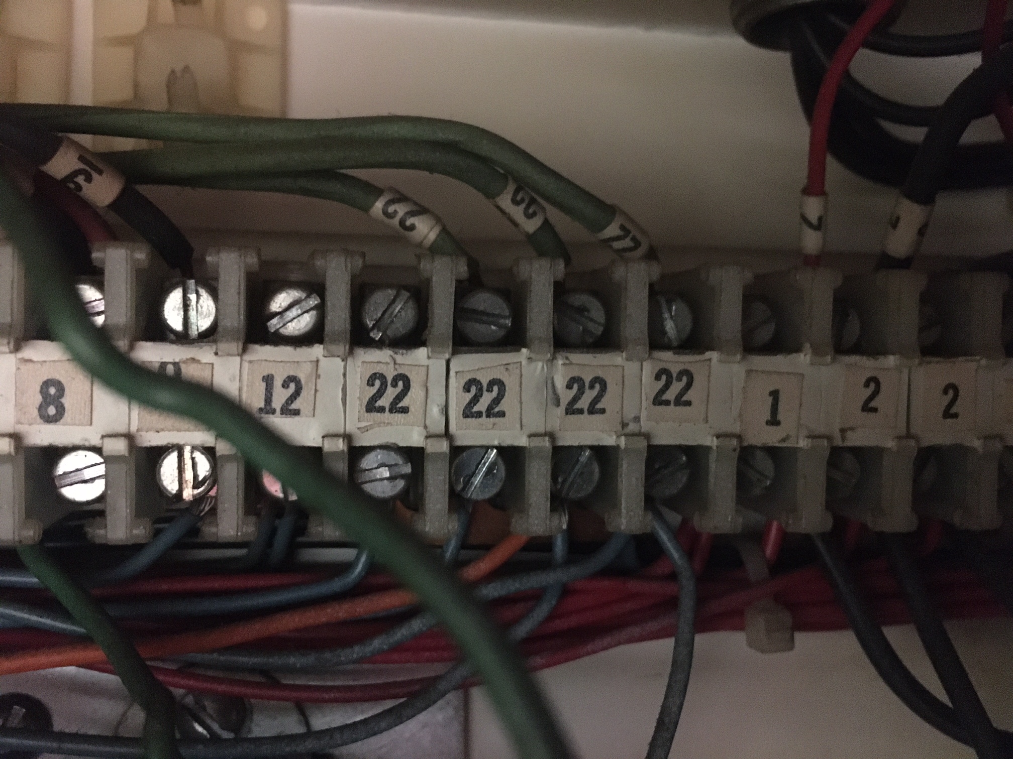

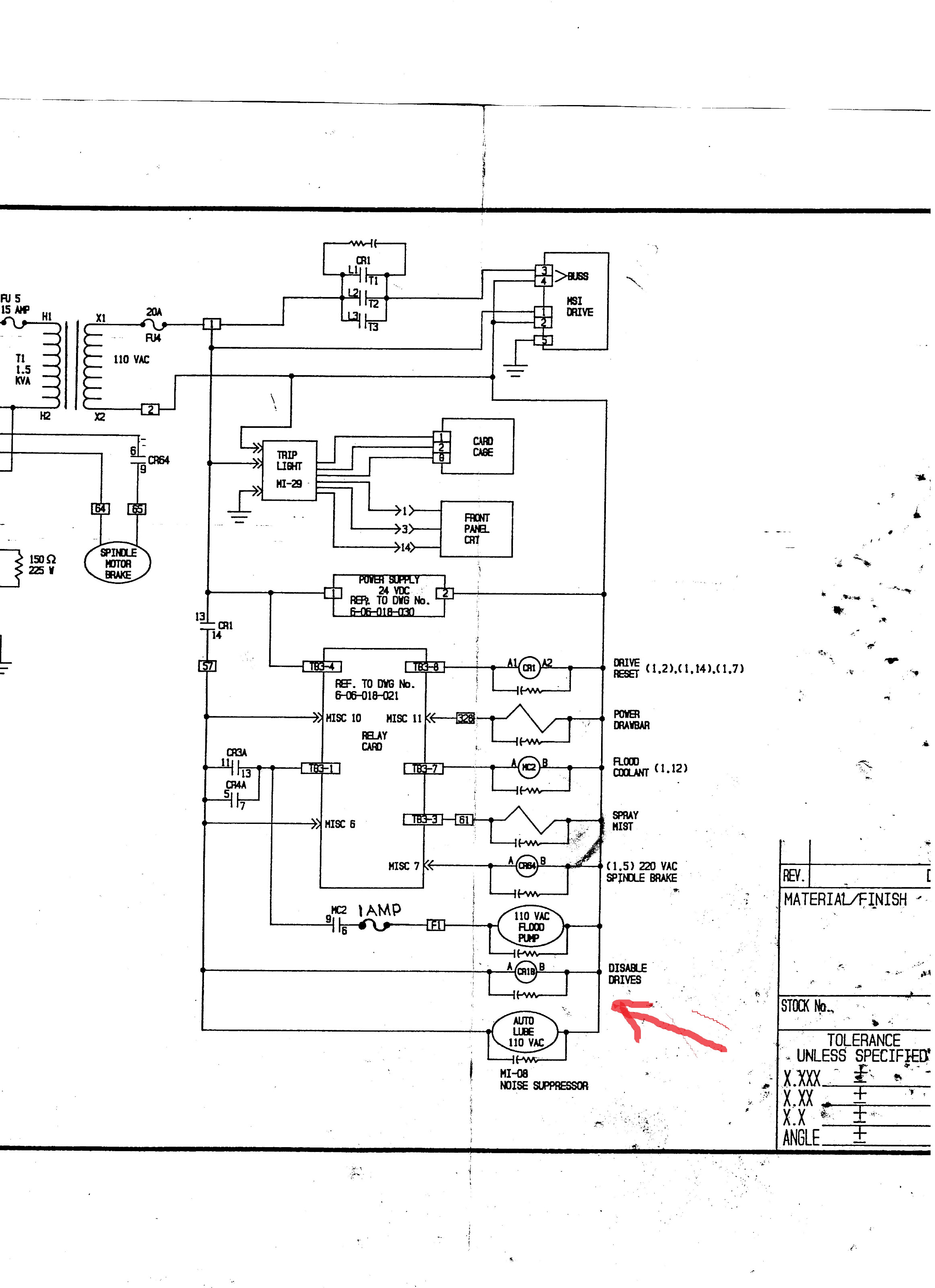

Only after having all of the above wired and tested and configured, wire a single drive:I would wire a 1Kohm resistor to all those pins on the Mesa side first and test, the first part of schematic you posted is very strange, 22 is still unknown.
And do not change drawings/schematics.

yes,
pin's to servo drive
2- sig
8- lockout
the CR1B is a normally closed relay that is connected to all the drives.
2- sig
8- lockout

Just a friendly warning, electronic do not have "i am sorry" buttons. You have to be sure what each and every wire does, how and where and to what it is wired, how it is controlled or what it controls, how it interacts with other electronics, etc, etc.
Replied by tommylight on topic Mesa 7I77 and Milltronics mill wiring
OK, but to what is the other side connected? From what is that relay controlled? Are all 22 pins connected together?

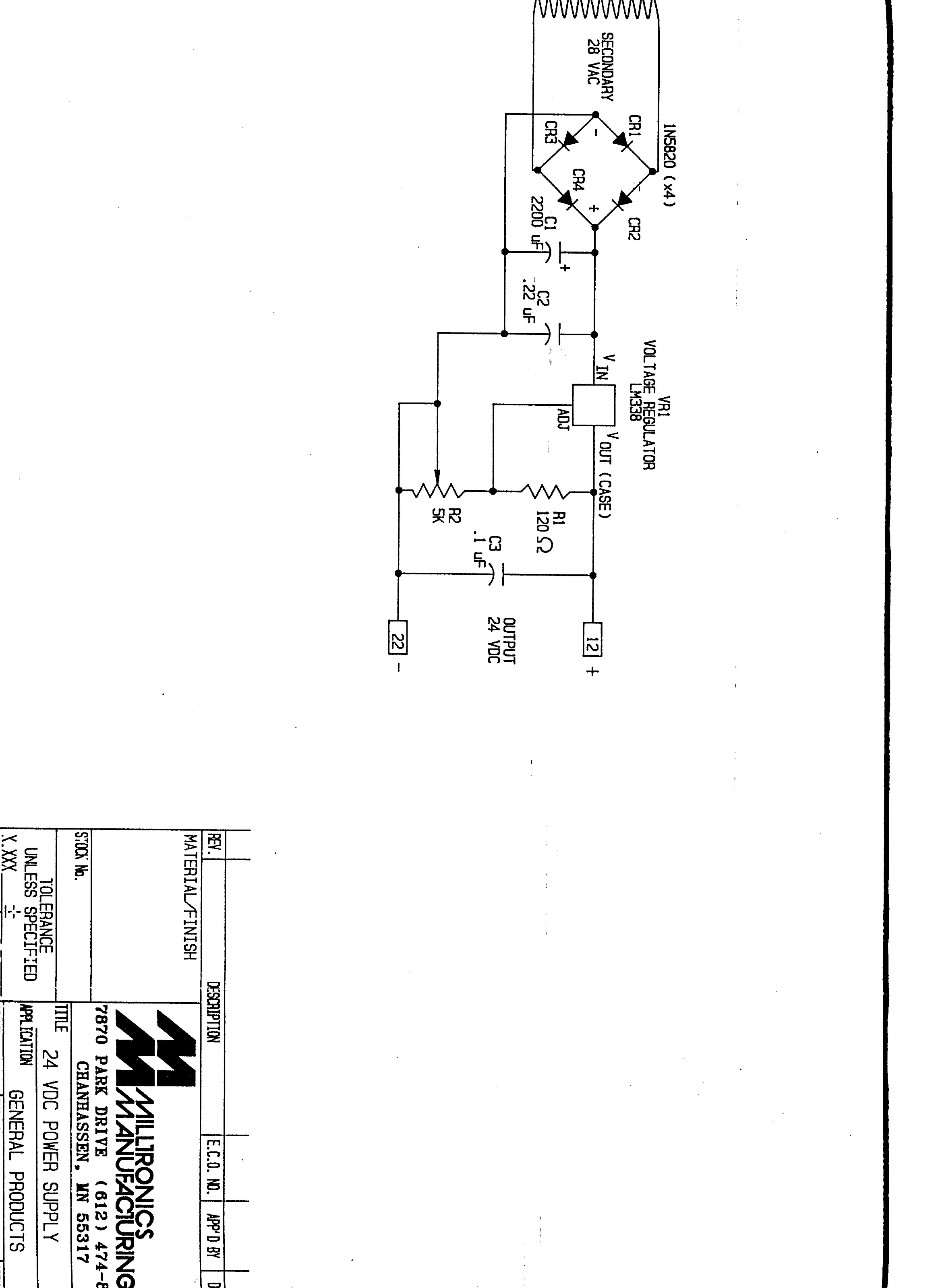

22 is 0V from 24v power supply?

OK, so that wiring should not be used anymore, just wiring the drives to Mesa should work.
See the link i posted on the procedure to wire and test.

24 volt power
