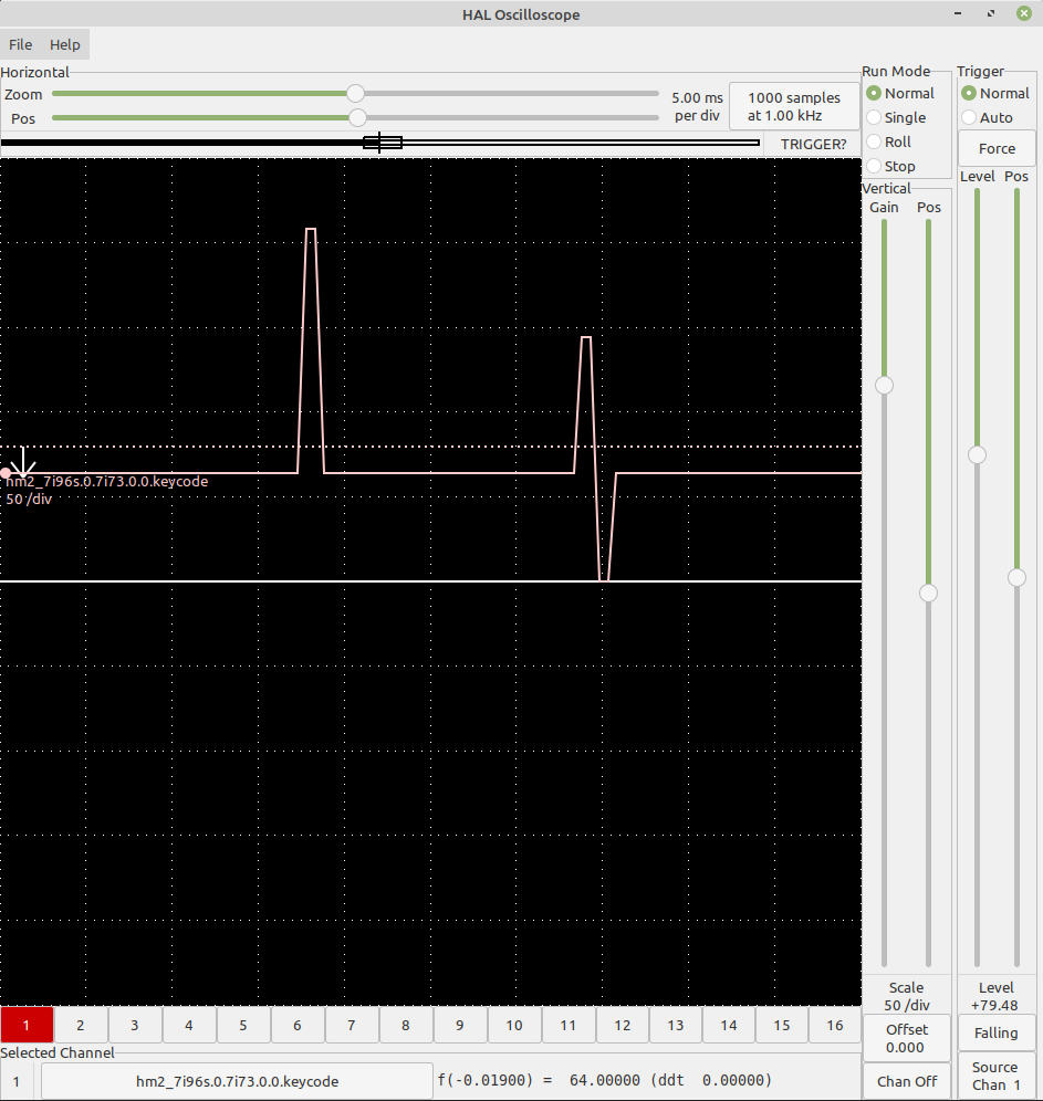

- Posts: 18100
- Thank you received: 5326
29 Dec 2022 18:50 #260507
Replied by PCW on topic 7i73 & matrix_kb - setup help needed
You might "halscope" the keycode as the changes only last one servo thread period

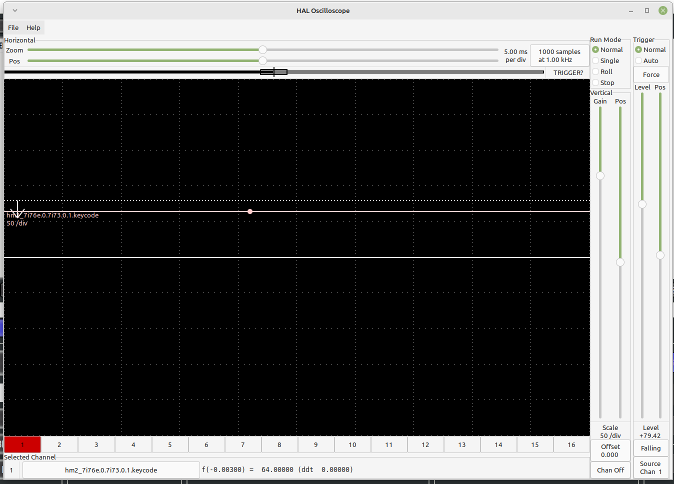

29 Dec 2022 22:15 #260512
by spumco
Replied by spumco on topic 7i73 & matrix_kb - setup help needed
There's no change to matrix.0.keycode or ...7i73.0.1.keycode in halscope.
- Posts: 18100
29 Dec 2022 23:41 #260519
Are you sure you have:
1. The correct jumpering for a 4x8 keypad
(W5,W6,W7 = DOWN.UP,UP)
2. You cycled power on the 7I73 after changing the jumpers
3. You are using the correct P1 pins (KEY4..7 are the row outputs for 4X8 mode and KEY8..18 are the column inputs)
I can see the change in the keycode just by setting the jumpers
and shorting P1 pins 9 and 11 (KEY6 and KEY8)

The number is different because My 7I73 is connected to the first (and only)
sserial chan (0) on a 7I96S, on a 7I76E, the expansion sserial channel is
channel 1. This only affects the pin/parameter names.
Is it possible you have the pins numbers wrong?
P1 pin 9 is the 5th pin from the top outer edge of P1 and pin 11 is
6th pin from the top outer edge of P1.

I doub it, but anything is possible at this point.
I'm using 40p & 34p ribbon cables to screw terminal breakout boards. The breakout terminals are numbered 1-40 and 1-34.
I'll pull the ribbons and start checking continuity between the 7i73 pins and the BOBs and make sure the screw terminals are correct.
