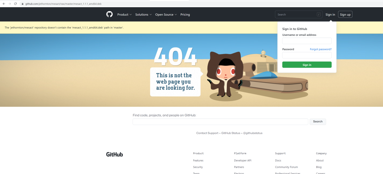

JT,
I tried both from the terminal command and trying the link and I'm getting a 404 error. Do you have a new link?
wget github.com/jethornton/mesact/raw/master/mesact_1.1.1_amd64.deb

Have a look there: github.com/jethornton/mesact/releasesJT,

Replied by JT on topic MESA 7i95 Board Setup
Yes, the debs are now in the releases to make the size of the repo smaller. Also I just did a major update so the version is 1.2.0 now.
github.com/jethornton/mesact/releases/do...sact_1.2.0_amd64.deb
