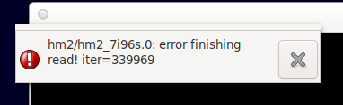

Error message during operation with a 7i96s

After starting LinuxCNC the same error occurs. Now iter=33970

29 Jan 2023 23:24 #263195
Replied by PCW on topic Error message during operation with a 7i96s
That error is caused by excessive Ethernet latency

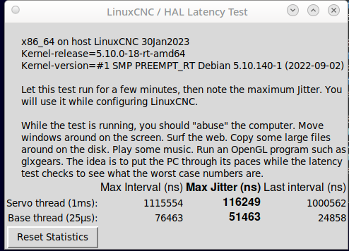

30 Jan 2023 14:27 #263236
by CADdy
Replied by CADdy on topic Error message during operation with a 7i96s
uname -a:
Linux LinuxCNC 5.10.0-18-rt-amd64 #1 SMP PREEMPT_RT Debian 5.10.140-1 (2022-09-02) x86_64 GNU/Linux

and latency test:
Are these values too bad? How could I improve it?
