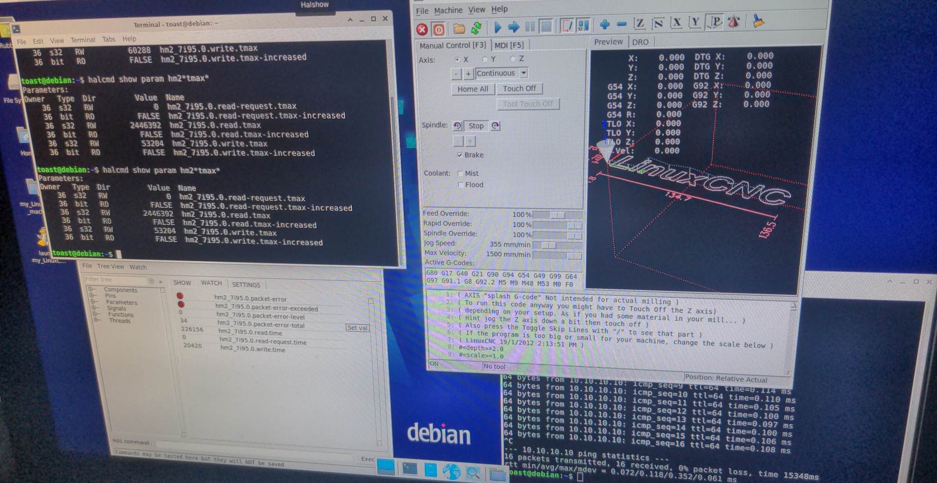

@Rod: I got up extra - LCNC has been running for 10.5 hours now and is "milling" away. No problem so far.
@PCW: We had already discussed and improved here: forum.linuxcnc.org/27-driver-boards/4809...7i96s?start=0#263250
Let me wait until morning. Thanks a lot!
Peter
Peter

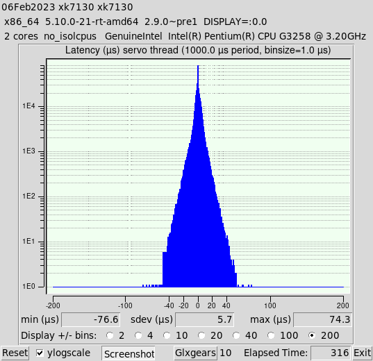

I also saw this error. the machine has proven itself for the last several years running lcnc 2.8 and probe basic py2 version with zero network or latency warning errors. i just updated to linux debian 11 bullseye and lcnc 2.9 and saw the read error the OP posted.
the system is:
ASRock H97M Pro4
G3258 pentium processor
16gb ram
LCNC 2.9
Debian 11 Bullseye
Linux 5.10.0-21-rt-amd64 kernel

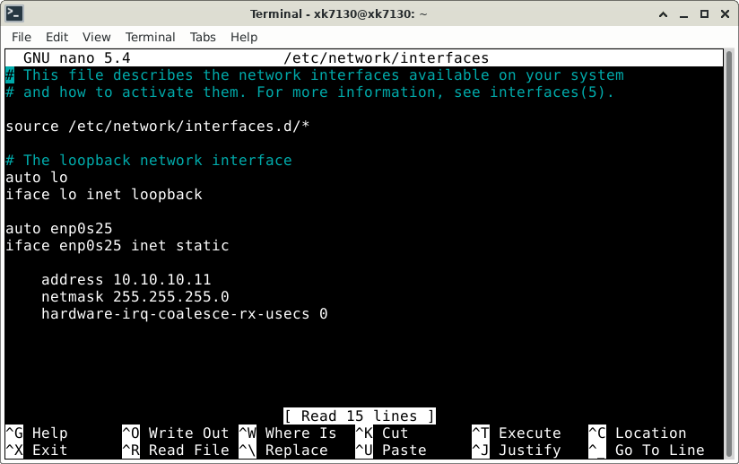

I did just go through and reset the network using the terminal to the following settings to see if it will help:
and i ran a latency test which isn't as good as the original on the older version.. results of the new latency test below:

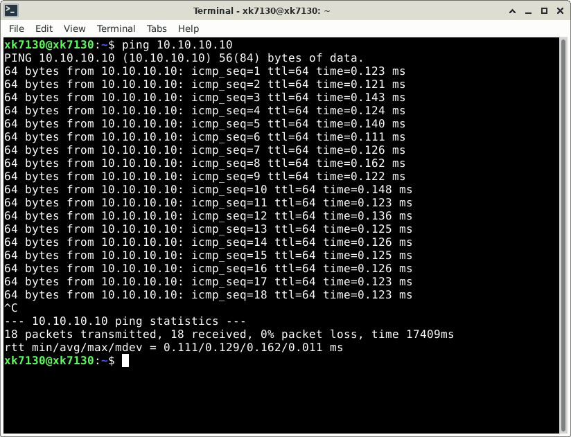

here is the ping results on this setup, I will report back if i encounter the error message again.
- Posts: 18103
- Thank you received: 5326
06 Feb 2023 23:11 #263876
Replied by PCW on topic Error message during operation with a 7i96s
Unfortunately the 5.10 Debian RT kernel is really bad Ethernet latency wise
(latencies up to the ms region)
If nothing else helps you may need to upgrade to a 6.x kernel
