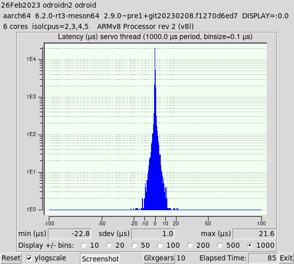

Its still a work in progress but we have been able to build a PREEMPT_RT kernel using Armbian for an
Odroid N2+
to try and get away from the error finishing read problem. This is a 6 core BIG.little CPU (2.4 Ghz and 2.0 Ghz respectively) so we are getting decent latency figues with isolcpus=2,3,4,5 (cores 4 & 5 are the little cores)
We are using kernel 6.2 and Debian Bookworm/Xfce and LInuxcnc 2.9 installed from the bookworm debs
Ping times are decent and even the first ping does not seem to be any slower
Today I finally got it talking to a Mesa 7i76e and noticed an odd error:
But when I look at the fault pin, there is no fault.
So the serial port error appears to be spurious and only happens on startup. Could this be a driver bug?
I also wonder if this could be caused by the load placed on the CPU when loading the QT5 based QTplasmac screen.
An explanation would be appreciated.

The "DoIt not cleared" error does indicate a real time issue.
It means the last (write) transaction from the previous thread
did not complete before the next thread started.
In my experience the long communication delays
are mostly related to intensive video operations
or saturated CPUs.
or saturated CPUs.

I played around changing isolcpus and watched CPU load for each core in htop.
It seems the overhead from QT based GUI's sometimes saturate one RT CPU core briefly on startup.
One of the little RT cores sometimes goes to 100% utilisation briefly when opening QTplasmac.
Axis on the other hand only goes to 67% utilisation
Once QTplasmac opens, the CPU load on that core falls to a fairly constant 90-92%
But what I am observing, despite 3 cores being allocated to Real TIme with isolcpus, only one core is used by linuxcnc
I wonder if there is a way to put hm2-eth on a seperate thread on another core? That could be a sure fire way to fix error finishing read issues.
I might try adding another thread and see where it ends up.
Maybe as the world gets mor complex, we should have the ability to specify a core to run a thread on...
