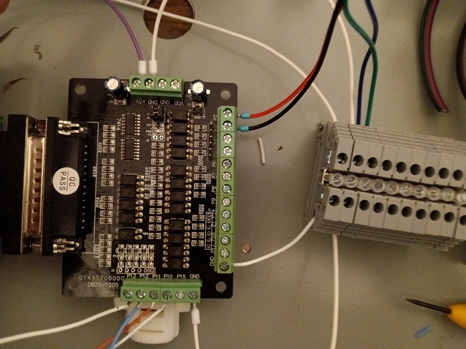

Well.....looks like I have one of those optoisolator ones which are blah....cant get it to work at all. Still feel like something might be wrong in the hal/ini files as it wont budge one bit.
Have another board, like the one listed above, arriving tomorrow...will give that a shot.
Included are the hal/ini files

In your ini file, from this
DIRSETUP = 10000
DIRHOLD = 10000
STEPLEN = 5000
STEPSPACE = 5000
to this
DIRSETUP = 20000
DIRHOLD = 20000
STEPLEN = 10000
STEPSPACE = 10000
That should barely work with that BOB, if not try both step at 15000
Edit,
Only for the joint/axis connected to that BOB, not for all axis
DIRSETUP = 10000
DIRHOLD = 10000
STEPLEN = 5000
STEPSPACE = 5000
to this
DIRSETUP = 20000
DIRHOLD = 20000
STEPLEN = 10000
STEPSPACE = 10000
Edit,

Yeh, the 1205 boards are Blah! Thats been discussed before. I just threw mine out this morning....Well.....looks like I have one of those optoisolator ones which are blah....

Regarding the opto interface:
There is a high speed variant available with a high-speed optocoupler (6N137).
www.aliexpress.com/item/4001090485636.html

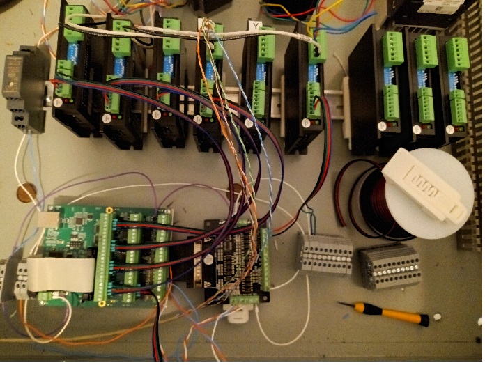

That was it..... Was able to get all 9 steppers moving with the 7i96s and the bob with the relay shown above .... The only thing is I can't seem to get the input working when it worked fine on the other card. Will double check things again and see what I goofed up.
