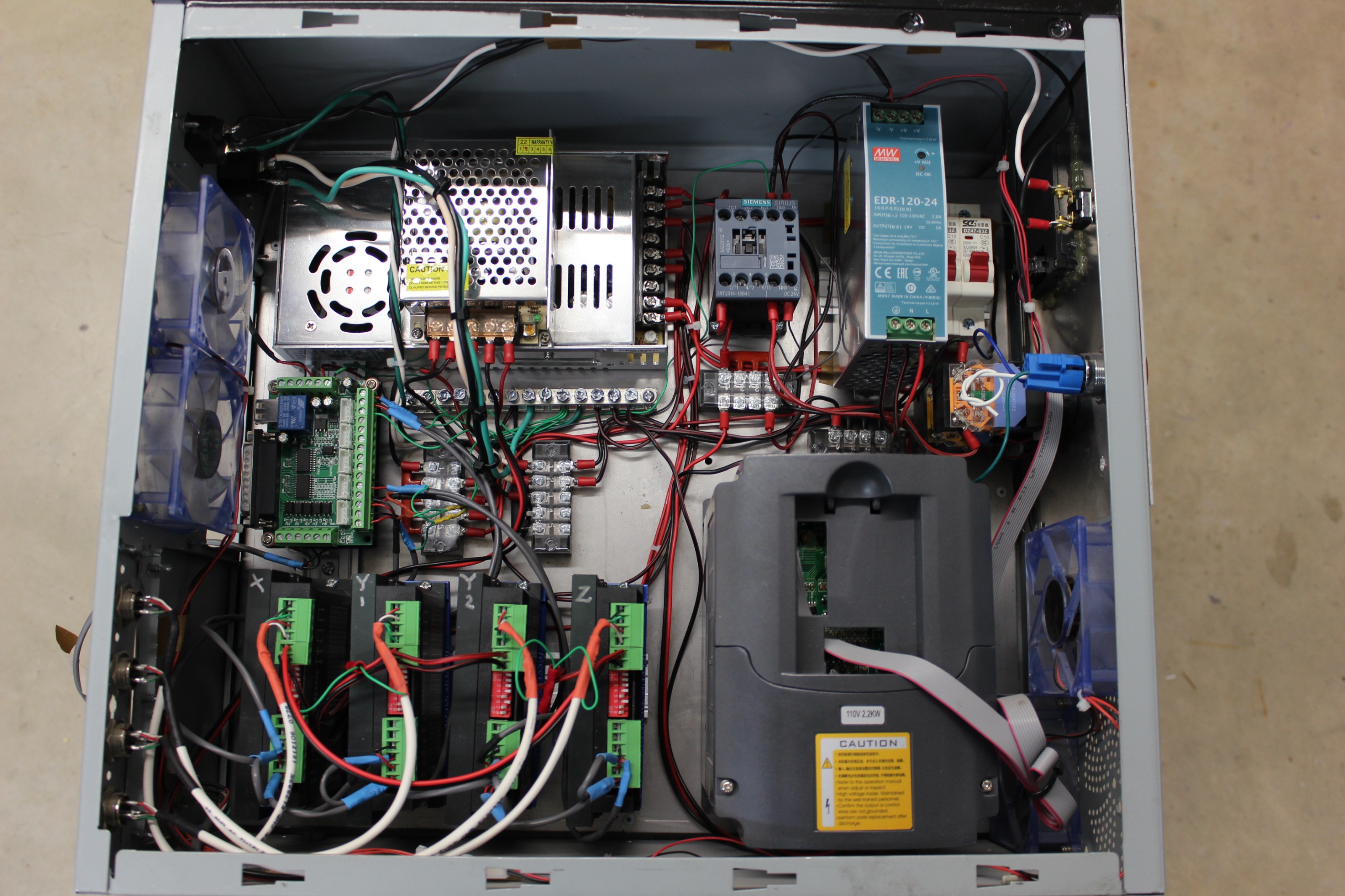

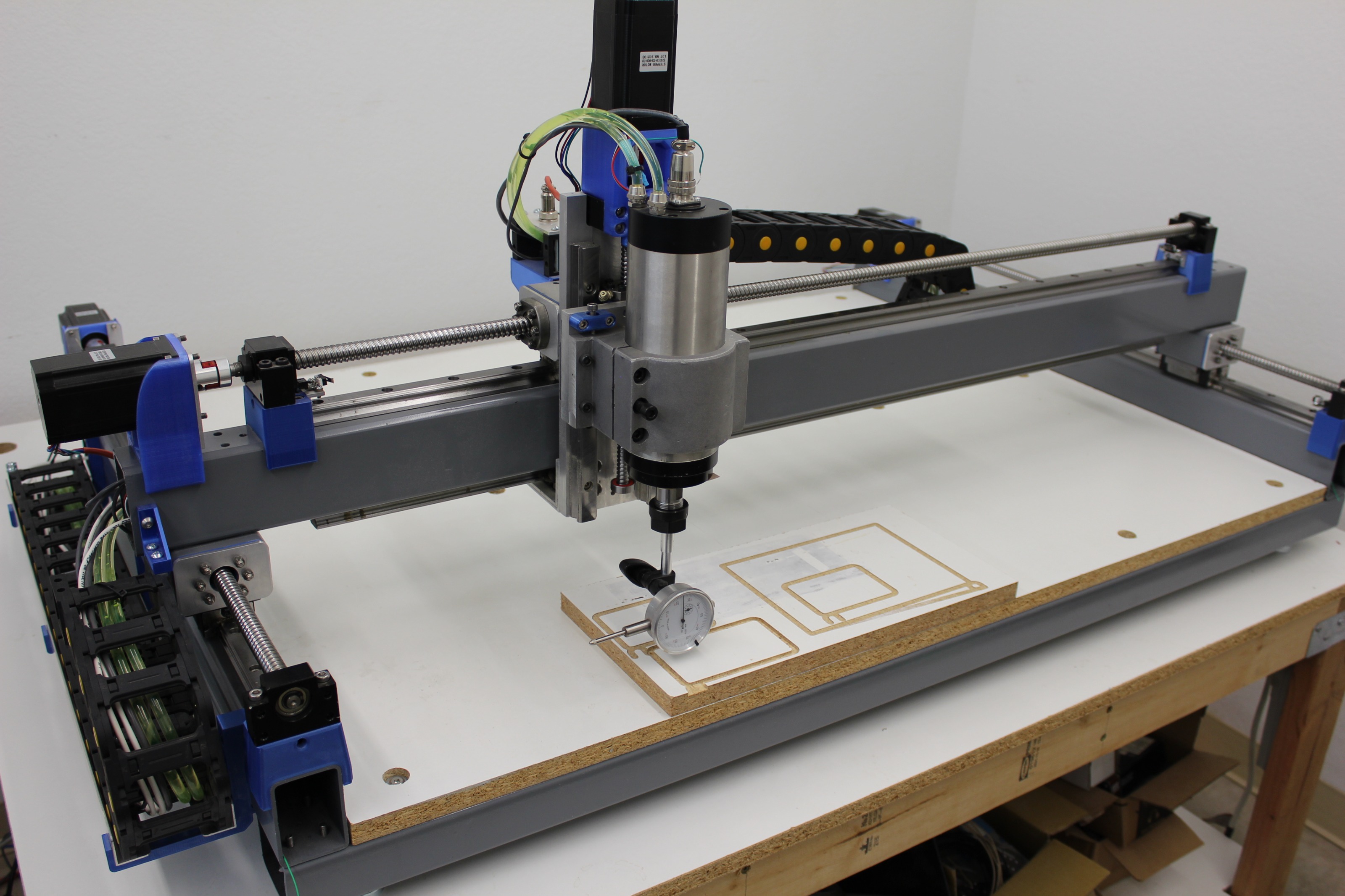

Hi
I am new to Linuxcnc. I have built a PrntNC CNC Router and I have it working but I have run into a problem.
When I am jogging the machine in some spots it will continue to move slowly but the DRO's don't. When I was checking the movement with my indicator whenever I would come to a certain spot it would continue to move.
When I was using Mach3 I didn't have this problem.
I'm thinking it may be the 5i25 Mesa card because I got another BOB and it did the same thing.
I have all the wires shielded to the BOB and the drivers.
Hope someone can help with problem.

Always interference issue on stepper systems.
3 prong power supply socket/plug
control box grounded
signal wires away from motor and power wires

Are you saying you get uncommanded motion at certain mechanical positions?
If so this sounds like a wiring/crosstalk issue.

Yes. I can repeat the action when I move it to the same spot and it will do it on all 3 axis.Like i said when I was using Mach3 with a USB BOB I didn't have this problem and I didn't have the wires to the drivers shielded.Here are some pictures of my wiring and machine.

Are you saying the motors move (drift) continuously in one direction at certain mechanical positions?
Can you post your hal and ini files?
Can you measure the voltage on the DIR lines to the step drives when jogging in either direction?
This does sound like an electrical noise or perhaps marginal electrical level issue

The answer to the first question is yes.
I measured the voltage on the X axis before I turn on the machine in Linuxcnc it is 5.1 volts
when I turn on the machine in Linuxcnc it drops to 2.6 volts. When I move it in a positive direction it goes back to 5.1 volts. When stopped it is 2.6 volts. When it drifts it is around 2.6 volts.
I connected a wire to the dir and the ground on the BOB to get the voltage.
